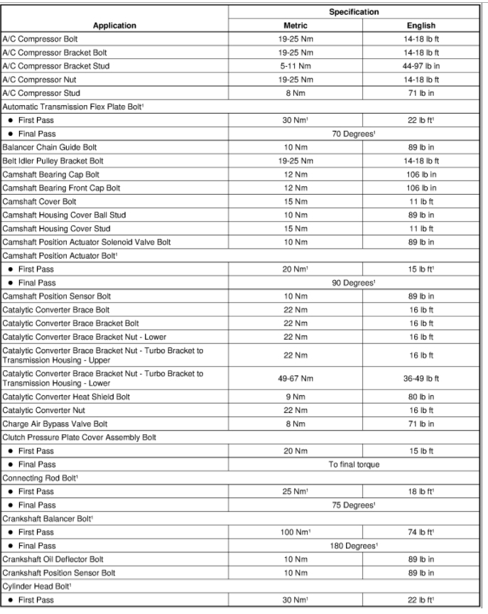

I need torque settings for mains and big ends bearings.

Here is the bolt tightening torque chart foe the whole car (below) and a video on how to use a torque wrench if you need it:
https://youtu.be/juOClONIWeY
Image (Click to enlarge)
