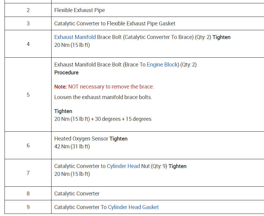

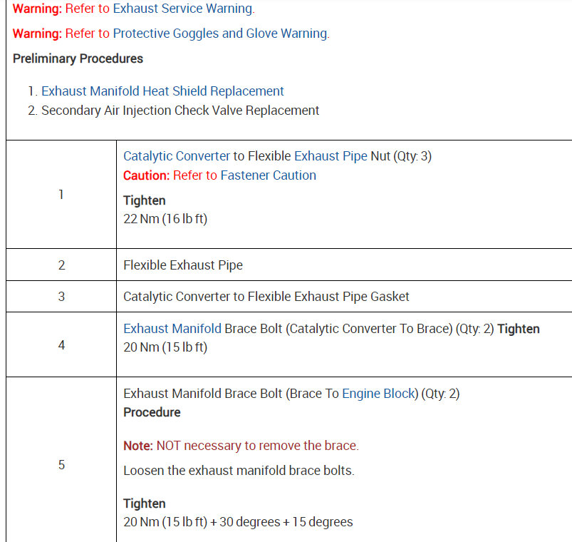

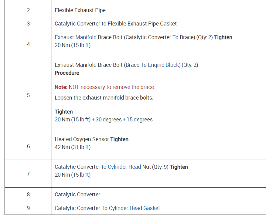

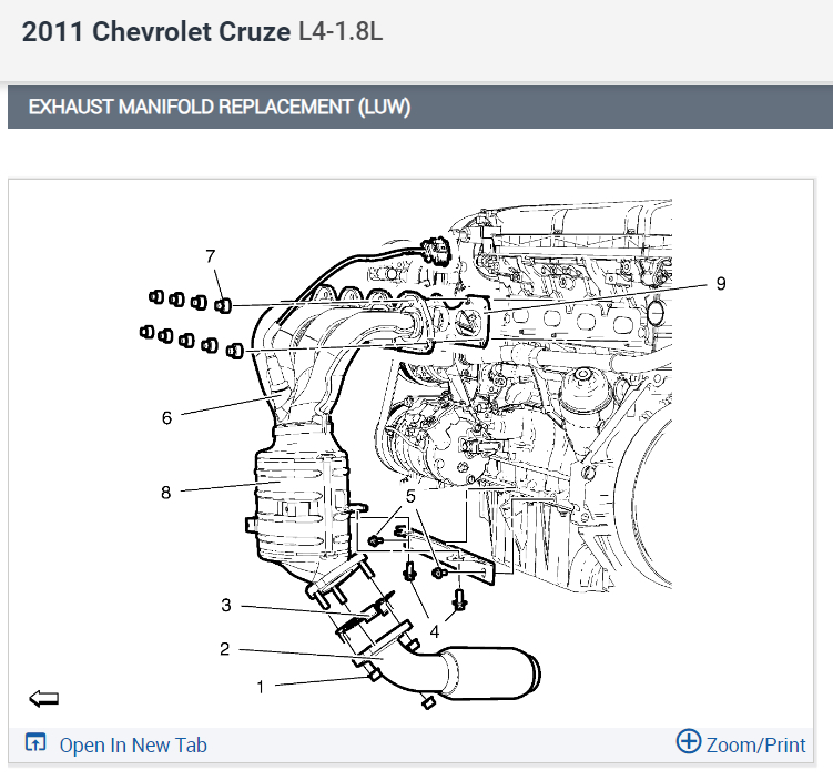

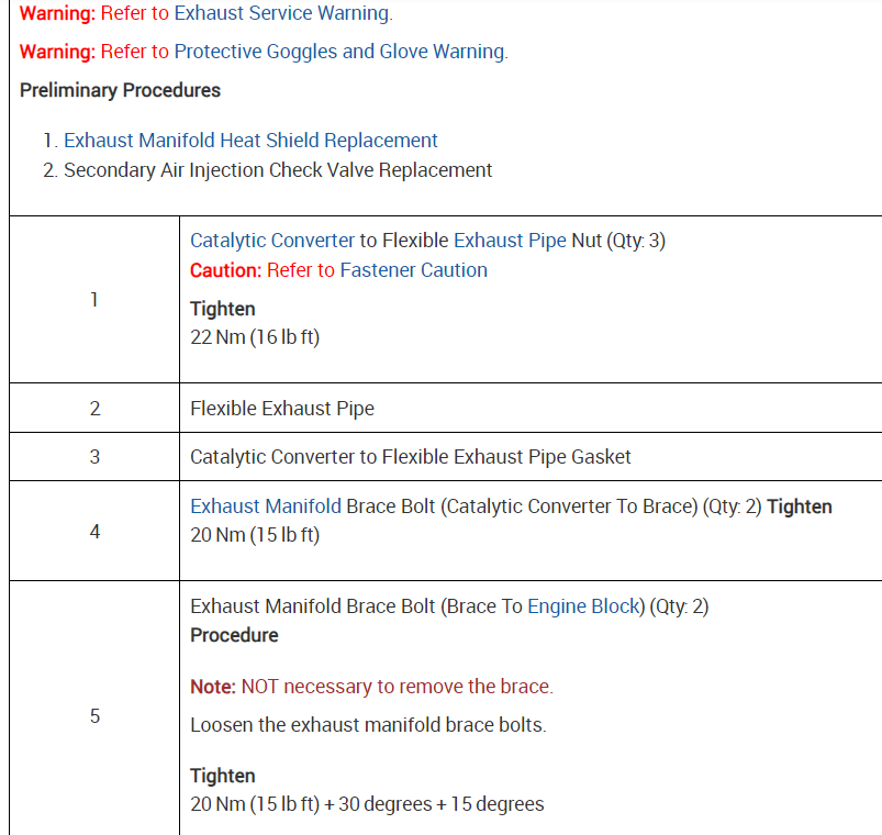

Need torque settings and sequence of tighten nuts for install of exhaust manifold and oil cooler part.

Sure, here are the instructions and the torque specs on how to replace and tighten the exhaust manifold. Be sure to clean the gasket surface thoroughly and I would use a little RTV to help seal the gasket. Check out the images (below). Let us know if you need anything else.
