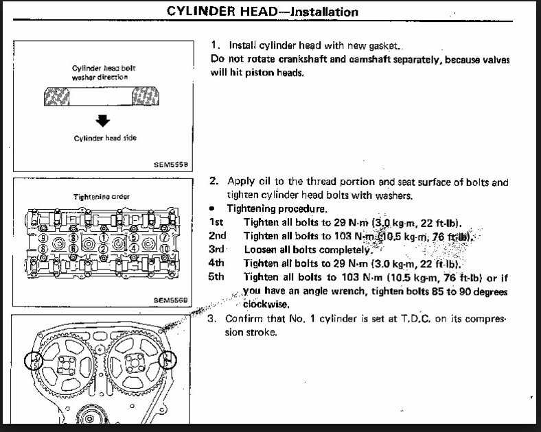

Head bolt torque setting.
May 22, 2017 at 9:26 PM
Experienced Mechanic
55,770 POSTS
Here is a guide on the head bolt torque setting and how you should tighten them.
Check out the images (below). Let us know if you need anything else.
