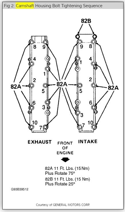

Can I get the Torque sequence for the camshaft casing?
140,000 MILES • 2.3L • 4 CYL • 2WD • AUTOMATIC
ZACK75
Need to know sequence of camshaft casing.

Okay, it should be easy. Your vehicle has 4 different engine configurations. Luckily, I checked all four of them and the information is the same. I am certain that this is what you are looking for, if not let me know.
Also, if you have any other questions, please do not hesitate to come back.

Thank you very much for your time. I was worried about warping the aluminum house the cam lives in!

You are very welcome, and I completely understand. Better to do it right the first time instead of being sorry you didn't later. Glad I could help you out. Come on back if you need anything.
