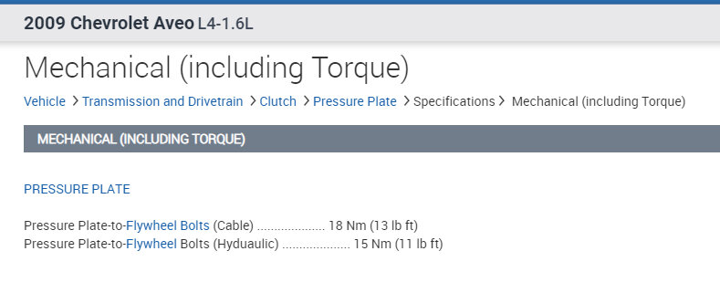

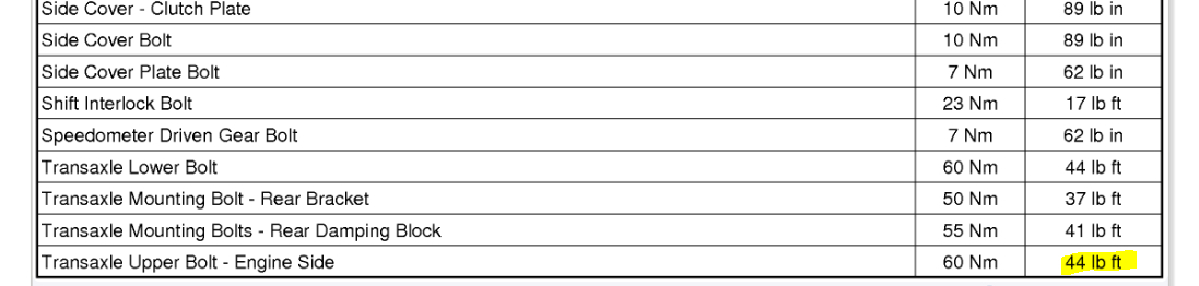

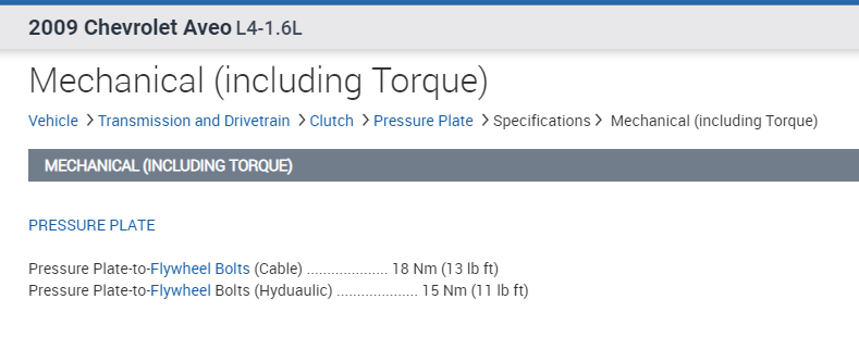

How much torque is applied to the plates presser bolts and bolts to put transmission and engine together?
2009 CHEVROLET AVEO
100,000 MILES • 0.6L • 4 CYL • 2WD • MANUAL
MMMMMTTTTT
I'm replacing my car's clutch. My question is, how much torque apply for plates presser bolts and bolts to put transmission and engine together?
Apr 27, 2023 at 4:05 AM
  • 110,244 POSTS
I attached what I could find in the manual. If you look at the pics below, they provide the torque specifications. As far as the trans to engine, I wouldn't be afraid to go to 50 to 55 ft/lbs.
Take a look and let me know if this helps.
