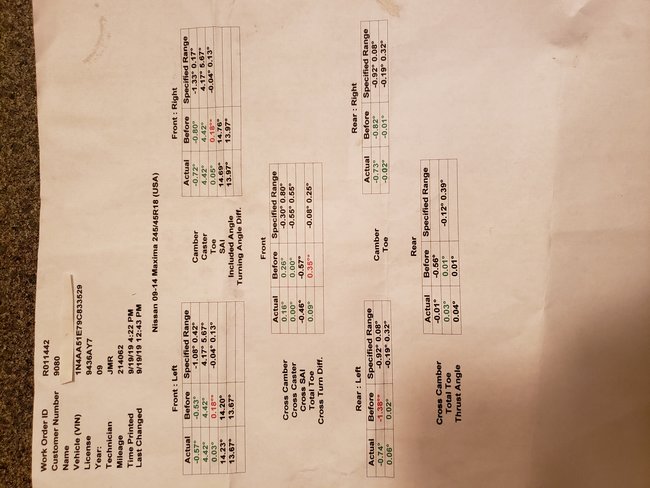

My tires were worn out bad on the front and the car pulling a lot to right. I had to drive real slow on roads that weren't paved good. So I got new tires and front end alignment. After they did it the guy told me I had a torque pull. He said it will be pulling slightly to right sum. Can you help me with what to do? I be driving along and it goes over to the right some. Seems like to the left a little at times to. Car listed above is the SV model.

I love Nissan Maxima's and I know that they have a lot of power to them as my best friend in high school mom's had one, rear wheel drive, that she would let him drive around. Very, very, very fun vehicle. Having said this I don't think that this is going to "torque pull". Did you get a printout of the alignment with your work order?

Yes , sent you a picture.

Well, your alignment is within the specs. that the vehicle manufacturer has set for your vehicle's alignment. I would recommend checking the air pressure in the tire in side of the vehicle that it is pulling too. Please check it and get back to us with what you are able to find out.

Hi, I got the problem fixed in December. I found out I had 2 motor mounts broken. One on top and other on bottom. So I got the top replaced. It seems whenever I pressed the gas the motor was raising up and making it pull to the right. So as of right now, its driving straight again.
