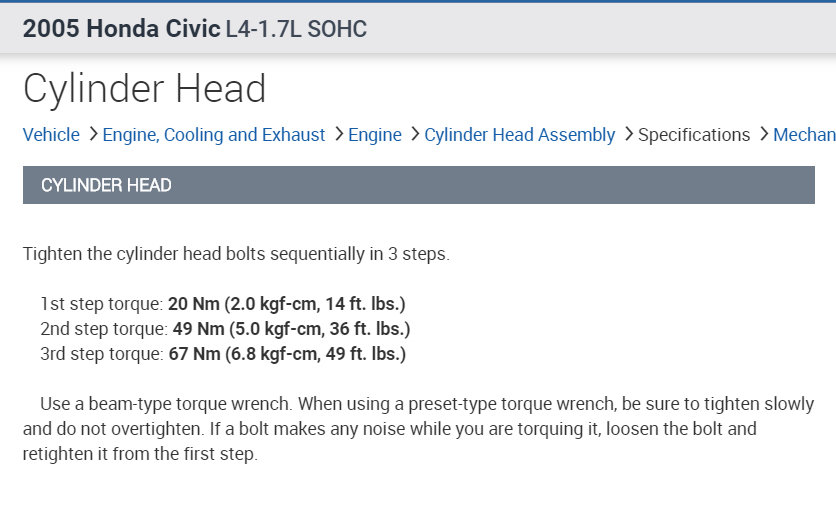

Torque head bolts
2005 HONDA CIVIC
335,000 MILES • 1.7L • 4 CYL
TWISTED79
Need torque head bolts on Civic engine # 56062609.
May 5, 2019 at 2:58 PM
SCGRANTURISMO
  • 4,897 POSTS

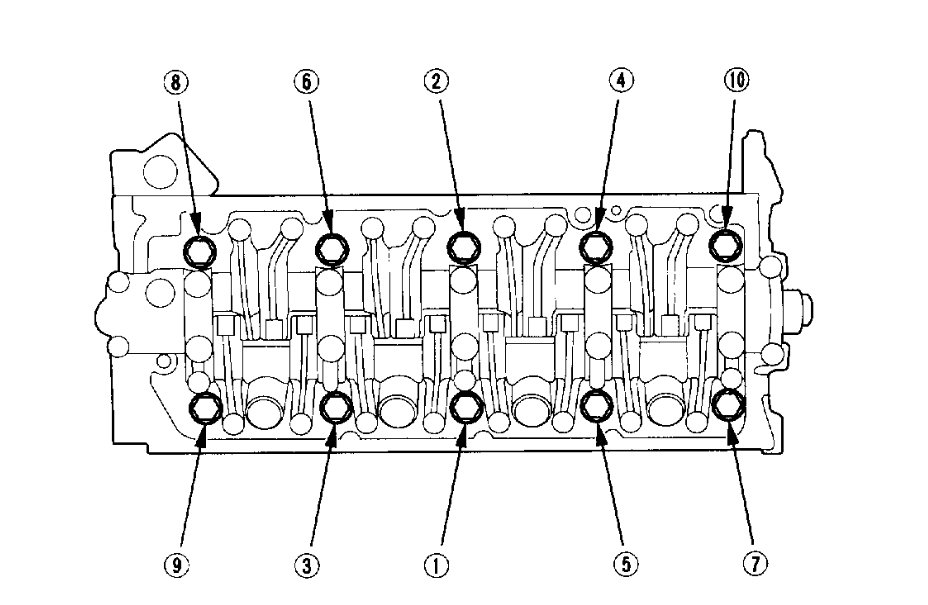

The information that you requested is in the diagrams down below. Please get back to us and let us know how it turns out. And, as always, should you have any other questions, please, feel free to ask. It is why we are here and it's what we do.
Thanks,
Alex
