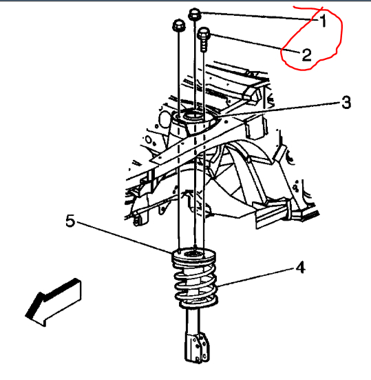

I need the torque for lower strut bolts.
May 23, 2020 at 9:59 AM
DANNY L
  • 5,648 POSTS
Hello, I'm Danny.

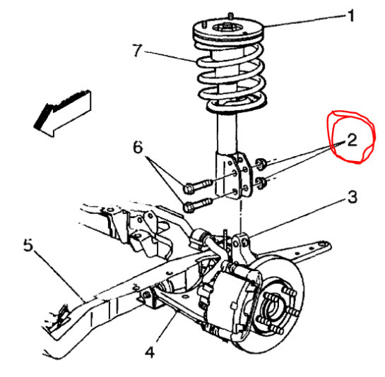

I've attached pictures below of the information you've requested. The top strut mounts require 20 ft lbs (#1 and 2) of torque and the lower strut mount bolts ( #2) require 133 ft lbs of torque. Hope this helps and thanks for using 2CarPros.

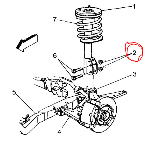

MISSY ROGERS
Are those bottom ones the ones on the knuckle that you need to tightened after changing the CV axle?
May 23, 2020 at 10:53 AM
DANNY L
  • 5,648 POSTS
Hello again.
Yes, the bottom 2 bolts are required to be torqued to 133 ft lbs. Picture included below again.Hope this helps and thanks again for using 2CarPros.
