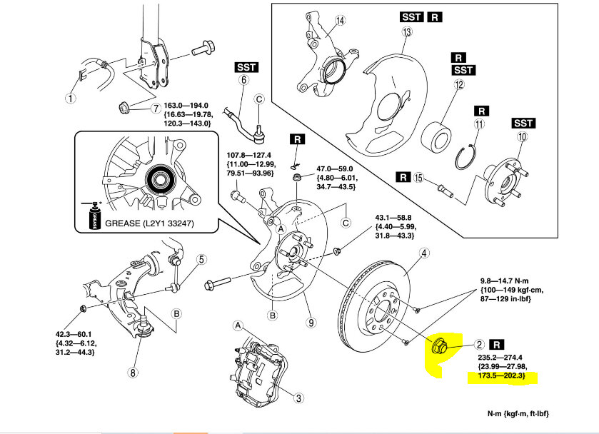

Can I get the Torque for front suspension pieces?
2010 MAZDA CX-7
150,000 MILES • 2.5L • 4 CYL • 2WD • AUTOMATIC
IOWAN13
Hub nut torque.
Jun 22, 2023 at 8:46 AM
  • 110,190 POSTS

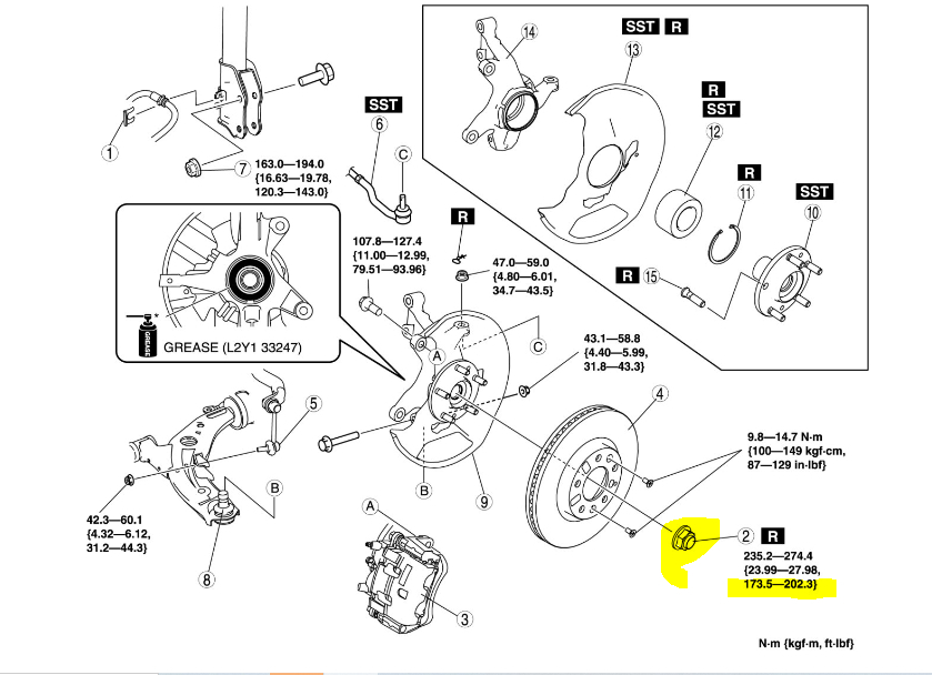

I attached what I believe you are looking for. It is an exploded view of the front suspension, axle nut, and other torque specifications.
Let me know if I have the correct part highlighted. Also, if you have other questions or if I can help, let me know.
See pic below.
