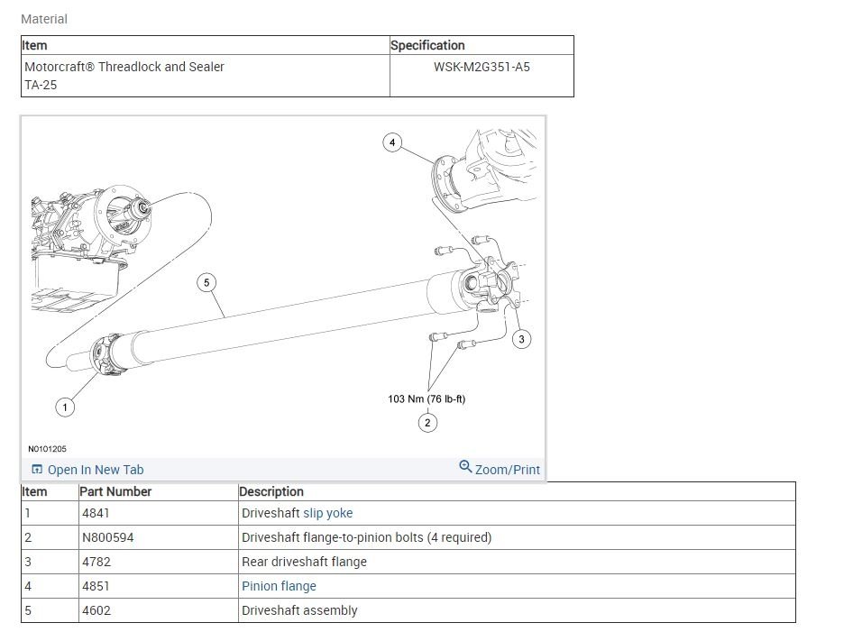

What is the torque spec to replace the drive shaft bolts.
Apr 5, 2021 at 4:12 AM
Experienced Mechanic
52,796 POSTS
Good afternoon,

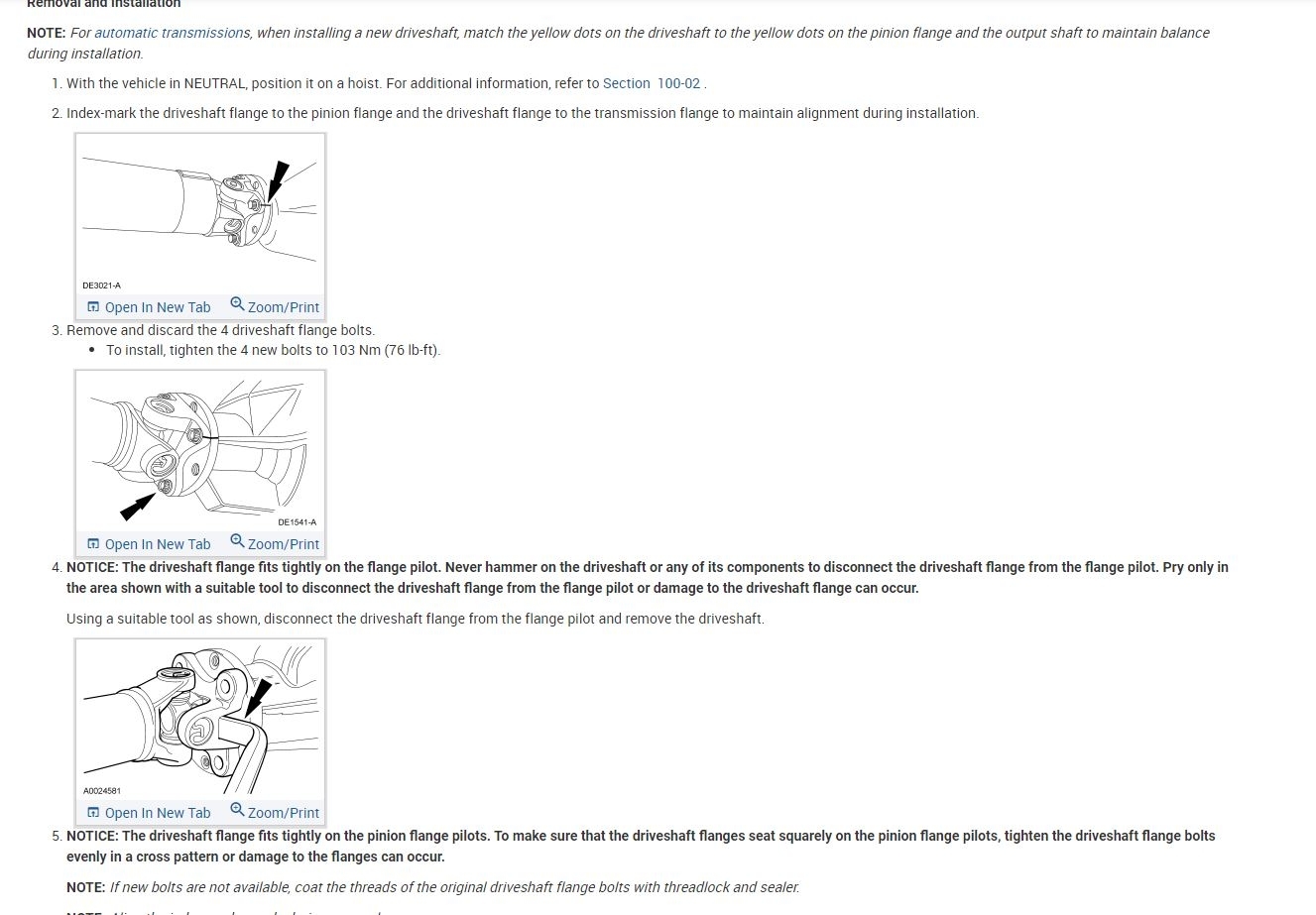

I attached the spec for you below.
It is recommended to replace the bolts but if you reuse them, use a thread locker to be sure they do not come loose.
https://www.2carpros.com/articles/how-to-remove-a-drive-shaft
