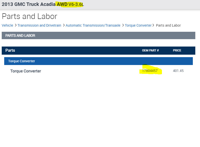

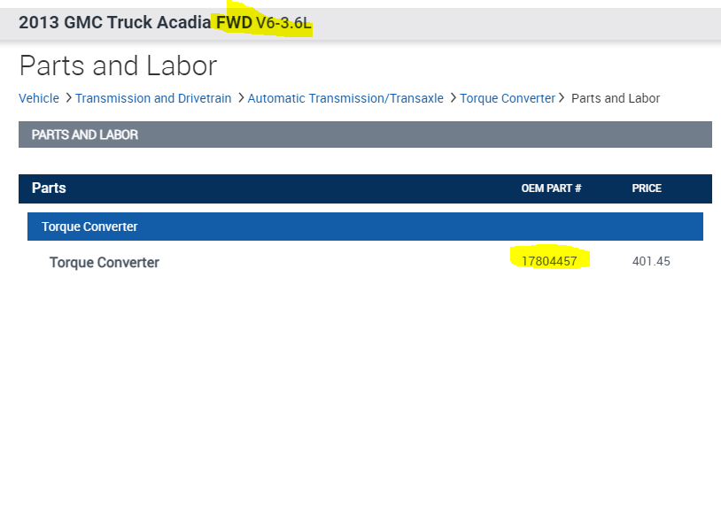

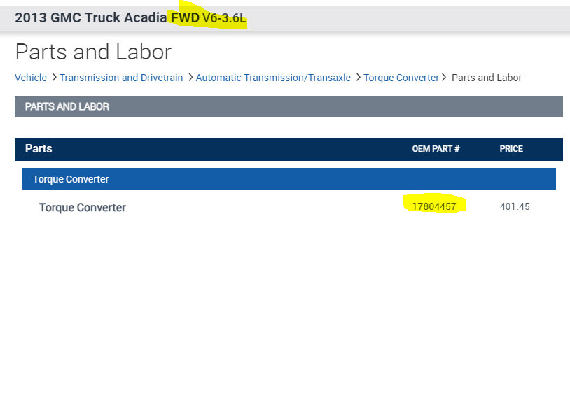

Is the torque converter the same for 2wd and Awd?
2013 GMC ACADIA
154,000 MILES • 4WD • AUTOMATIC
DIVIDES
  • 903 POSTS
Torque converter.
Feb 26, 2022 at 6:16 AM
SQM
  • 6,383 POSTS

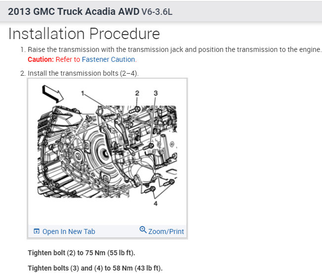

According to Alldata they both use the same part number. OEM # 17804457
I have attached diagrams below.

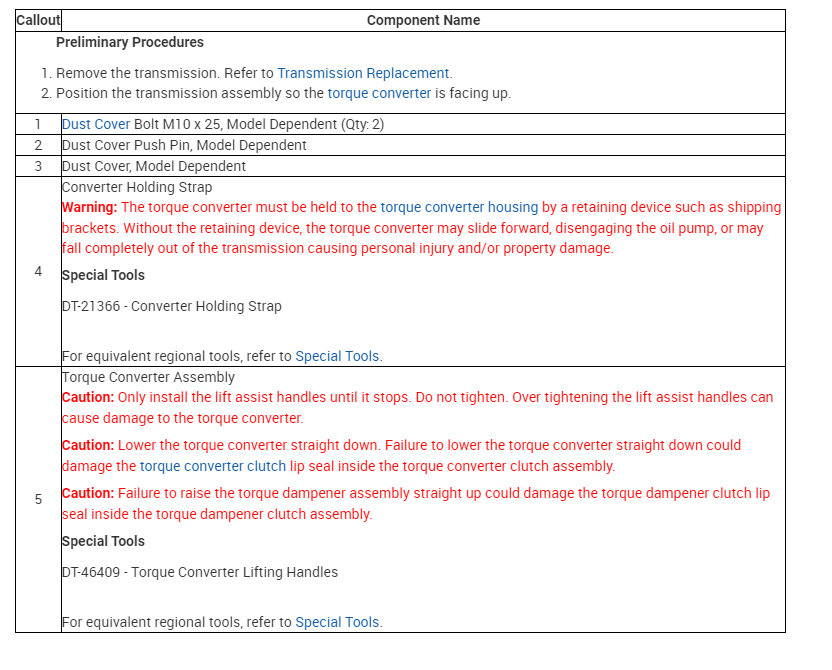

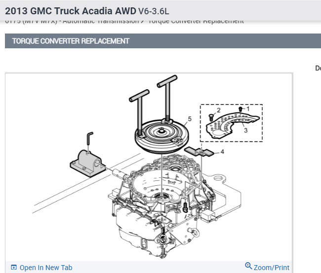

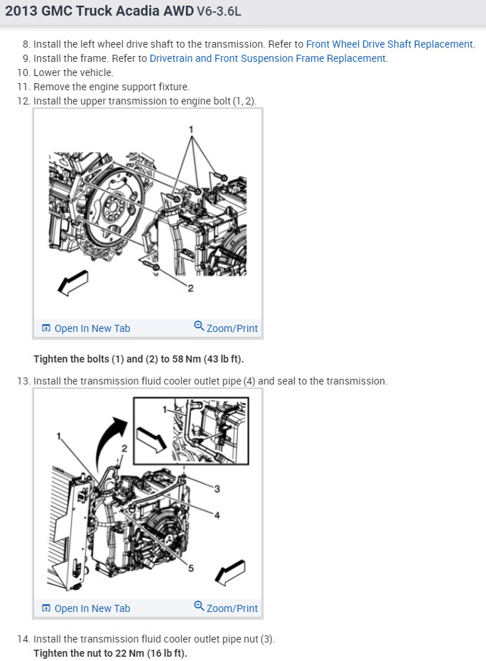

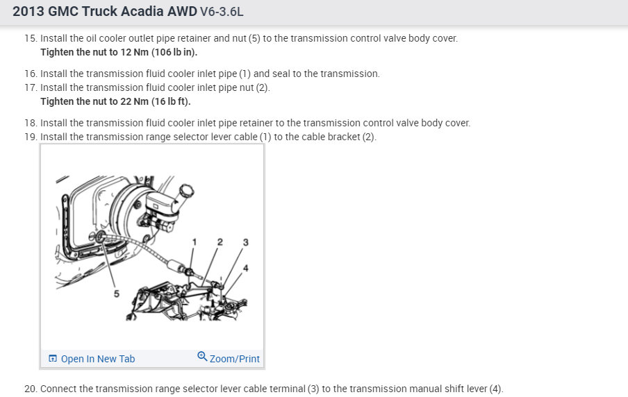

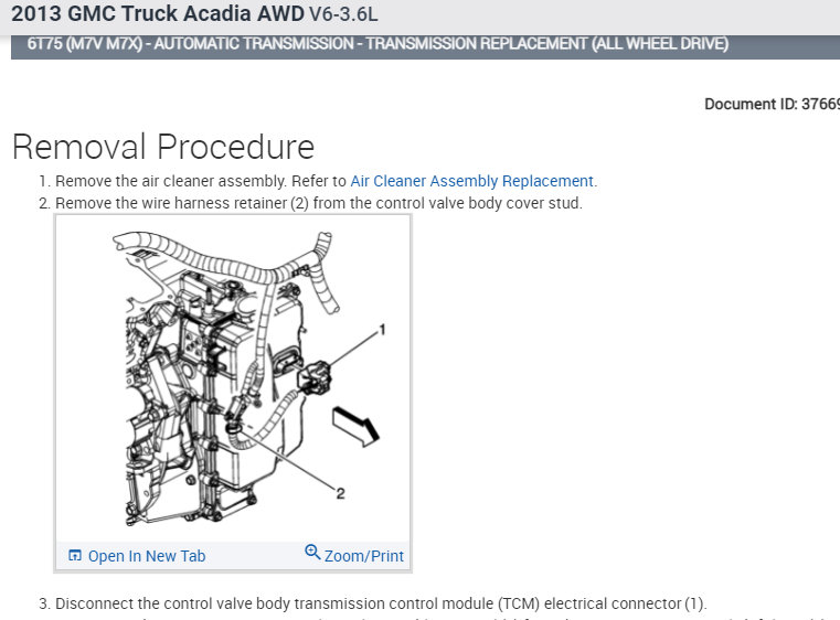

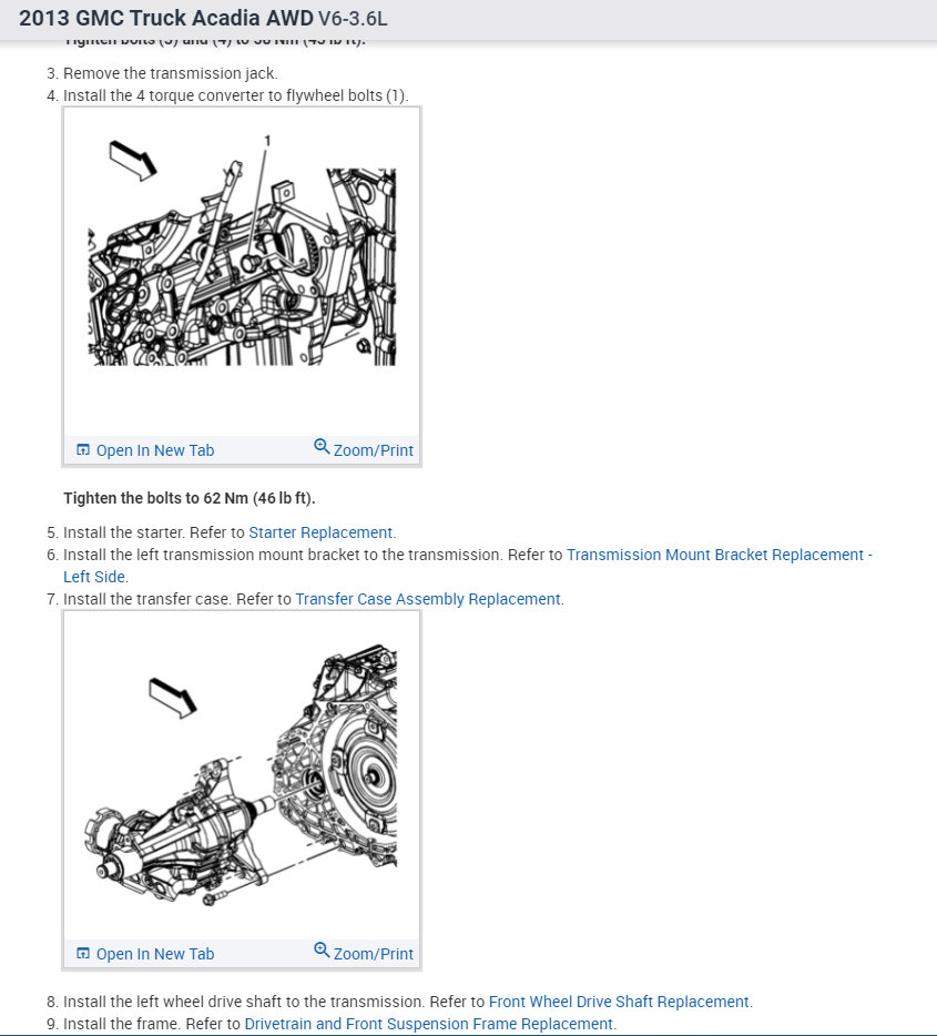

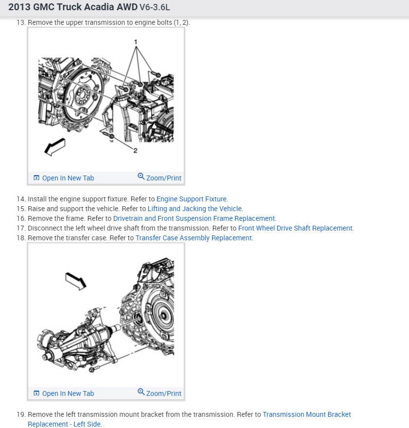

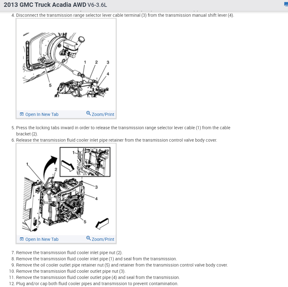

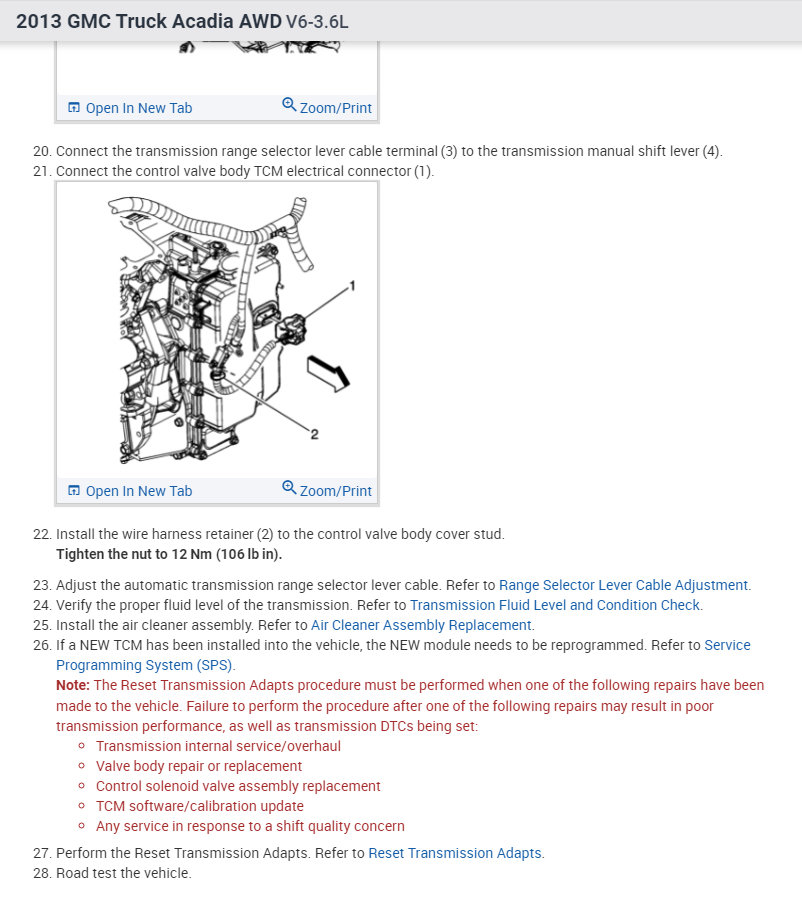

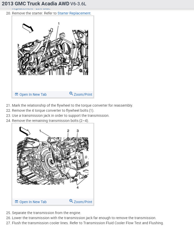

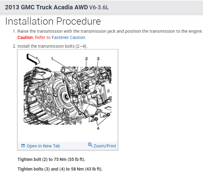

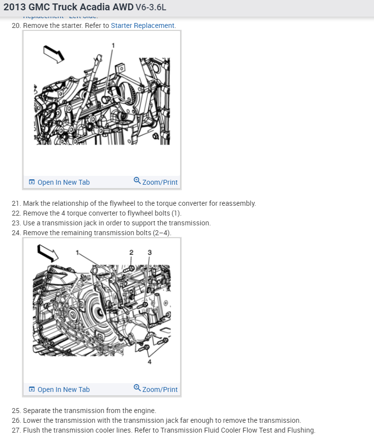

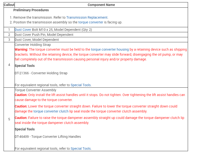

Do you know if any special tools are needed when removing the transmission on this car? I had my shares of engine and transmissions, so I am very handy. Shifting is excellent but the shutter won't stop. I have to change the converter.
Feb 26, 2022 at 9:25 AM
SQM
  • 6,383 POSTS
It does not appear to require any special tools.
I have attached the transmission removal procedure below.
Let me know how it turns out.
