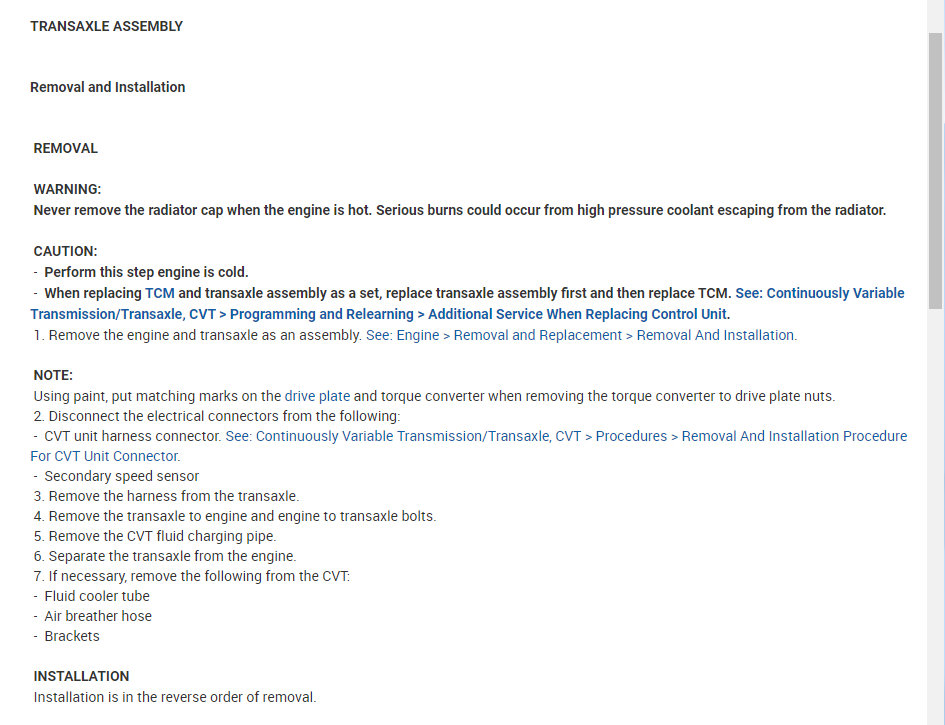

Sounds like the steal belt is slipping in the CVT transmission.
Here is a video on how to remove a transmission. It is not exactly like yours but gives some good info.
https://www.youtube.com/watch?v=3vJAojsrfuU

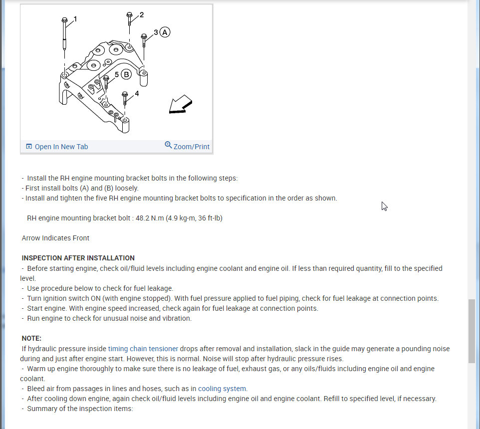

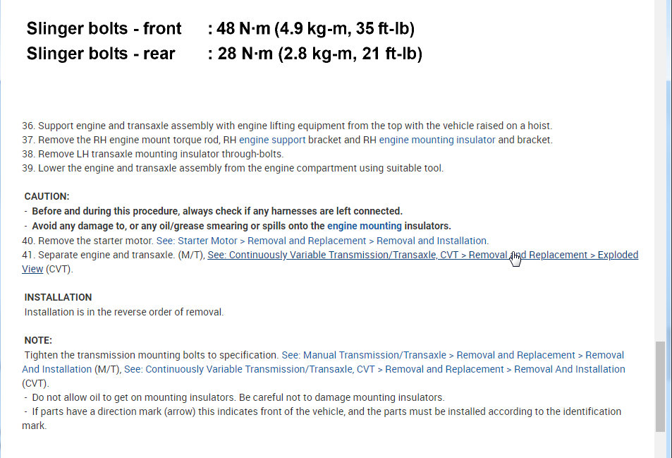

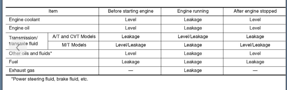

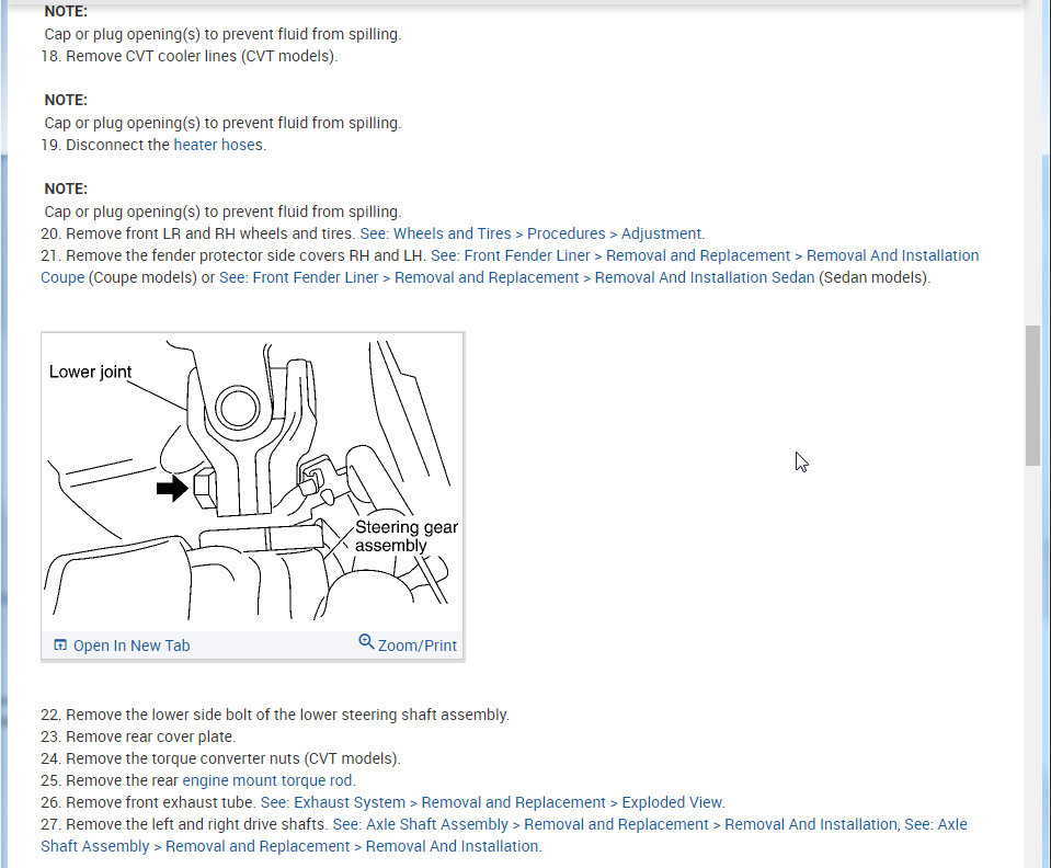

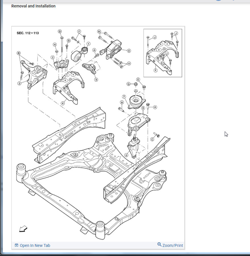

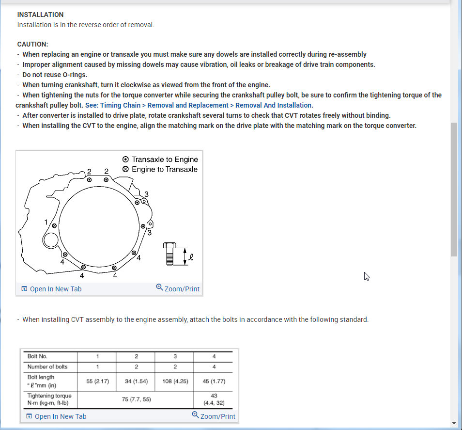

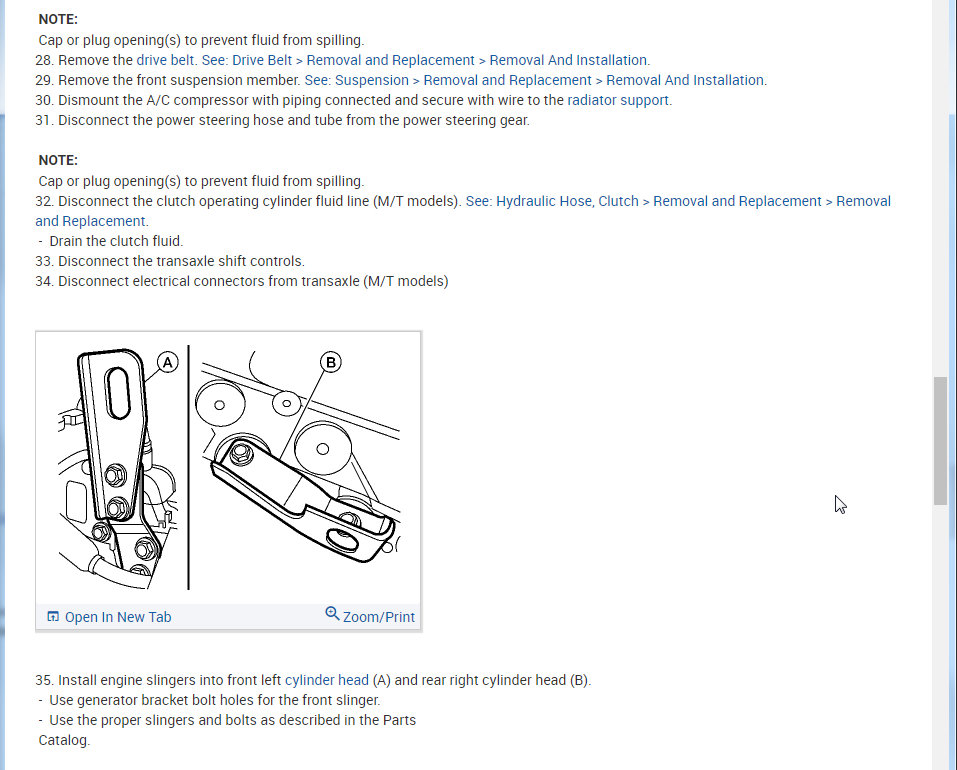

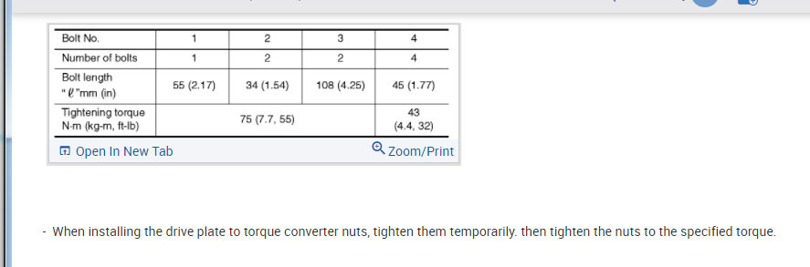

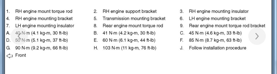

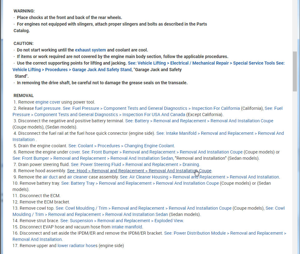

Here is the process on how to replace this from the manual.
Let us know if you have other questions. Thanks
