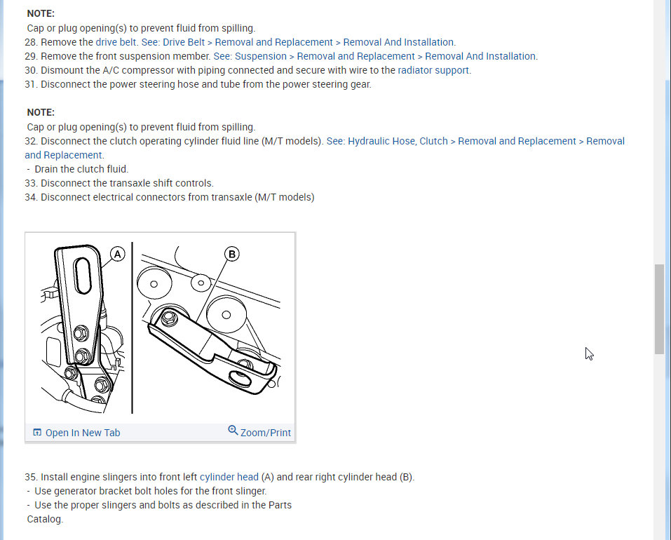

Last week, I noticed my car shuddering when moving at low speed and when I was at a traffic light, the engine shut off. I was able to restart the car and drive while it continued to shudder at low speed (20-30 mph). Later when I started the car, the engine shut off as soon as I shifted the gear to R or D. The tow truck driver says I need a new transmission how can I remove it?
Please advice. Thanks.
Jan 10, 2019 at 9:36 AM
Sounds like the steal belt is slipping in the CVT transmission.
Here is a video on how to remove a transmission. It is not exactly like yours but gives some good info.
https://www.youtube.com/watch?v=3vJAojsrfuU

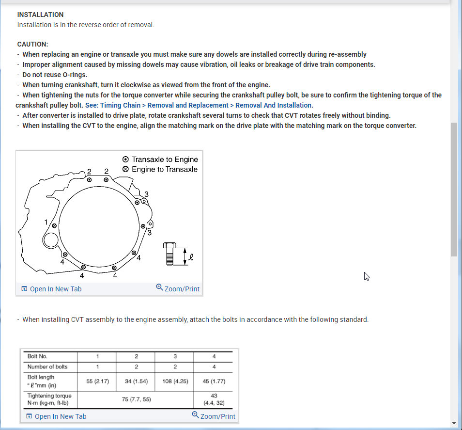

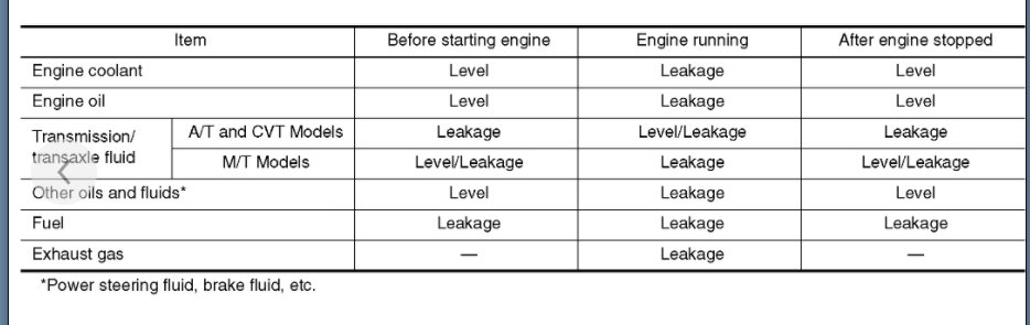

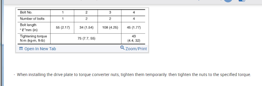

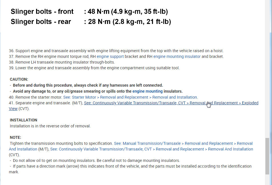

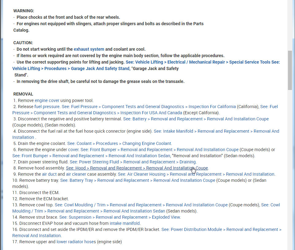

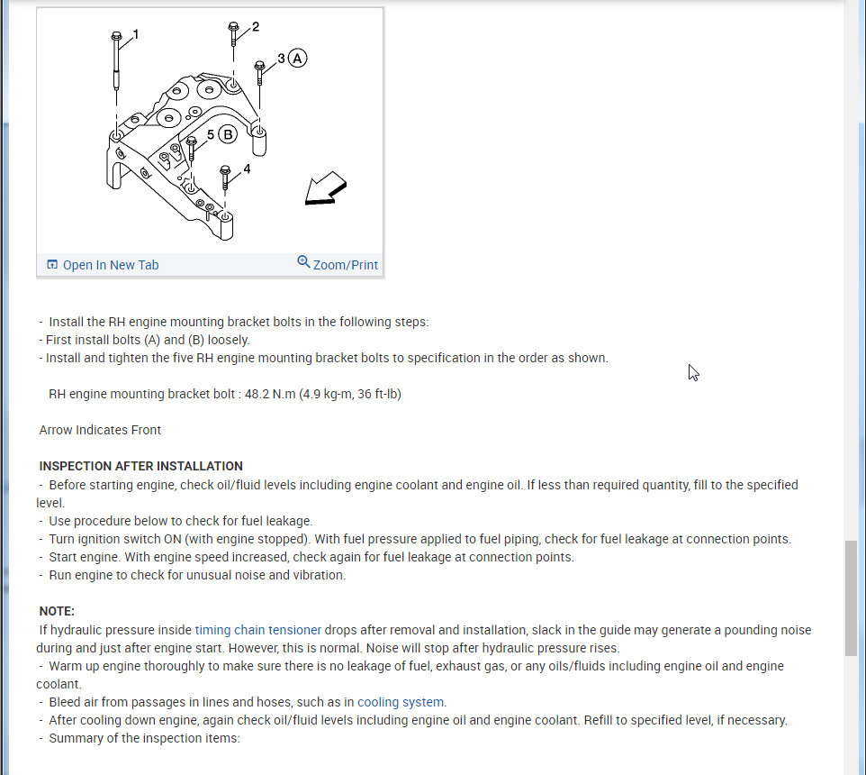

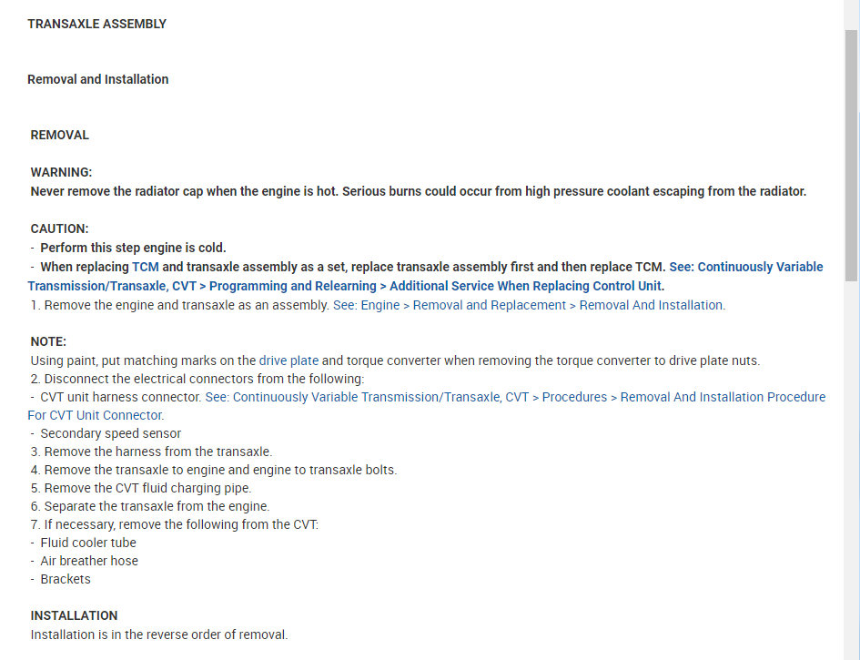

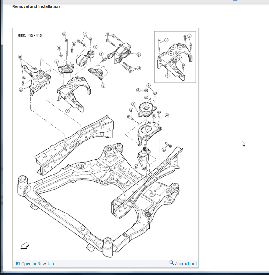

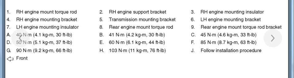

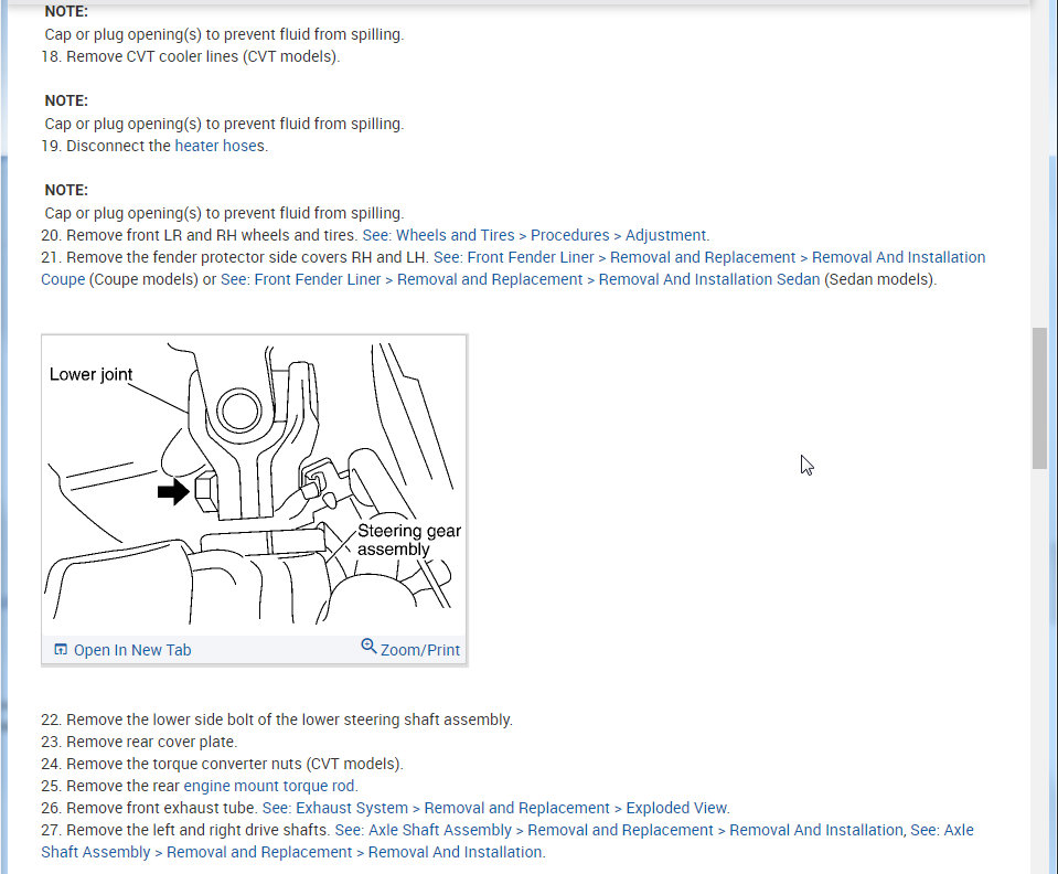

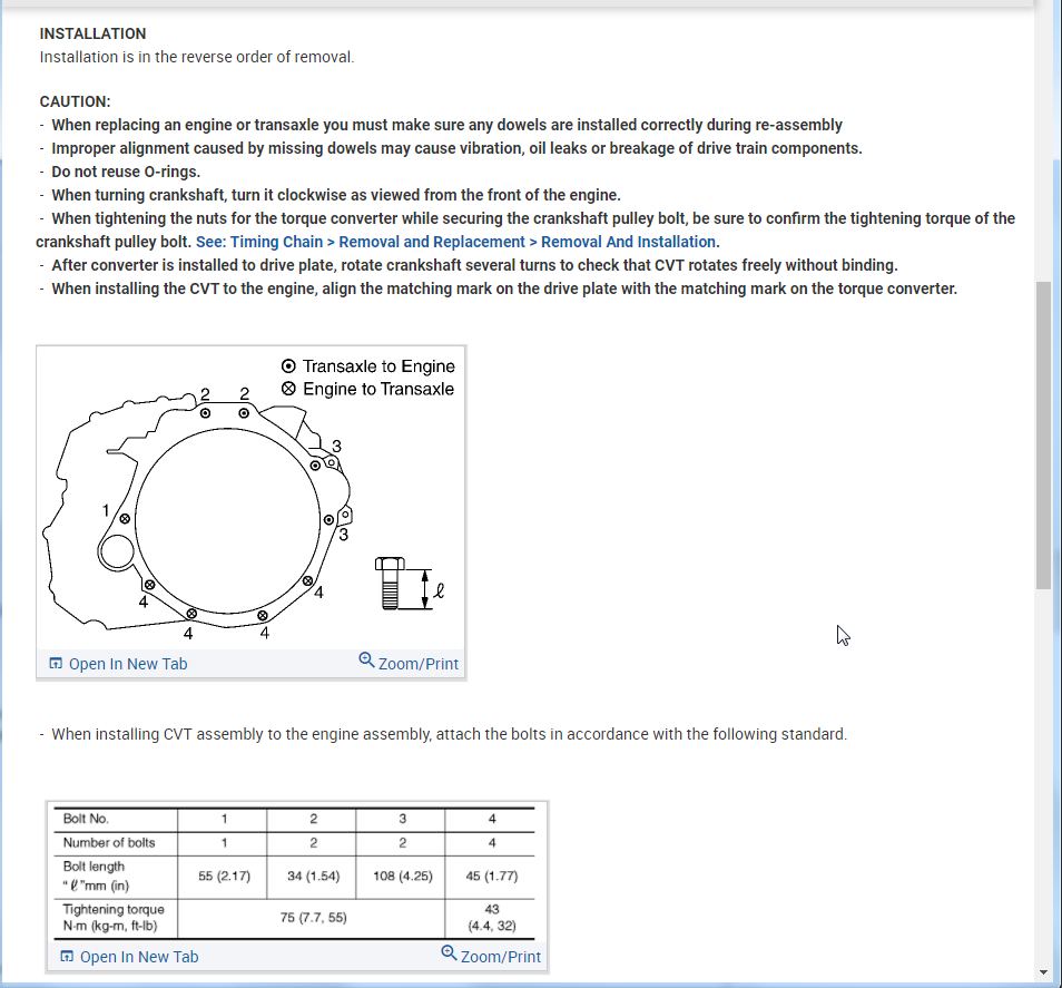

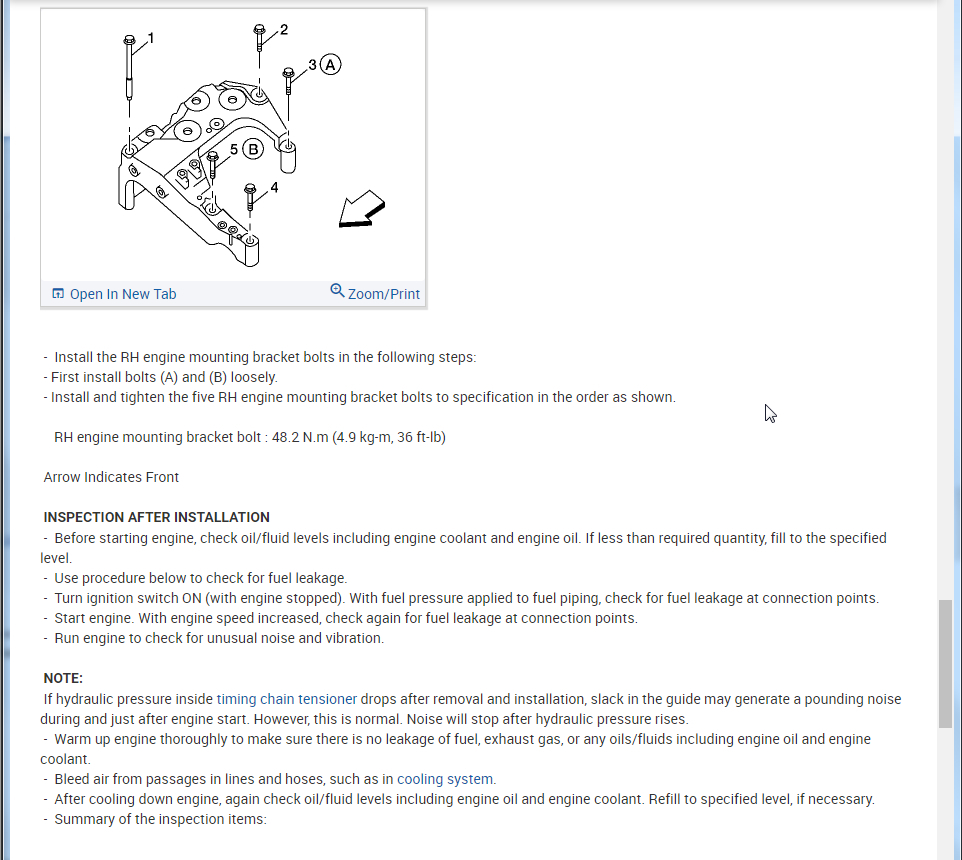

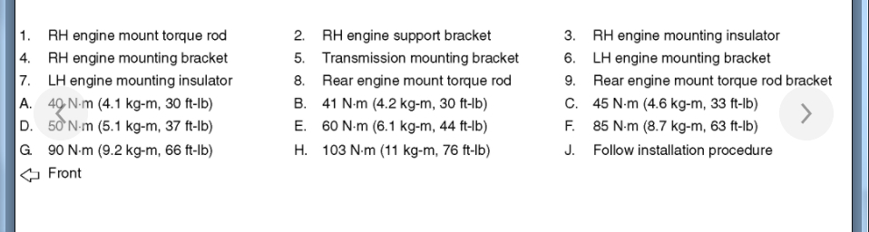

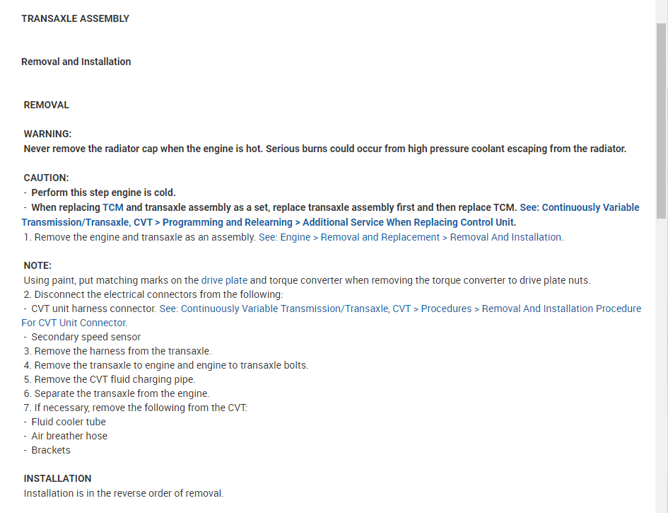

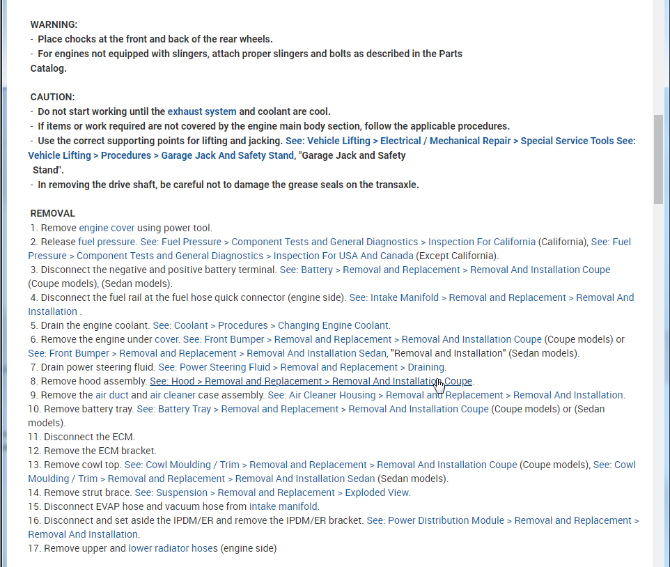

Here is the process on how to replace this from the manual.
Let us know if you have other questions. Thanks
