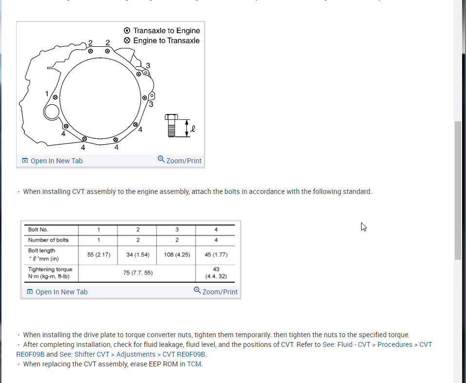

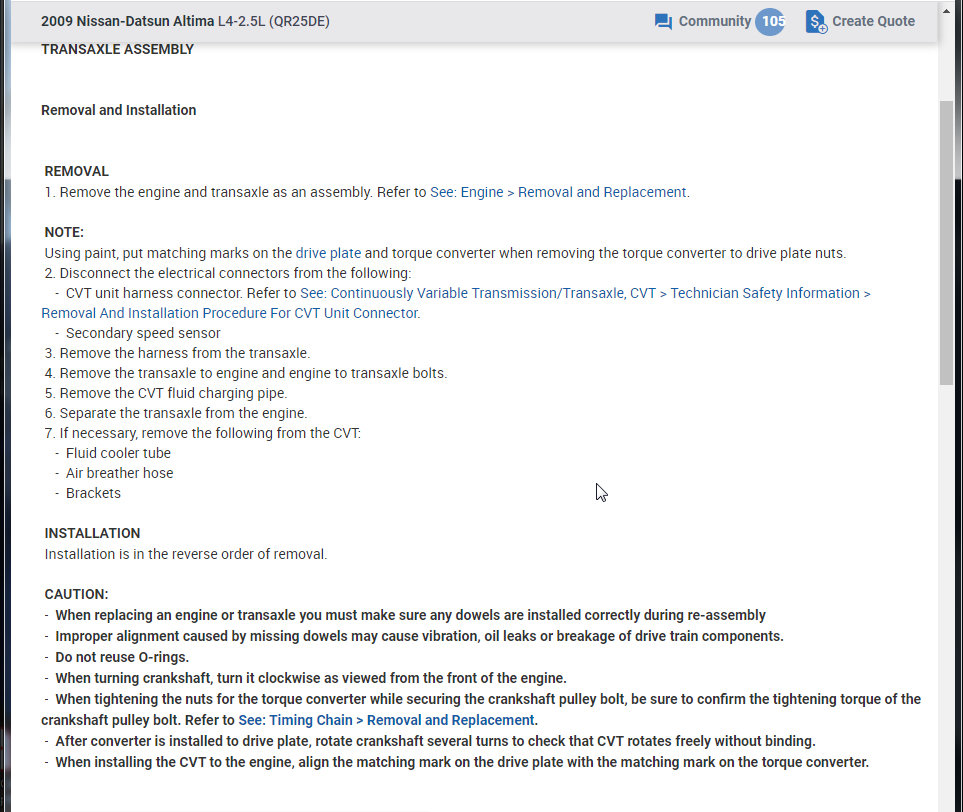

i'm having a transmission problem i think, i was driving 2 the store when my car started to shake but then it stop, then a couple miles down the road, it started to shake again, then it jus wouldn't accelerate, pulled 2 the side and turned it off, then turned it back on, now it stop revening completely, so i check the transmission fluid and come to find out i have no fluid in the car and i have a small leak... but now I need to remove the transmission

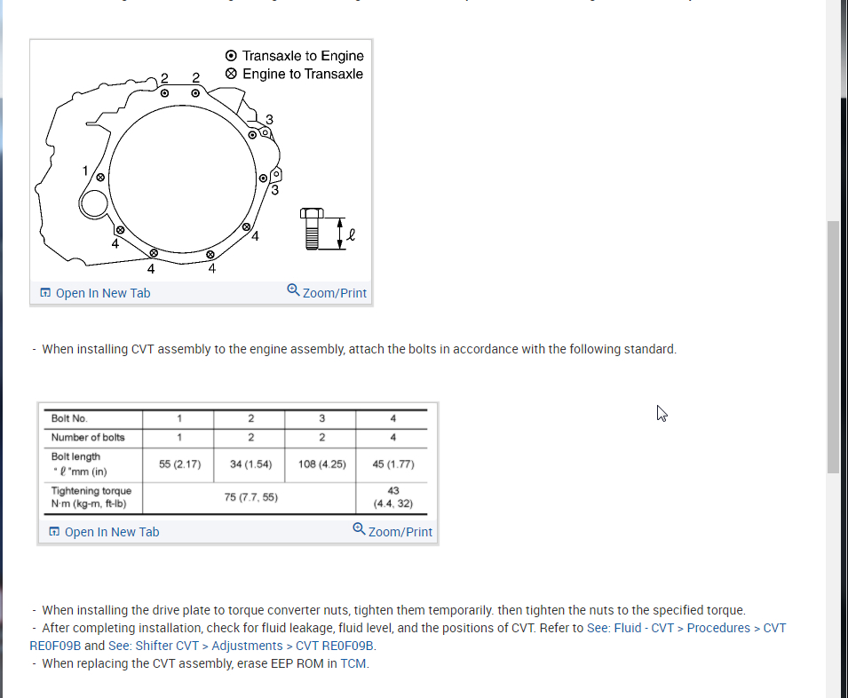

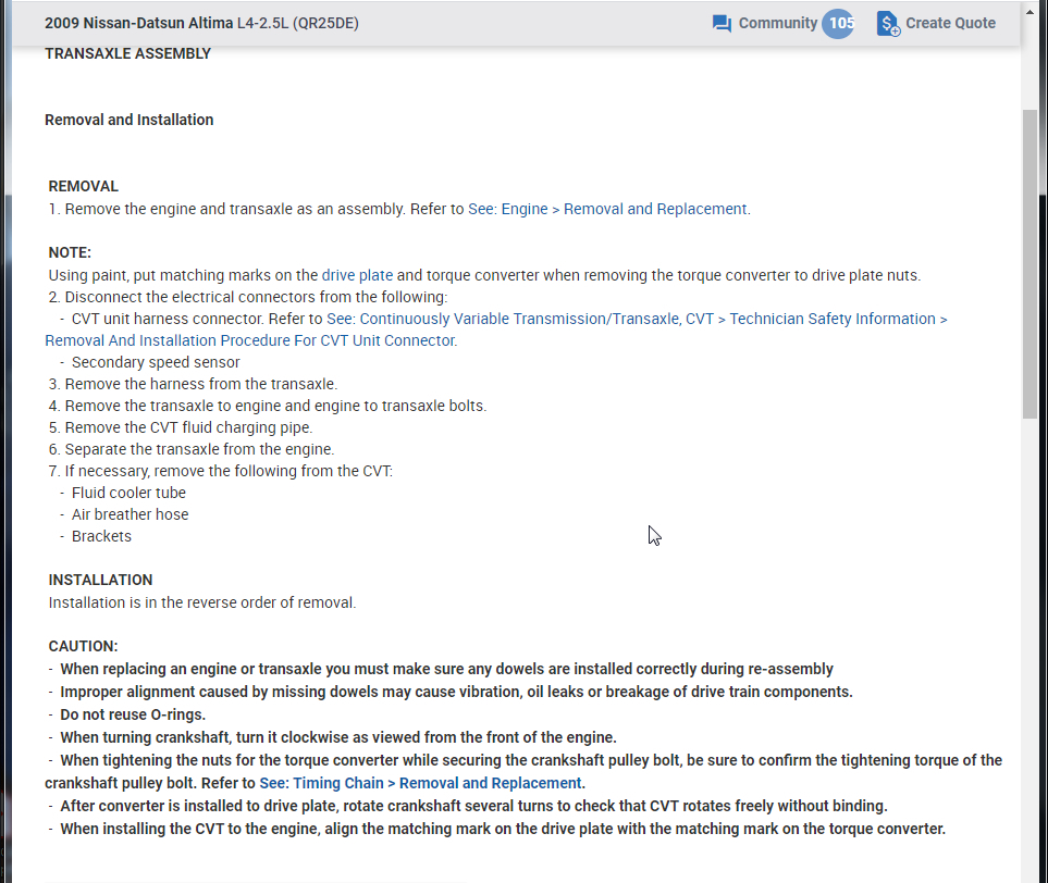

Below is the process from the manual that will help with doing this. Please run through this material and we can go from there. Thanks
