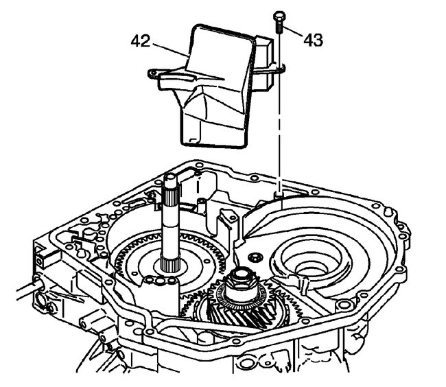

i would like to ask what do you mean by " (in my mind) it seems like there is a line pressure issue even though the codes indicate an issue with the torque converter clutch." do you mean is it caused by bad solenoid or low transmission fluid? and does xl7 2007 has transmission fluid filter ? when I changed the transmission fluid 6 months ago, the mechanic opened a bolt under the car to get rid of the old fluid and then filled it from under the hood in passenger side, beside the air mass! is it the correct place for transmission fluid ? here is a strange point, in the winter when I drive the car for short distance the problem dose not appear at all, and this make me really confused (as you indicated if the problem in the transmission it will always be there, and when i shift it from N to D or from D to N or P i never had a problem, like it dose not go to N and that is really weird because it shifts normally, my shifting only suffers in the 3rd, 4th gear ). pardon me that i ask too many questions but i really love to learn such stuff and the right place to learn is from expert guys.
Jul 21, 2020 at 9:29 PM
  • 110,248 POSTS
Based on your description, to me it sounds like a pressure issue. Is there a filter? Yes, but it's difficult to reach. The transmission needs taken apart. See pic 1.
Now, when it's cold outside (winter), you never have trouble? Even if you drive it further?
Jul 22, 2020 at 9:48 AM
