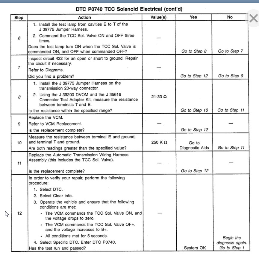

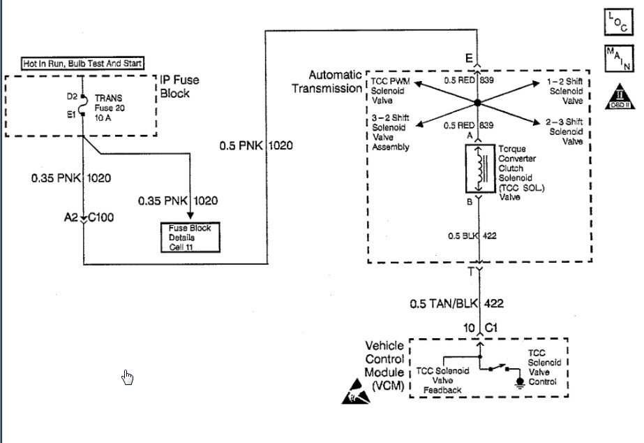

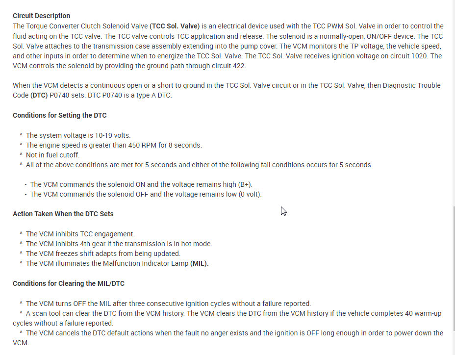

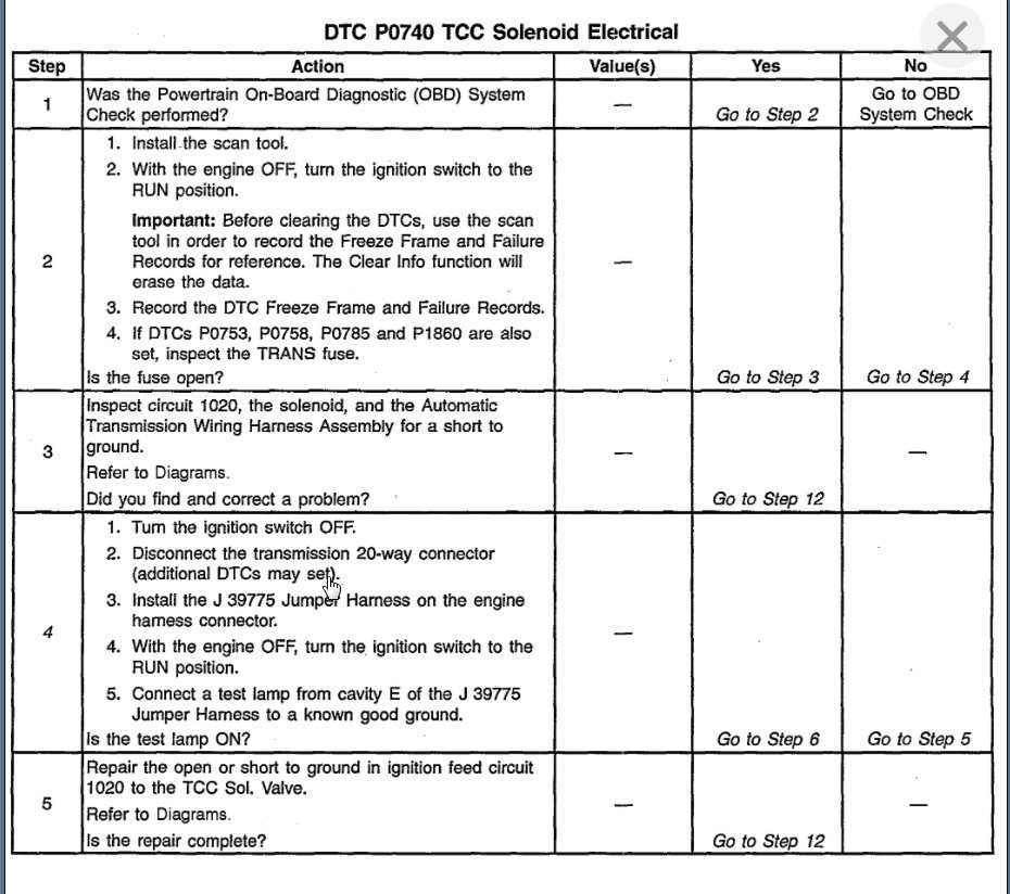

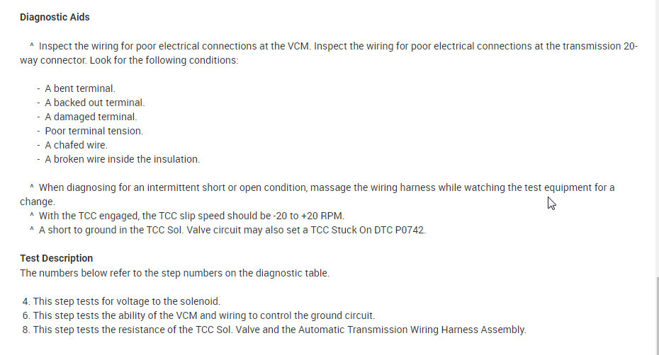

Unfortunately, this is pointing to an electrical issue so I attached the info below on how to testing this.
Here is a guide that will help with this:
Please review this material below and let us know what questions you have. Thanks
