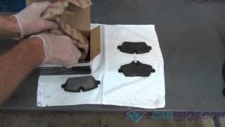

What is the correct torque ft lbs for the front brake calipers for the Z71 model?
Sep 12, 2020 at 1:13 AM
Good afternoon,
The bracket for the caliper mount to the hub is below
https://youtu.be/9pwFodKAl5A
and
6. Install the 2 caliper bracket mounting bolts.
Tighten the brake caliper bracket mounting bolts to 175 Nm (121 ft. lbs.), 15 Series.
Tighten the brake caliper bracket mounting bolts to 300 Nm (221 ft. lbs.), 25 Series.
The caliper mounting bolts are below.
2. Install the 2 brake caliper mounting bolts.
Tighten the bolts to 108 Nm (80 lb ft).
This video should help as well
