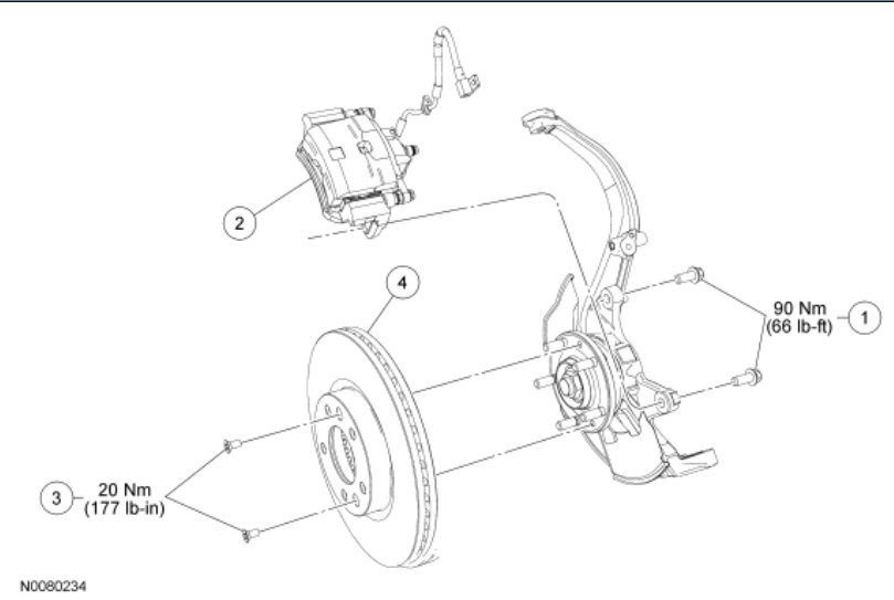

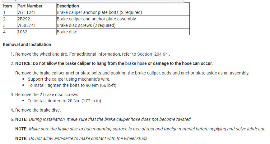

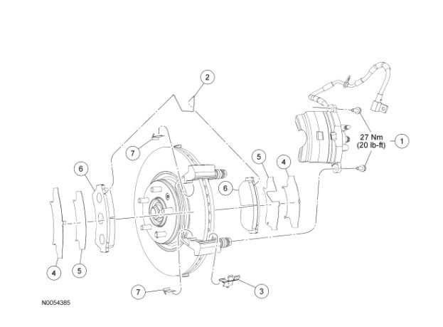

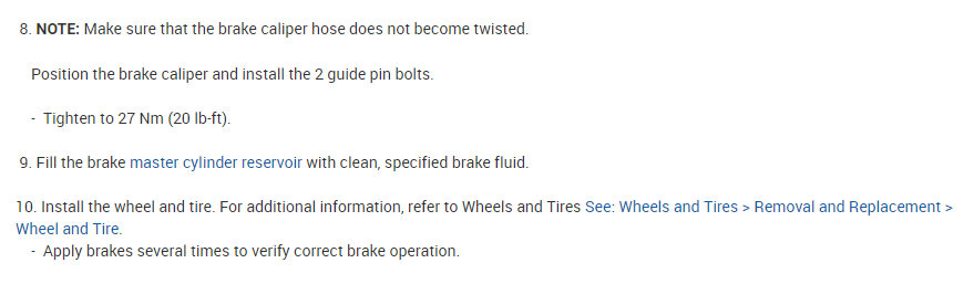

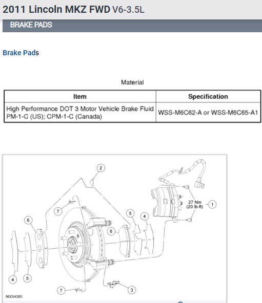

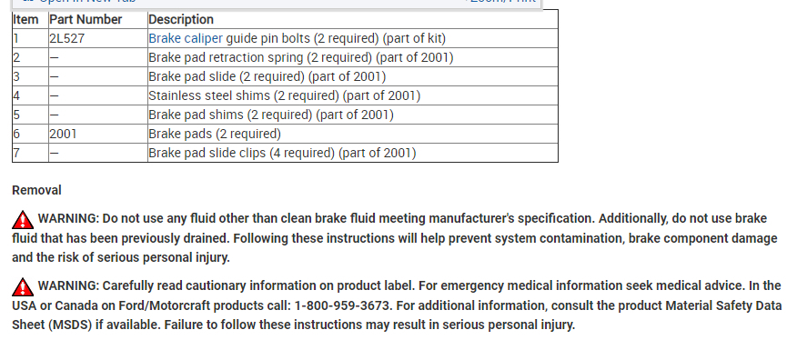

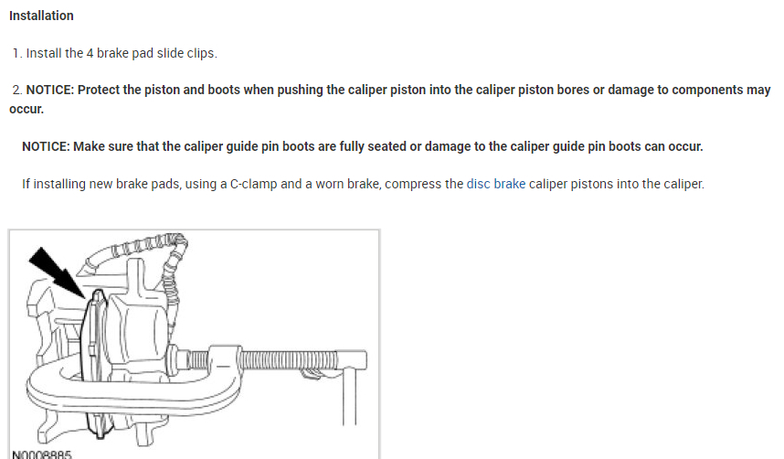

what torque is used to tighten the caliber bolts
2011 LINCOLN MKZ
31,000 MILES • 3.6L • 6 CYL • 2WD • AUTOMATIC
JUDY FLEENOR
Can you tell me at what torque is used to tighten the caliber bolts for the rotor on my car listed above, plus I need to do brakes?
Apr 24, 2017 at 4:23 AM
DANNY L
  • 5,648 POSTS
Hello, I'm Danny.

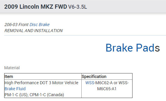

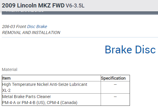

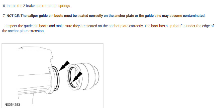

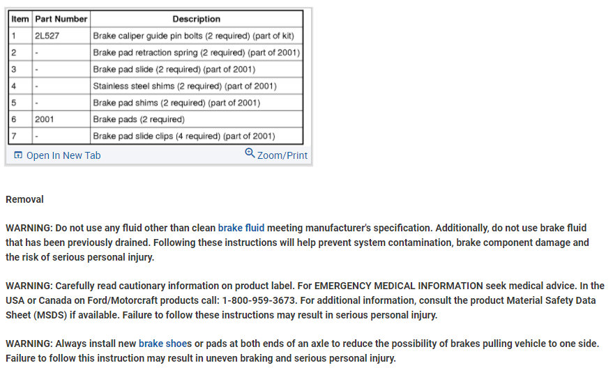

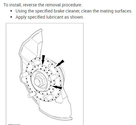

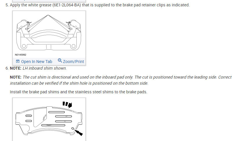

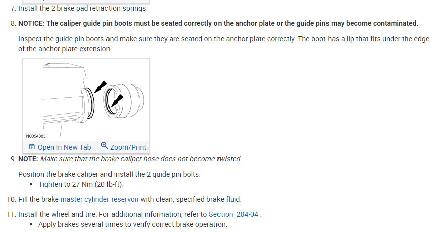

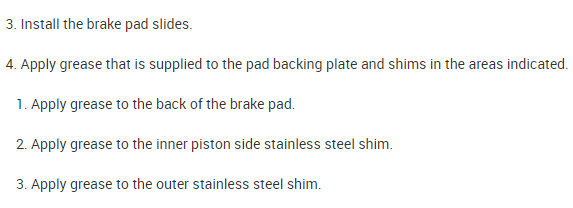

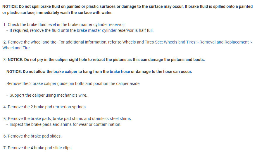

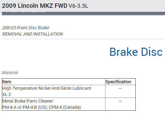

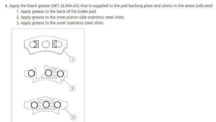

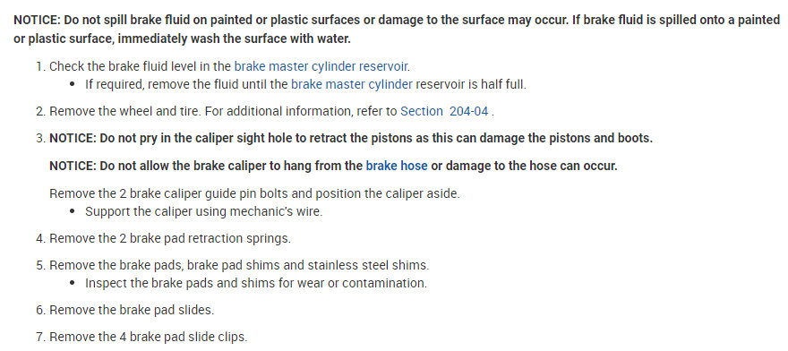

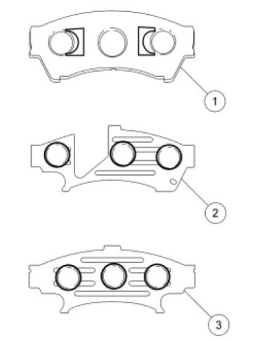

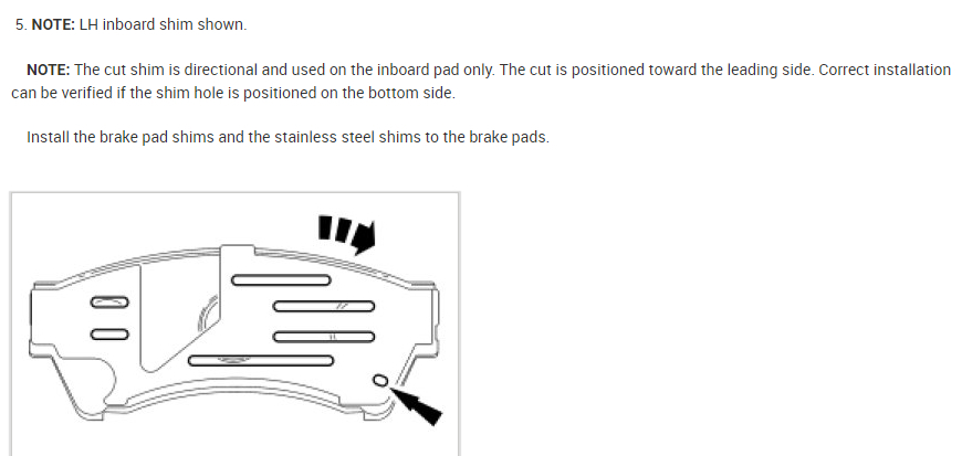

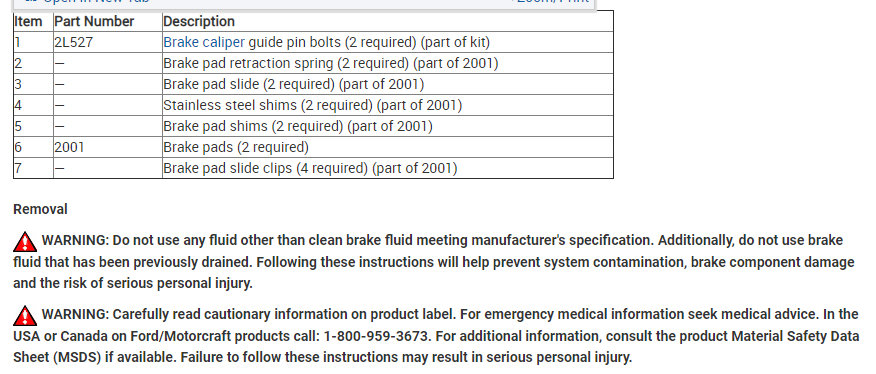

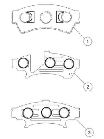

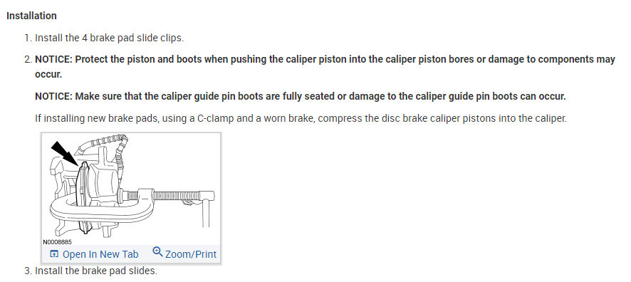

Here is the information you requested and the caliper bolt torque is on the picture. This is a tutorial showing what is involved on how to change front brake pads and brake rotors:
I've attached picture steps below on how to change the front brake pads on your car. Hope this helps and thanks for using 2CarPros.

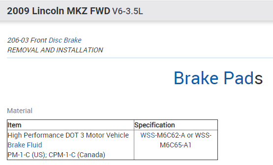

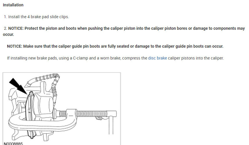

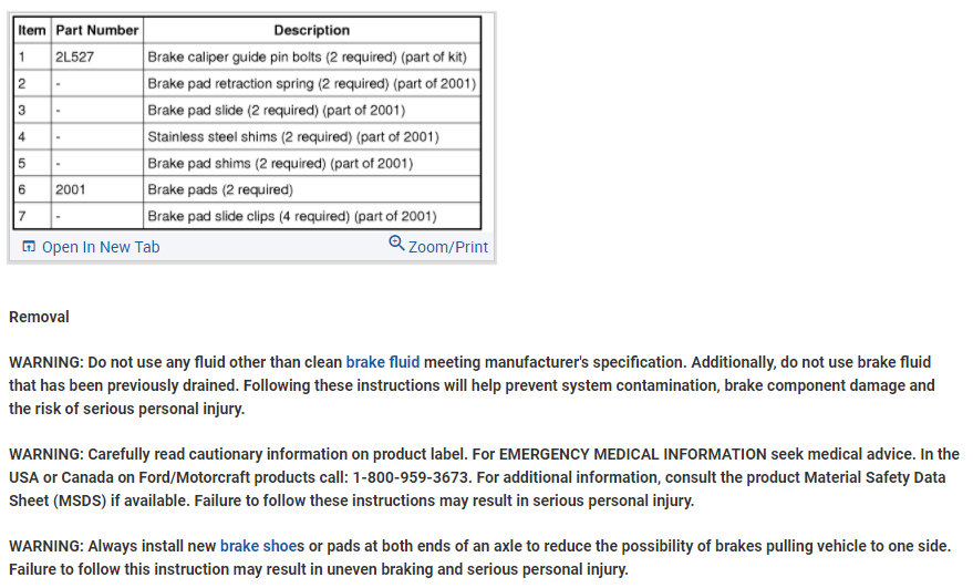

Can you show me how to do the brakes on my car?
Mar 2, 2021 at 1:40 AM (Merged)
DANNY L
  • 5,648 POSTS
Hello, I'm Danny.
Here is the information you requested. This is a tutorial showing what is involved on how to change front brake pads and brake rotors:
I've attached picture steps below on how to change the front brake pads on your Lincoln. Hope this helps and thanks for using 2CarPros
