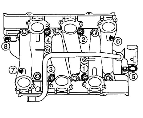

What is the torque on the intake monofilament bolts?
Please
Sep 20, 2016 at 12:38 PM
JIS001
  • 3,412 POSTS
Tighten the bolts in the sequence shown.
Tighten the lower intake manifold vertical bolts to 7 Nm (62 inch lbs.) .
Tighten the lower intake manifold diagonal bolts to 13 Nm (115 inch lbs.) .
The upper plenum. Tighten the bolts to 25 Nm (18 ft. lbs.)
