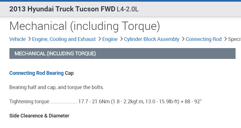

What is the torque specification for the connecting rod caps?

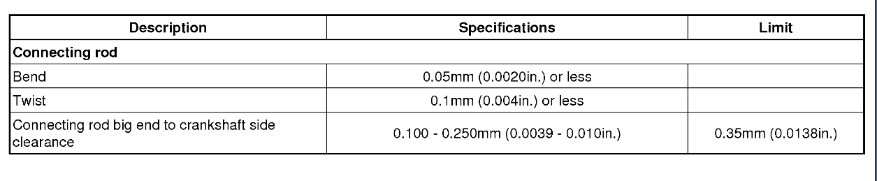

I have included the information that you requested in the diagrams down below. please get back to us with how everything turns out. I hope this helps.

Thanks really helpful.
