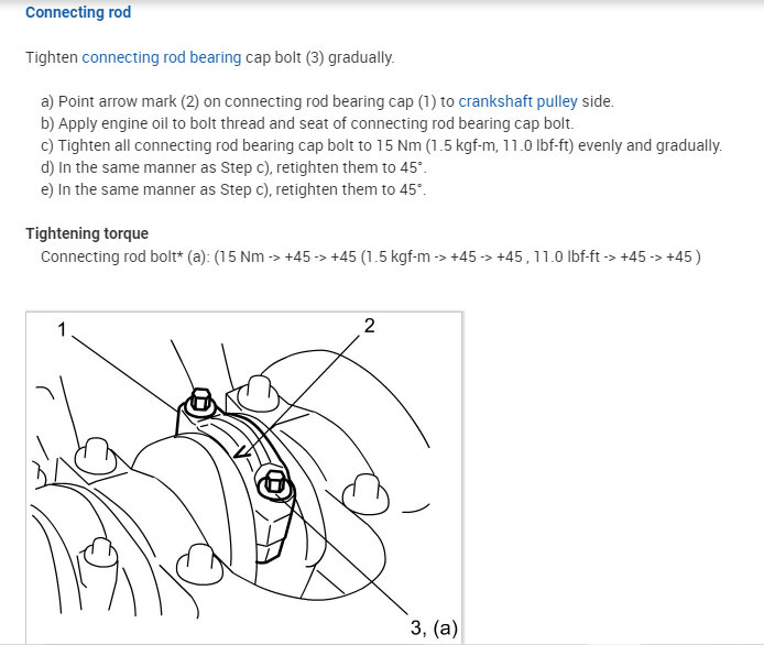

Hello Guys, I am looking for Torq specs for piston Rods and bearings.

The closest thing I have isn't any good for you. It's a 2013 2.0L. I attached them for you to see but that is the newest thing I have.
See pic below.

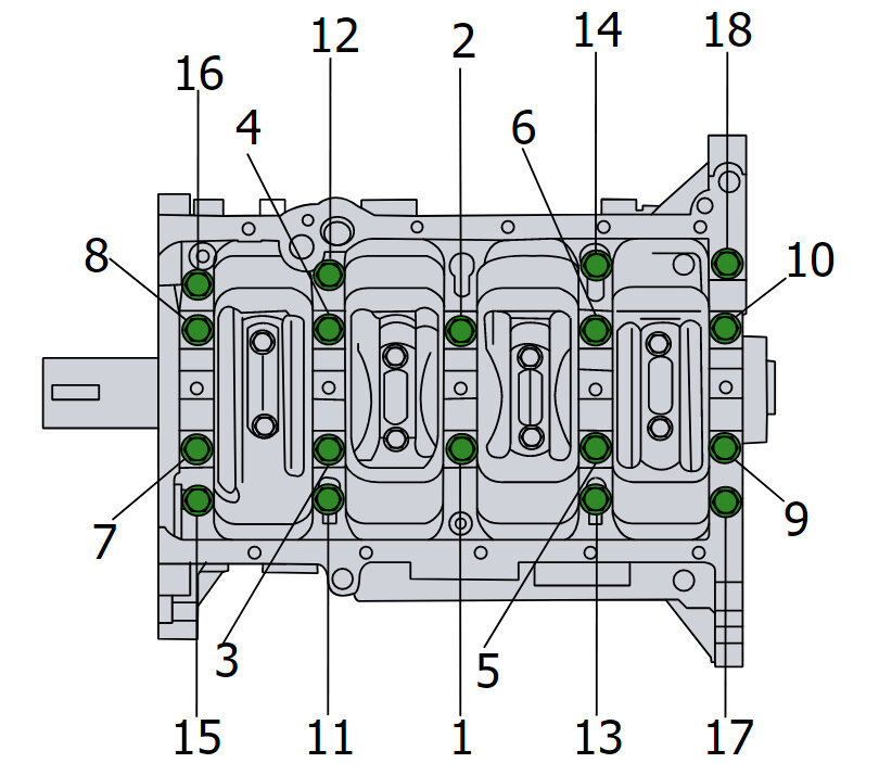

Main bearing cap
Stage 1 20Nm
Stage 2 40 Nm
Stage 3 60 degrees
See image 2 below for main bearing tightening sequence

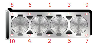

Cylinder head
Stage 1 15Nm
Stage 2 30 Nm
Stage 3 70 degrees
Stage 4 65 degrees
See image 1 below for cylinder head bolt tightening sequence]

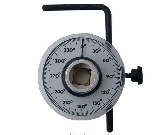

To tighten bolts to degree specification please use an angle gauge, see image 3
