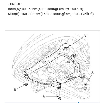

I need the torque specs for the two nuts and two bolts to fix the subframe. Thanks

If you look below, I attached the torque specs for the sub frame bolts and nuts. Let me know if this is what you needed.
See pic below.
