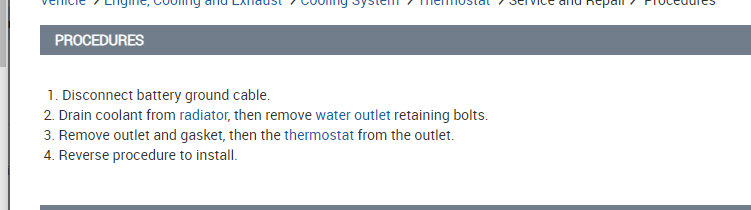

what is the bolt specs lbs. for the 2 bolts.?
torque specs temperature thermostat housing bolts for the vehicle listed above LS model.

Below is the process from the manual. Please run through this material and let us know if you have other questions. Thanks

Looking for torque. Provided instruction with AI. Useless. If I’m looking for torque, I’ve already completed the steps and I’m ready to tighten the bolts to the torque spec.

Sure they are 18 ft-lbs (25 Nm)
