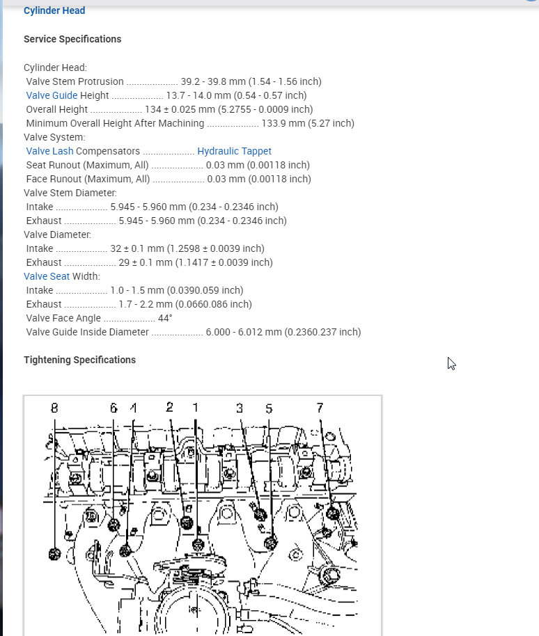

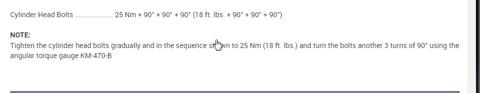

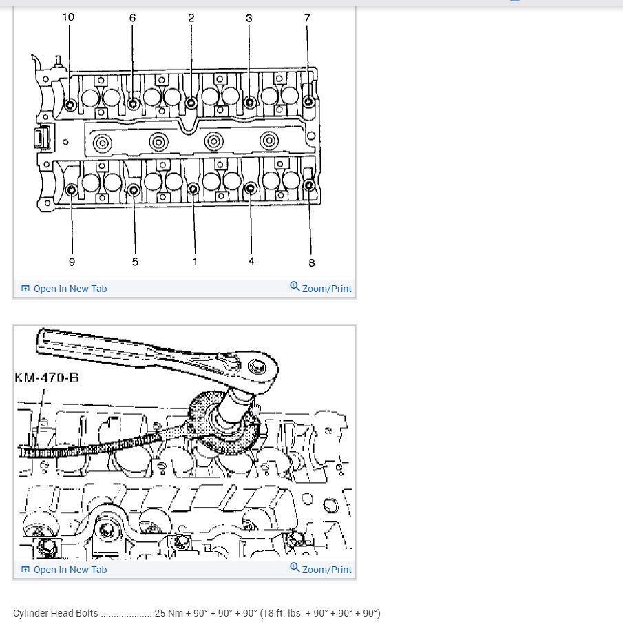

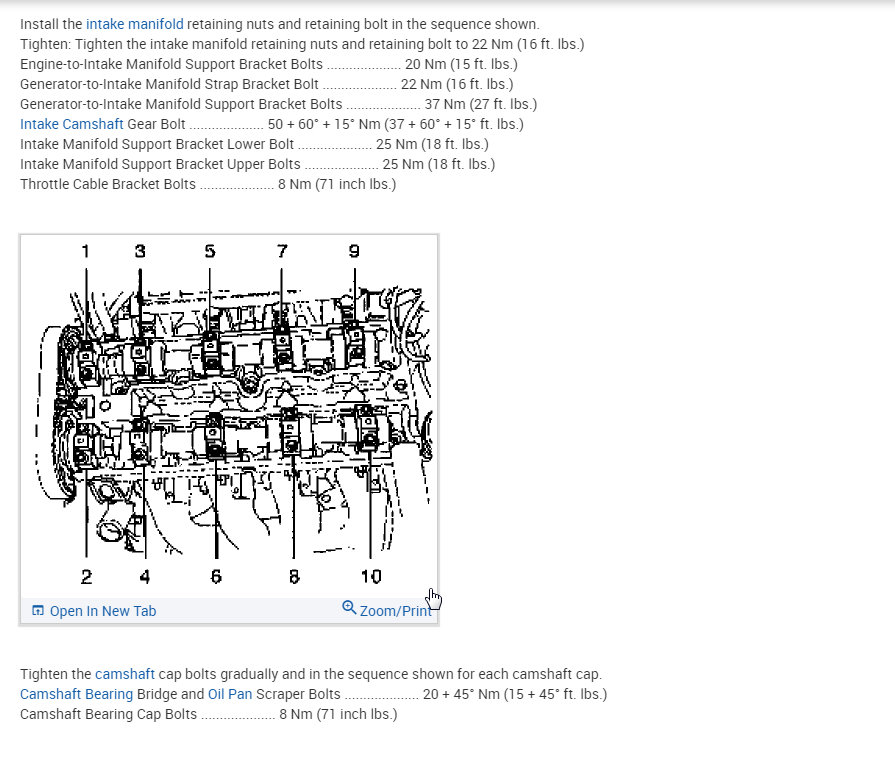

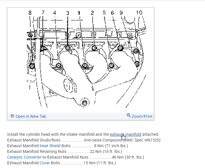

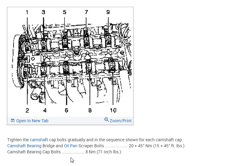

toque specs needed for cam cap bolts and head bolts
2008 SUZUKI FORENZA
150,000 MILES • 2.0L

2.0 double overhead cam.

I attached the process for this. I attached more than you may need but figured I would give it all to you. Let me know if you need more info. Check out the images (below). Let us know if you need anything else. Thanks
