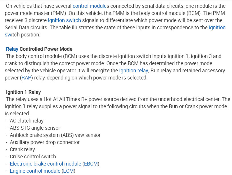

1CRAZYTAZMAN
After replacing the catalytic converter and O2 sensors since having disconnecting negative battery erasing the check engine codes. I no longer have any codes. It was running great went to store four miles away came out went to go back home when it went into limp mode. the only code at time was clogged catalytic converter. so is why I replaced. also while was there replaced both O2 sensors. cleaned the throttle bore. there is no knocking, no funny odors or noises no stalling. Very smooth idle even smooth when rev up engine except the fact that it limits at 3,500 rpm's. I do not have a lot of money to be changing unnecessary parts. But would love to get it running again.

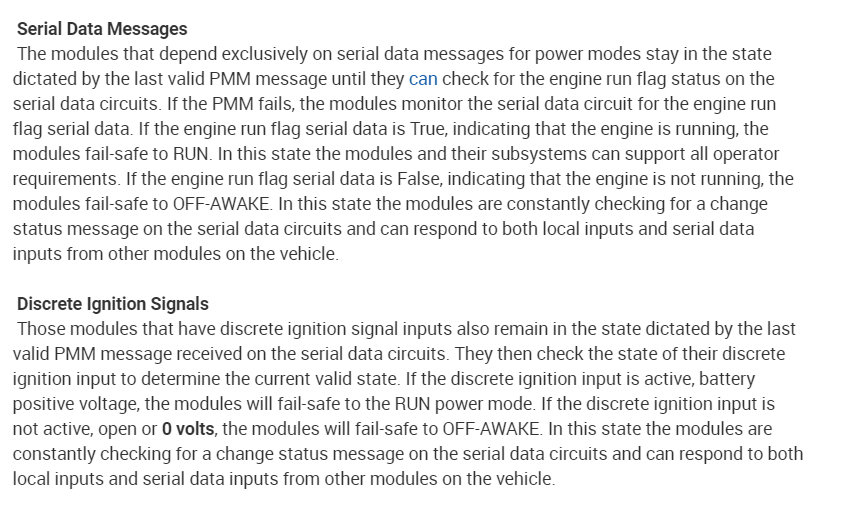

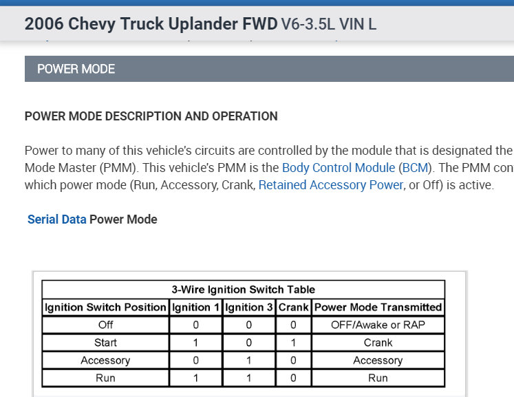

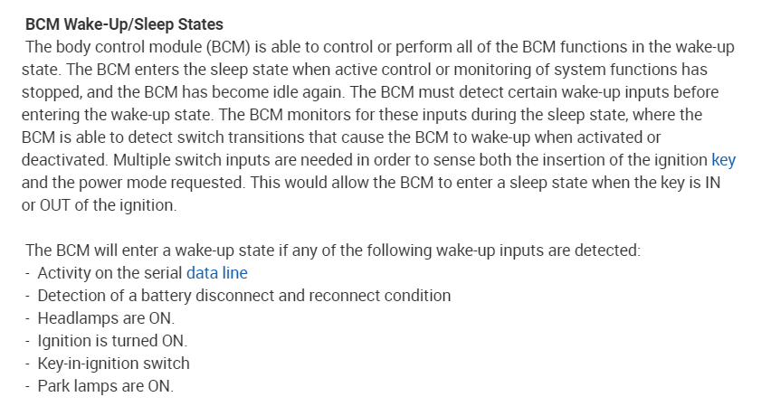

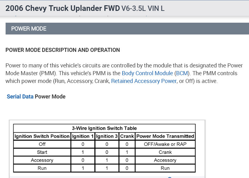

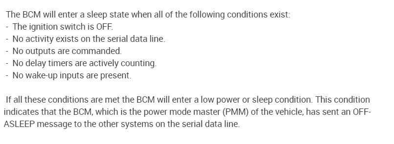

SCGRANTURISMO
  • 4,897 POSTS

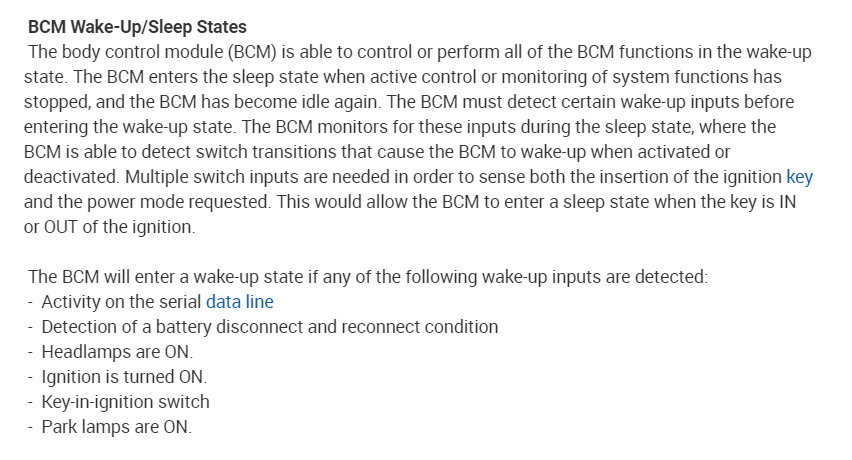

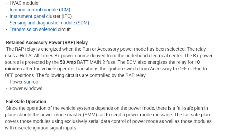

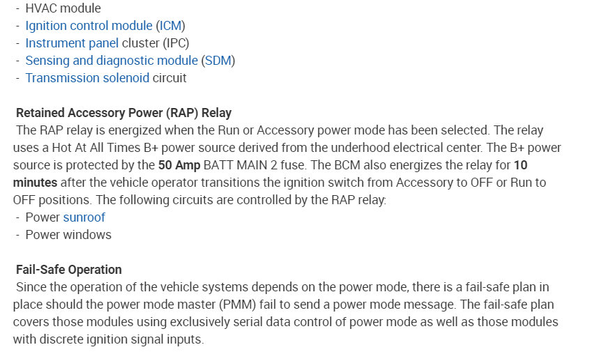

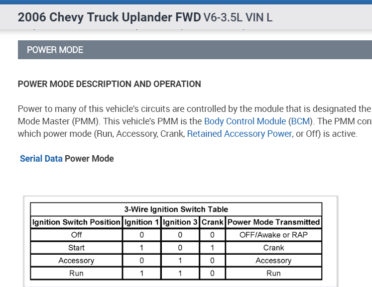

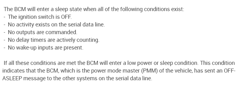

I have included everything I could find on "limp mode" for your vehicle in the diagrams down below. Please go through this material and get back to us with what you are able to find out please.
