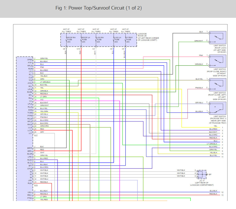

Hi, my sc430 top won't operate and the light on the switch doesn't operate either.

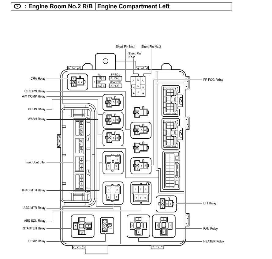

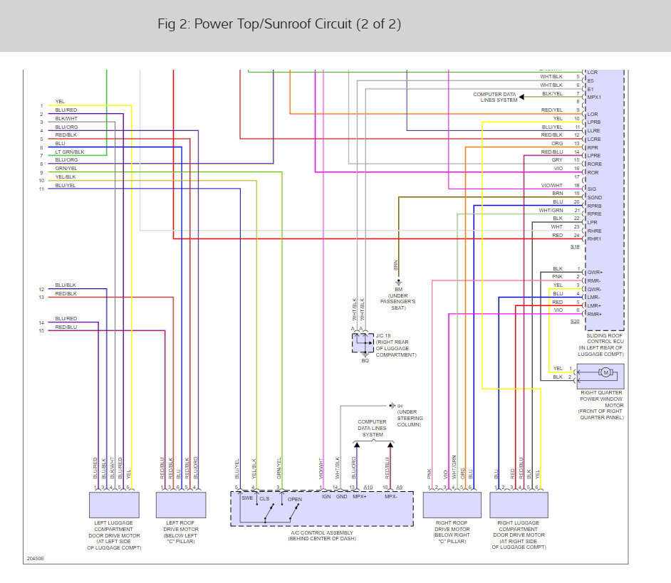

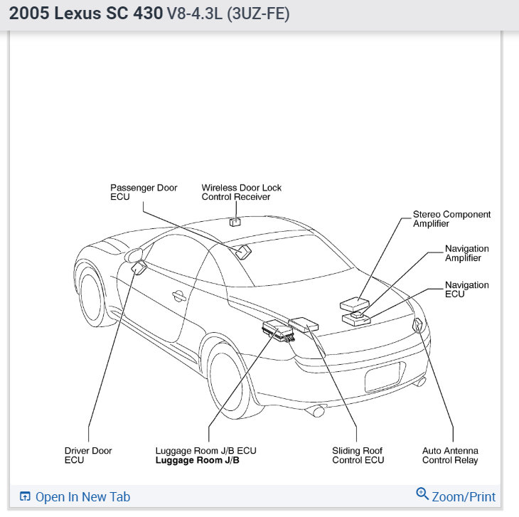

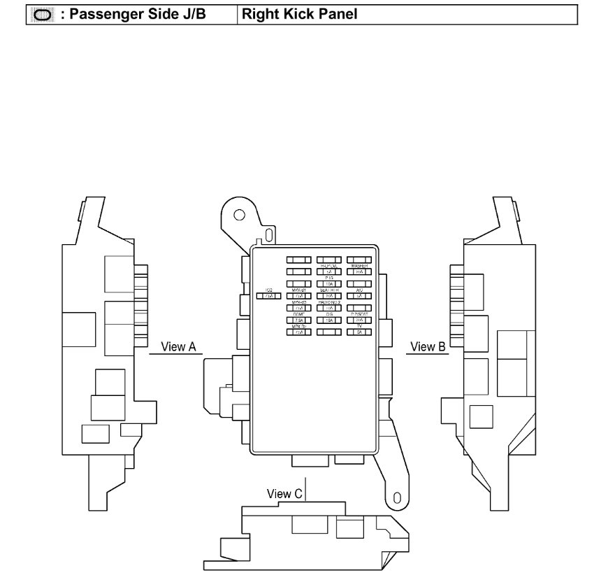

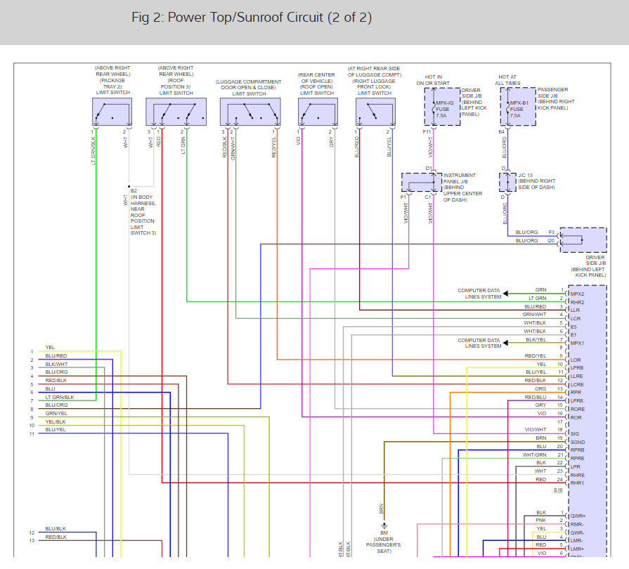

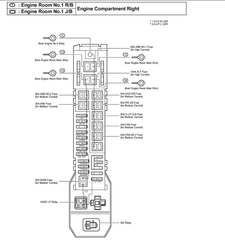

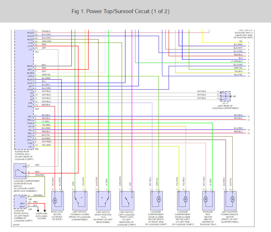

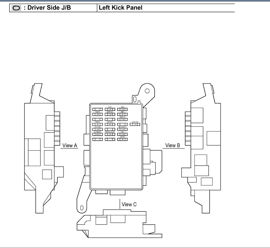

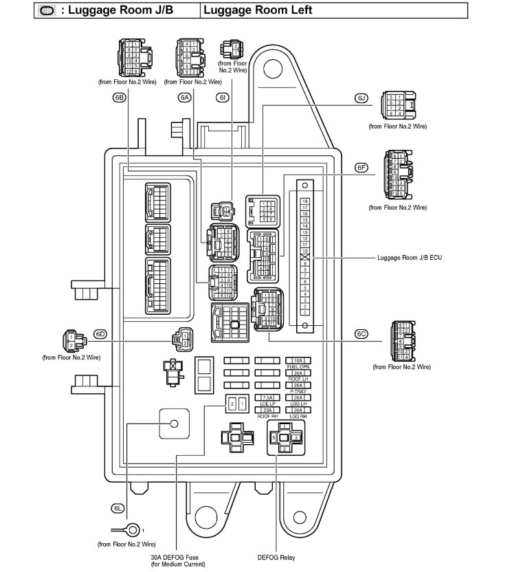

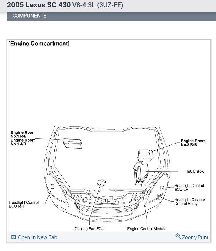

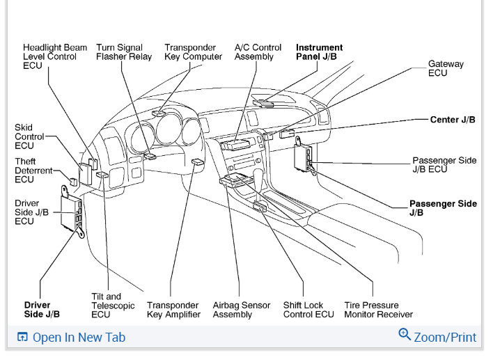

There are five fuses that run the system. here are the convertible top wiring diagrams so you can see how the system works and a guide to help you check for power at the fuses with the fuse locations as well. The fuses you need to check are at the top of the diagrams.
