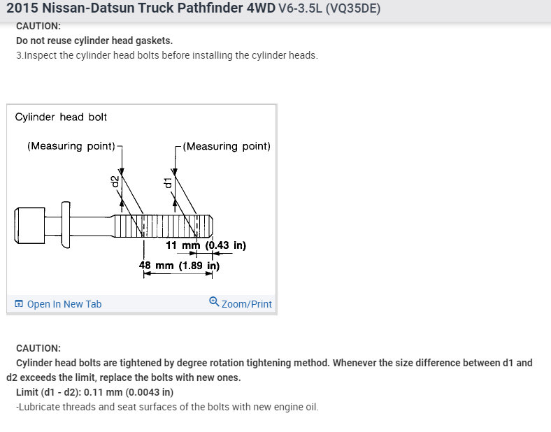

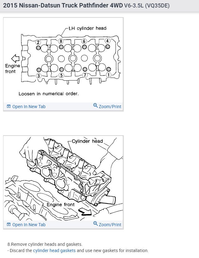

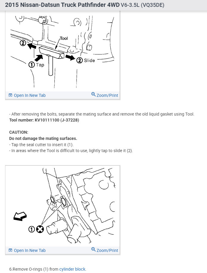

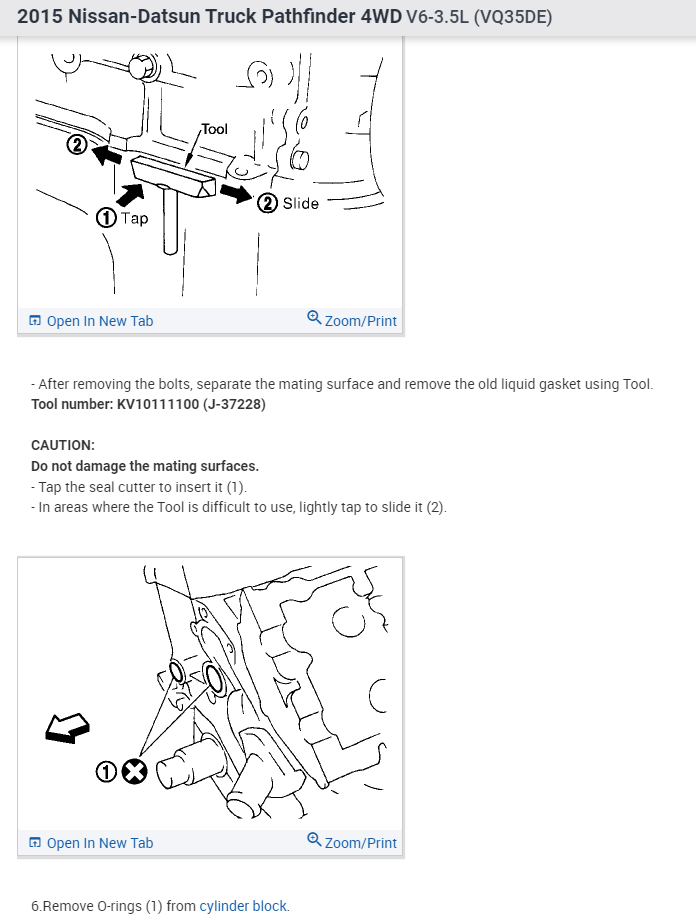

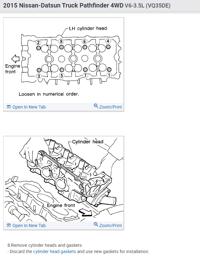

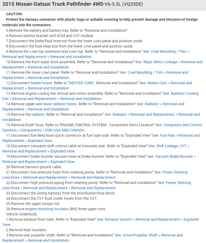

Hi, please i am in need of DIY diagram or video for replacing top cylinder top gasket on 2015 Top cylinder gasket.
Nov 15, 2021 at 9:56 PM
SQM
  • 6,383 POSTS

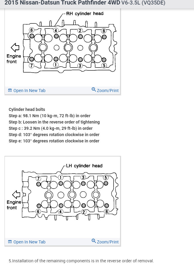

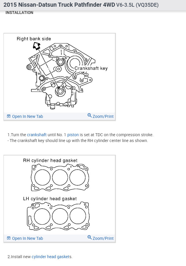

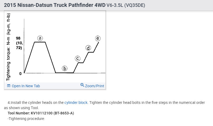

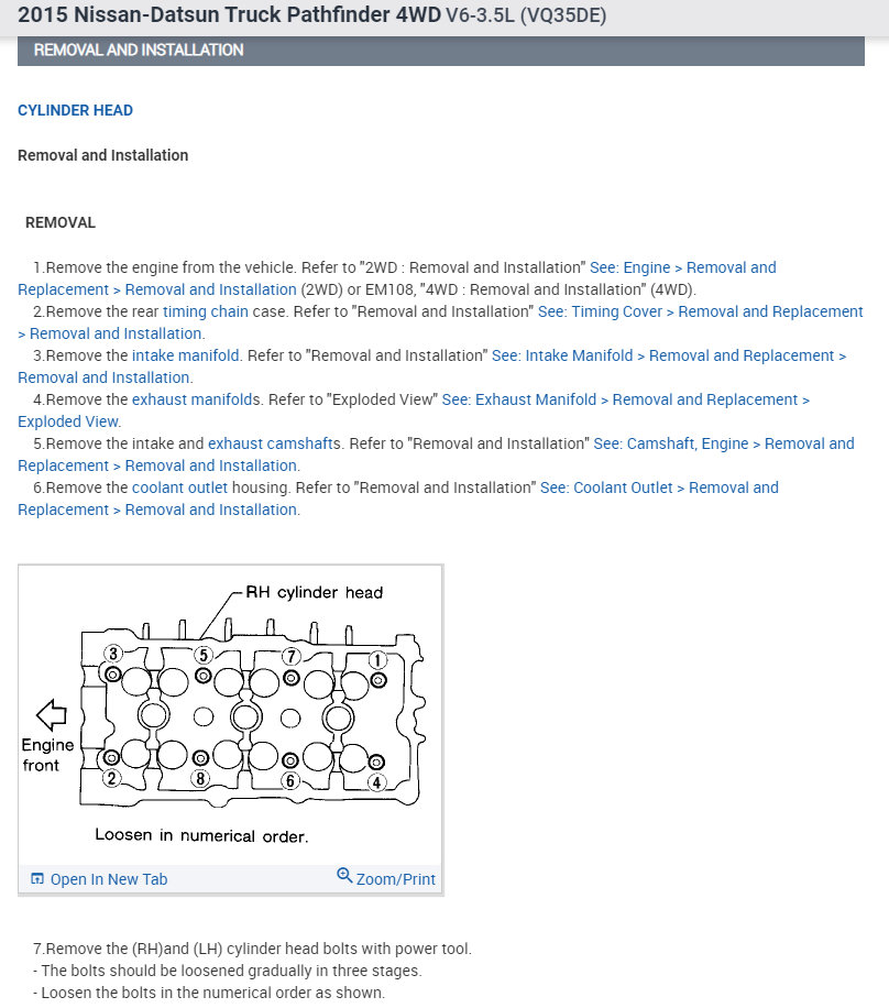

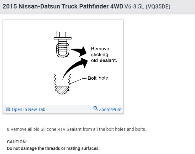

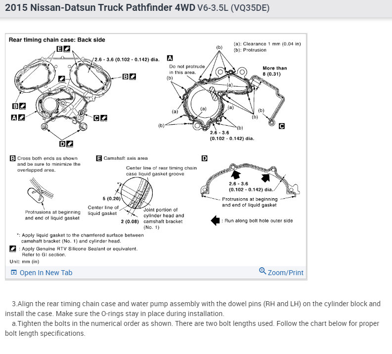

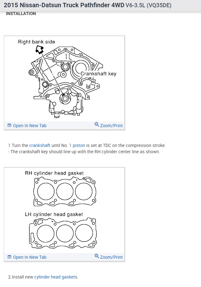

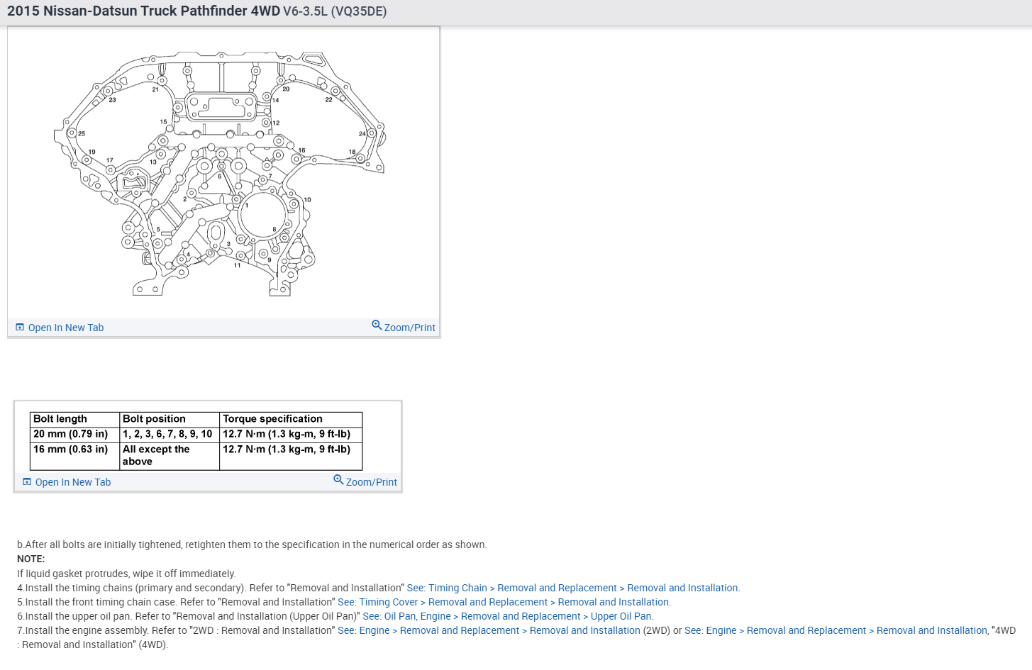

Are you looking for cylinder head gasket replacement instructions?

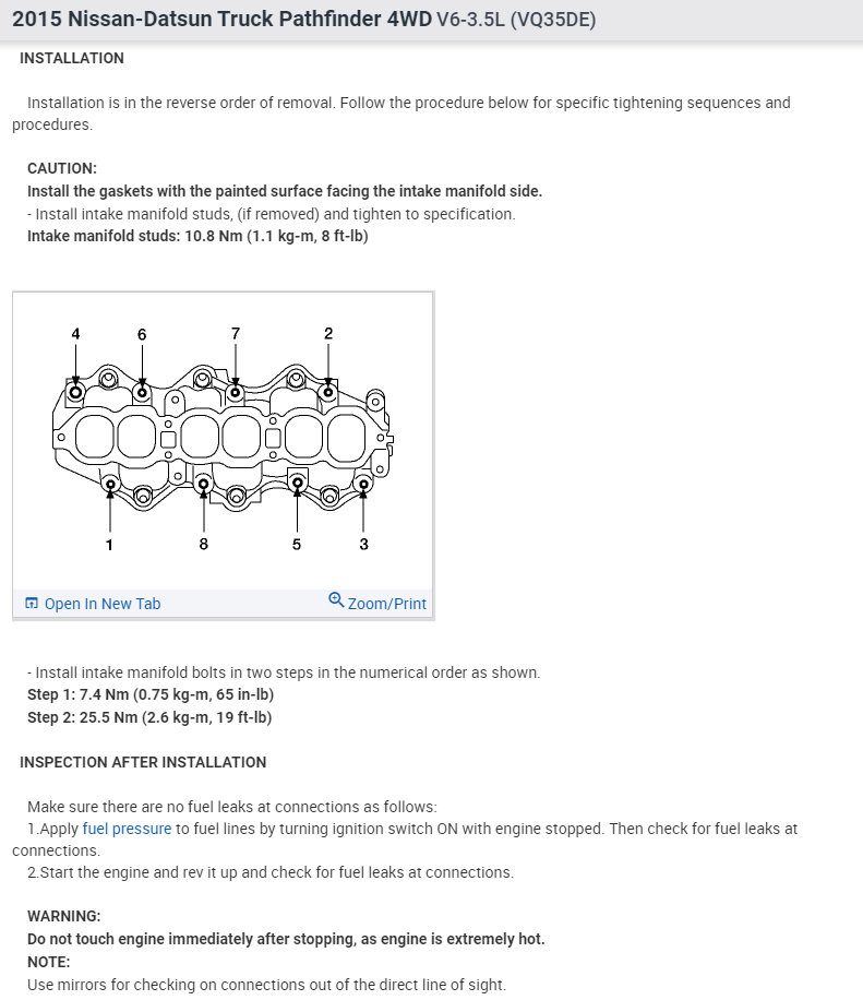

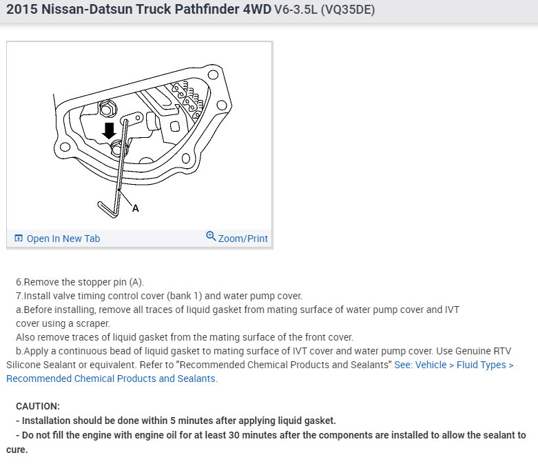

If so, I have attached them below. Includes the torque sequence and specifications.

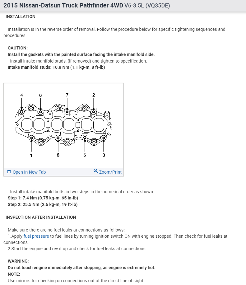

If you are looking for the intake manifold gasket or other component just let me know and I will upload them as well.
https://www.2carpros.com/articles/how-a-cylinder-head-works

Thanks, i also like to know if i have to take out the radiator and cooling fan? Please if i can have a guide diagram to dismantle the engine and remove from the car. I do appreciate you help, it has been helpful as always.

So, you are replacing the head gasket, right? There are several components needs to be removed before hand. I just want to make sure I provide you with the correct information.

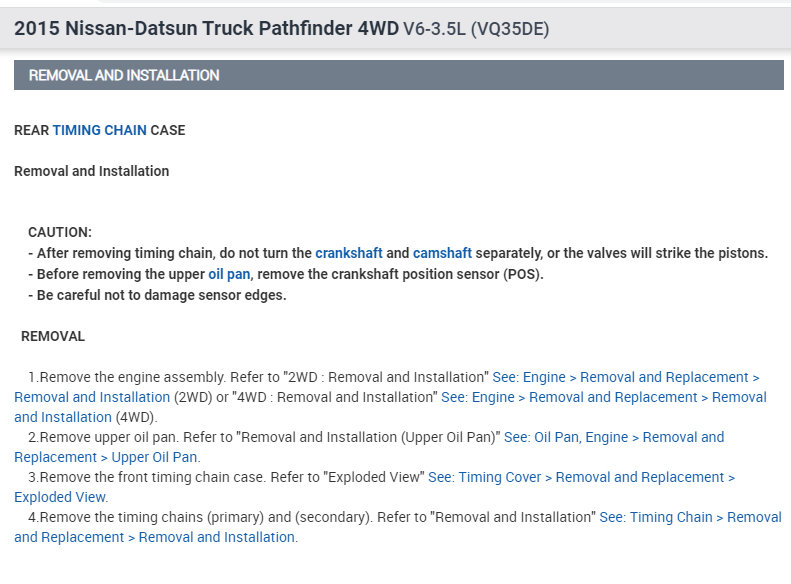

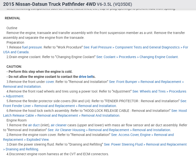

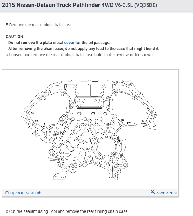

SQM
  • 6,383 POSTS

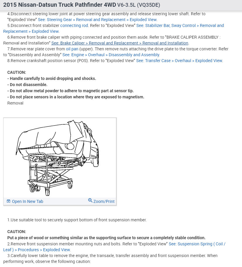

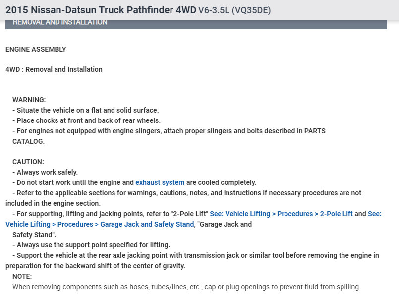

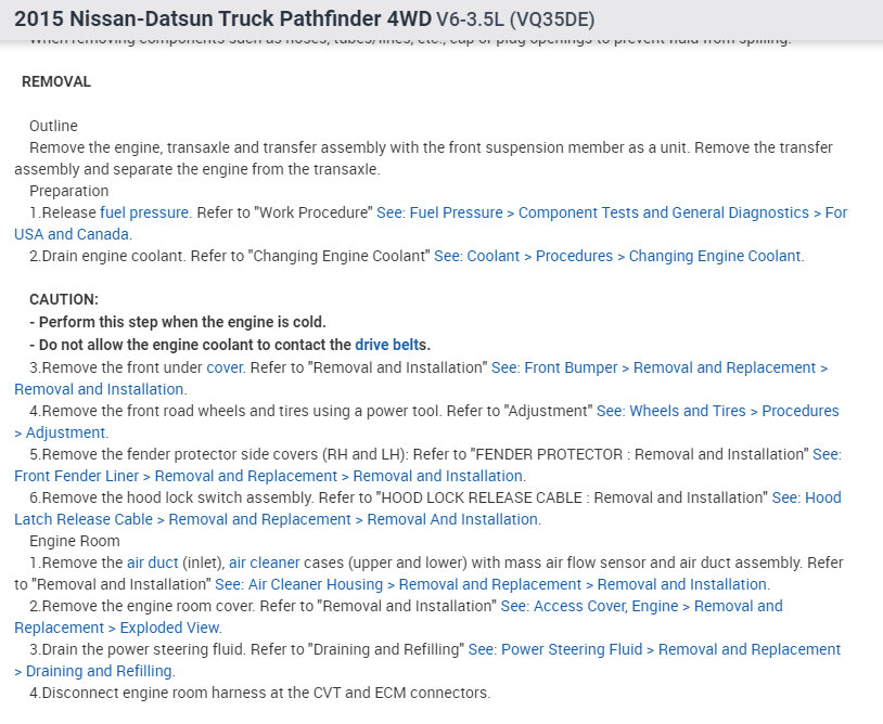

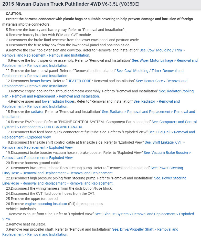

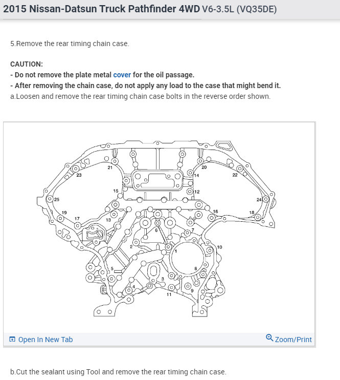

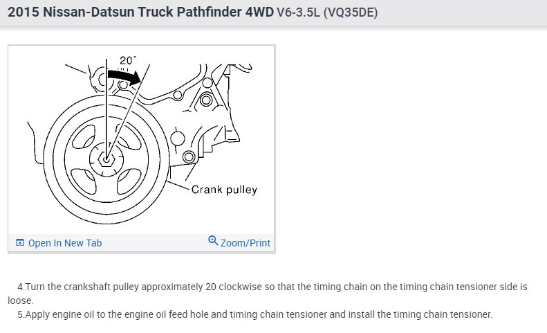

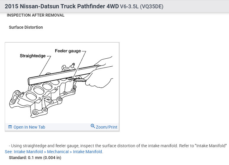

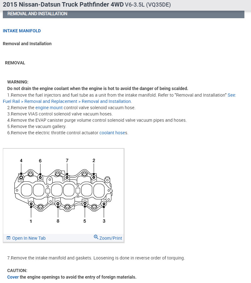

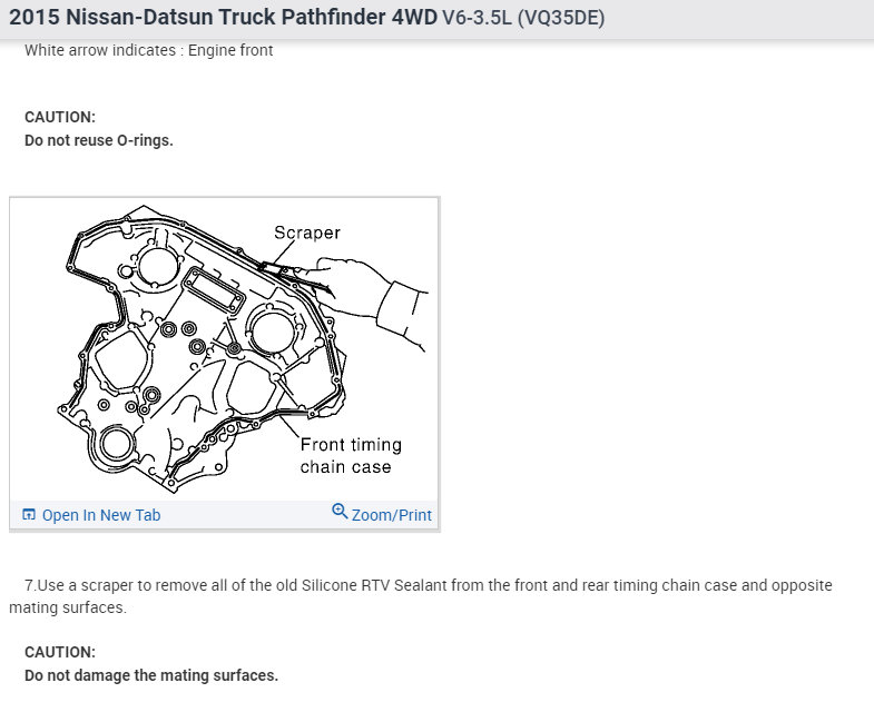

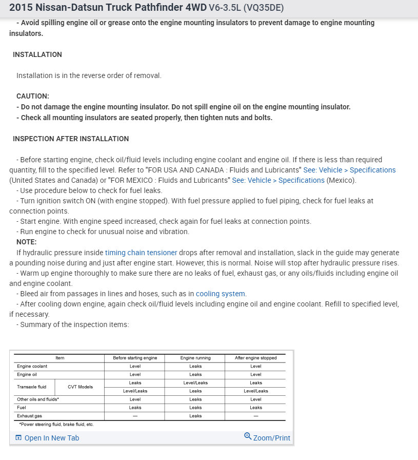

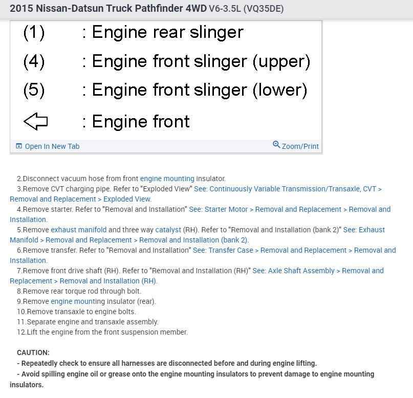

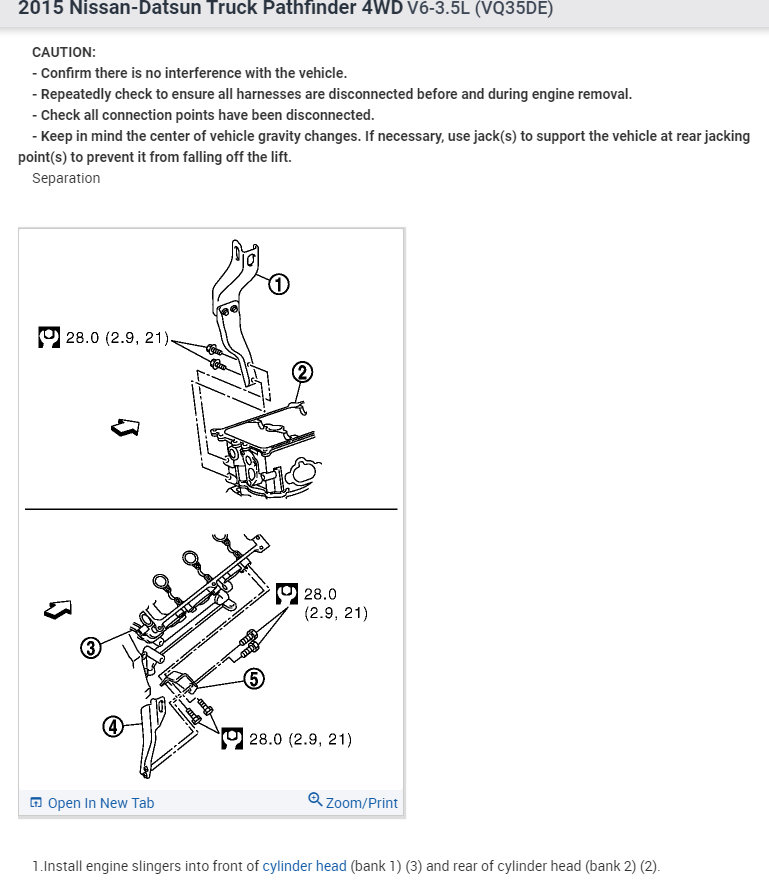

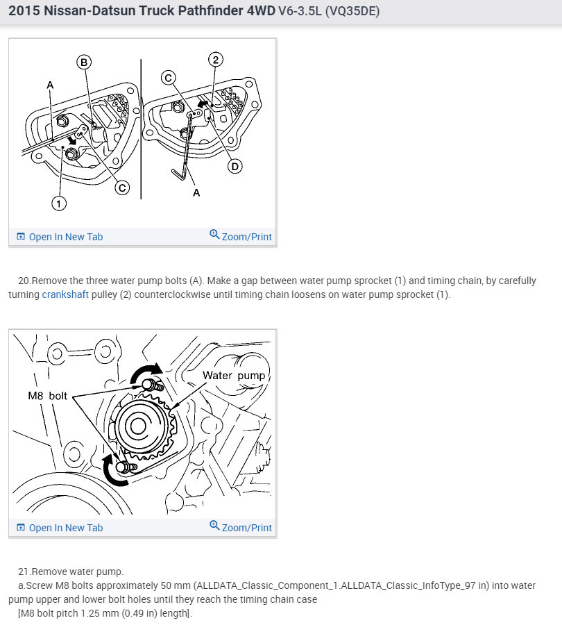

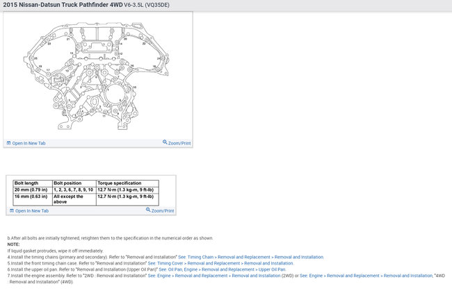

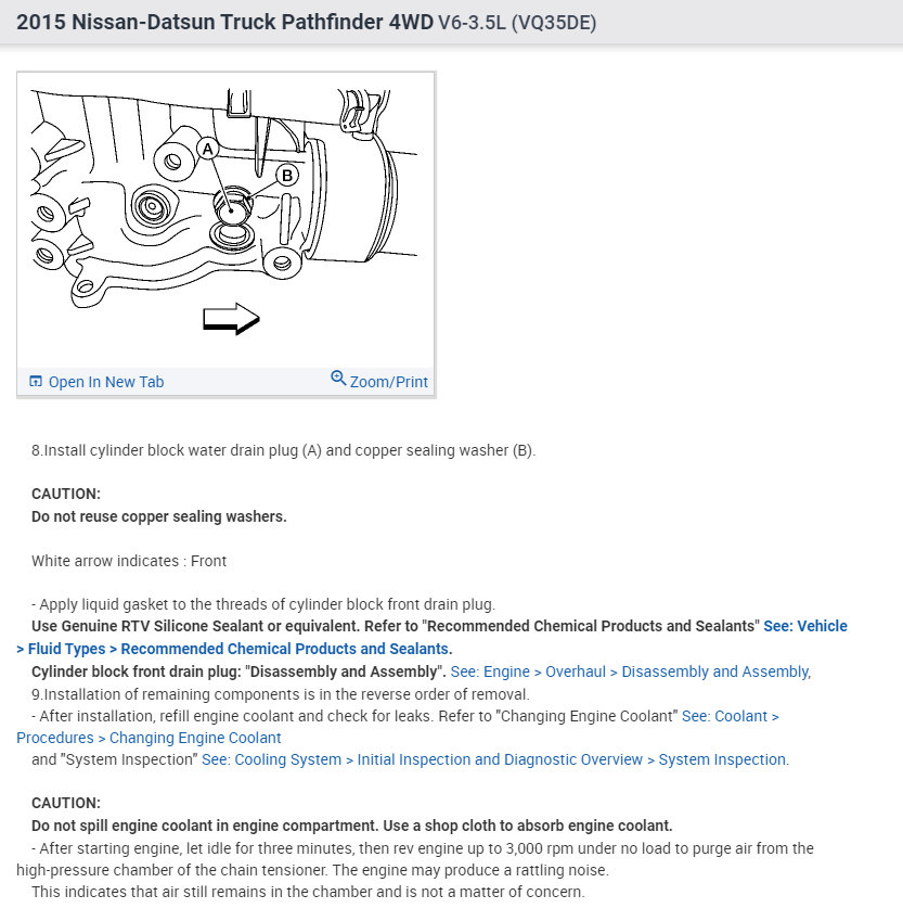

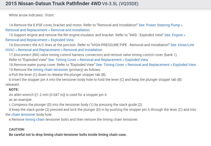

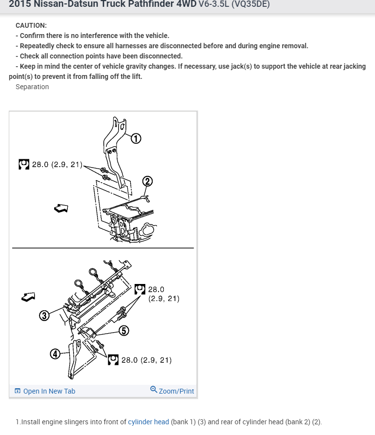

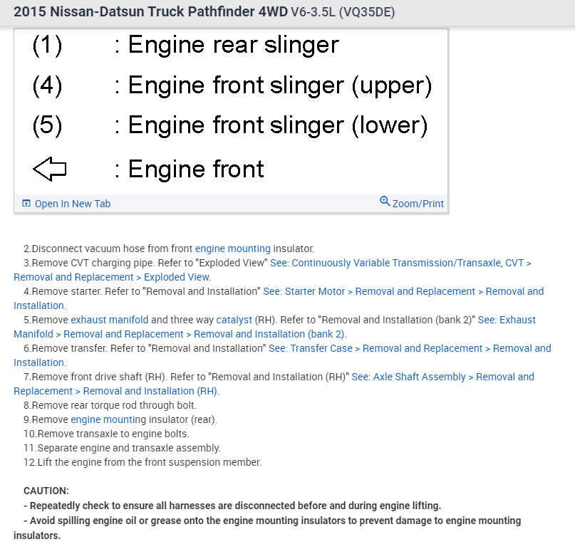

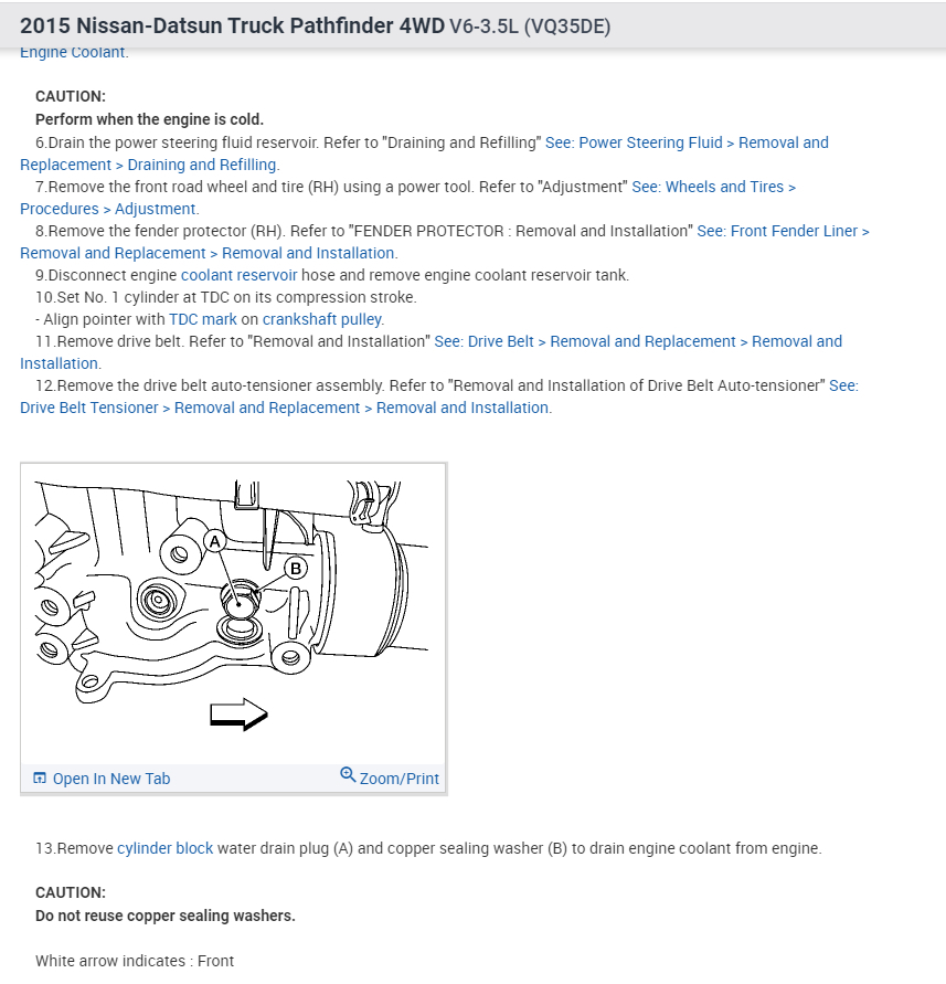

In order to replace the head gasket, the engine needs to be removed, then the rear timing cover, intake and exhaust manifold.
I have attached the engine removal steps and few other diagrams below.
Look thru the engine removal steps, there are quite a bit sub section to this. If you are not sure about any of them just let me know and I will upload any specific removal/installation instructions.

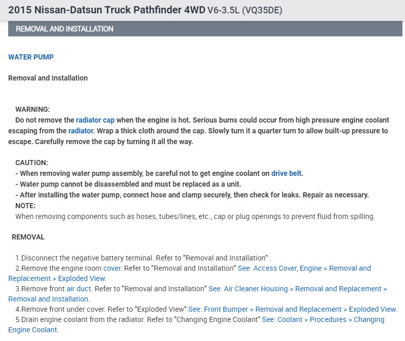

Where is also the location of the water pump?
Nov 18, 2021 at 7:36 AM

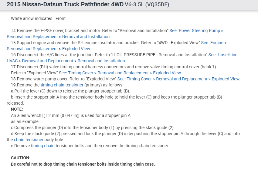

SQM
  • 6,383 POSTS
I think a good step would be to test to see if you have a head gasket leak. Typically blown head gasket will lead to white smoke out of the tailpipe and the oil would be milky in color.
Take a look at this video, it covers on how test for head gasket leak:
https://youtu.be/5zpNjYmmiYY
Keep in mind that the engine can also overheat if the cooling fan does not come on.
Does the cooling fan come on when the engine warms up?

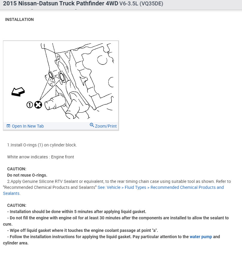

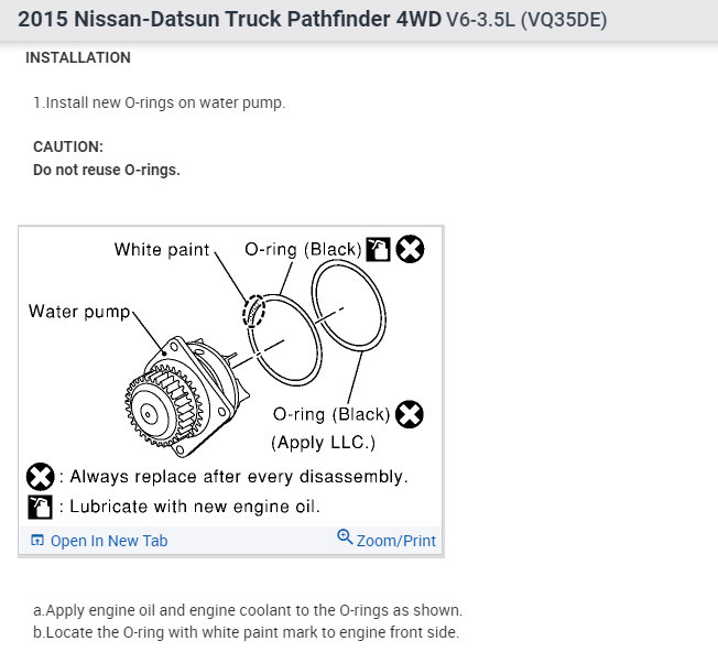

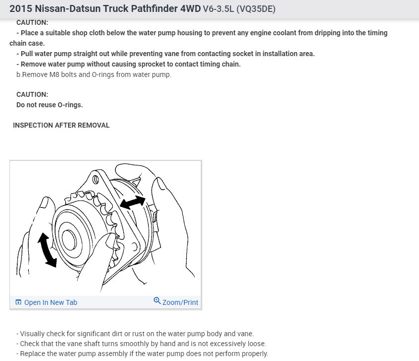

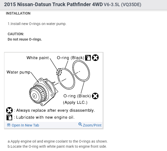

I have attached the water pump diagrams below.
Nov 18, 2021 at 9:16 AM

On the water pump the impeller can fail. This will impact the flow of coolant and can lead to overheating. As the pulley will spin the water pump but it will not move any coolant on the inside.
If it gotten worse after the thermostat, could it be possible that you have gotten a defective thermostat?
Typically, with a stuck closed thermostat, you will have temperature difference between the upper and lower hose. One will be hot and other will be noticeably cooler. This indicates the coolant is not flowing properly.

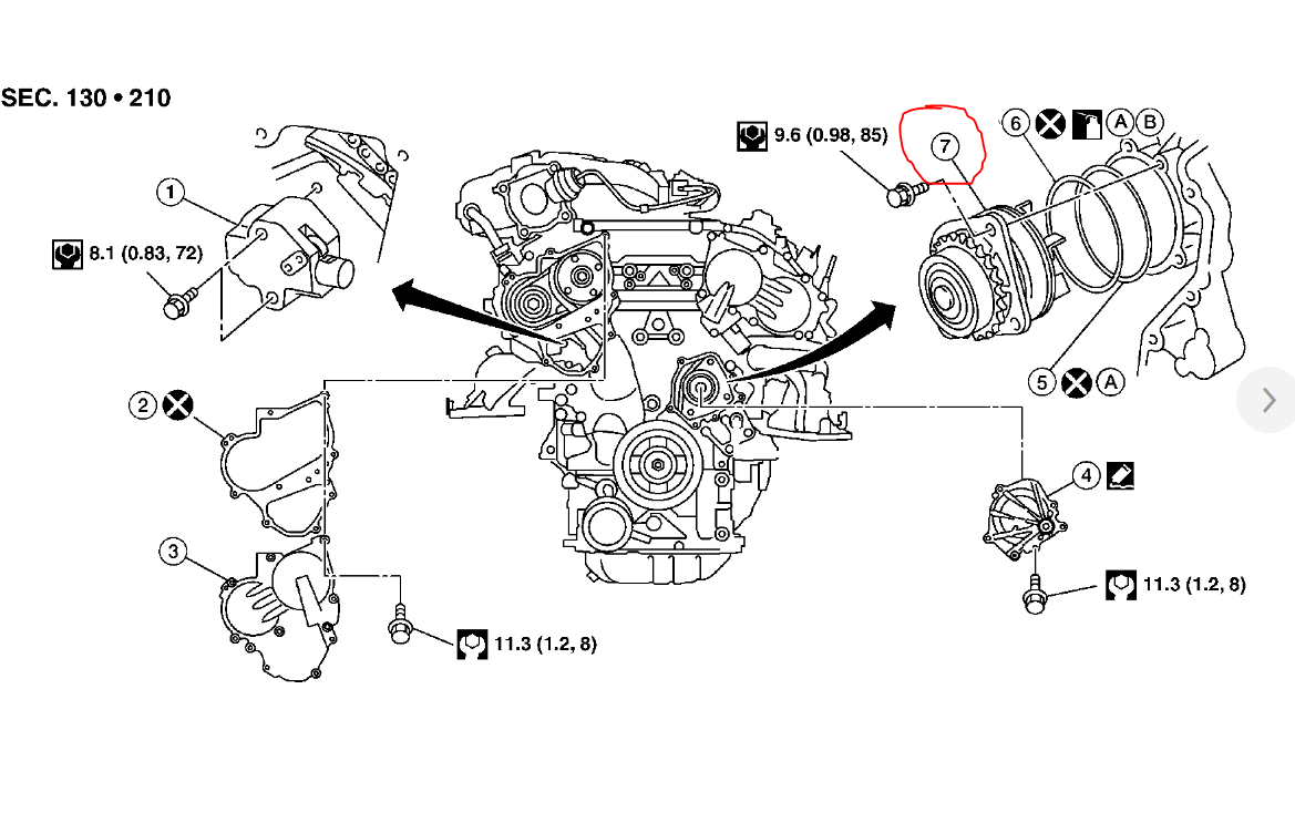

I had water leaking out from the thermostat housing, then I had not removed the thermostat, so if the water pump is beside the thermostat housing, could the water be coming from the water pump of the hose which fits into the head of the thermostat housing.
Nov 19, 2021 at 5:56 AM
SQM
  • 6,383 POSTS

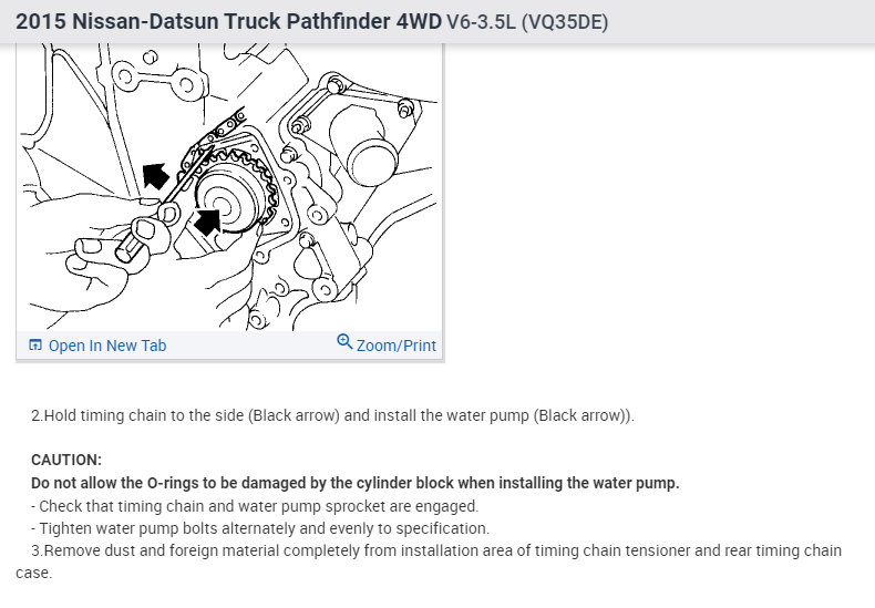

The water pump is located about the center point of the engine.
Take a look at the diagram below. It is number 7.
Just having a leaking thermostat or water pump does not mean it will overheat, unless of course the coolant level goes too low.
Can you actually see if there is any leak below the water pump?
Nov 19, 2021 at 6:01 AM
ANDRIN ATEM
  • 414 POSTS
From this diagram this is close to the thermostat housing were the water host fits in, it was around this area I saw the water leaking.
Nov 19, 2021 at 4:27 PM
SQM
  • 6,383 POSTS
Right, typically when the water pump leaks you will see it around the gasket.
Keep in mind that unless the engine runs low on coolant due to a leak. The leaking water pump will not make the engine run hot.
