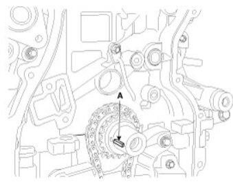

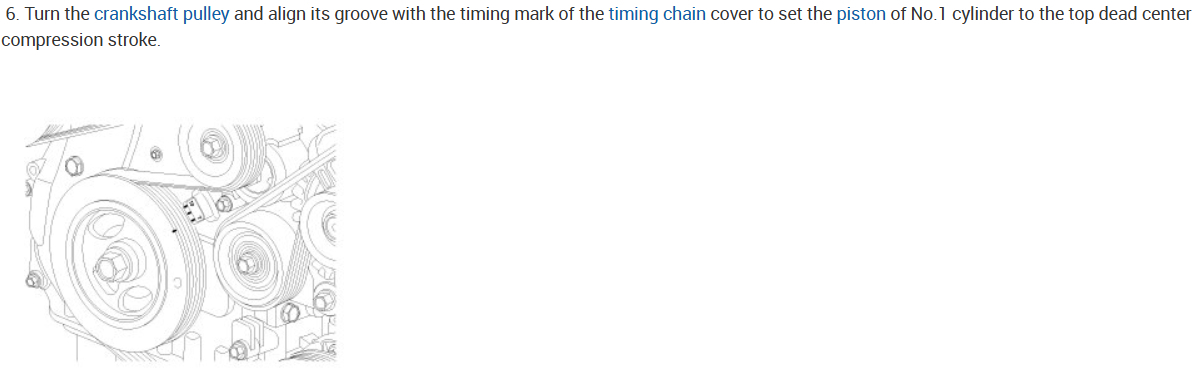

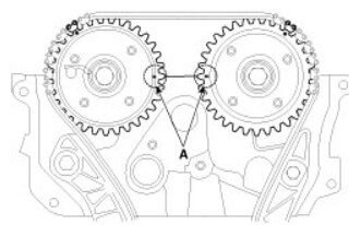

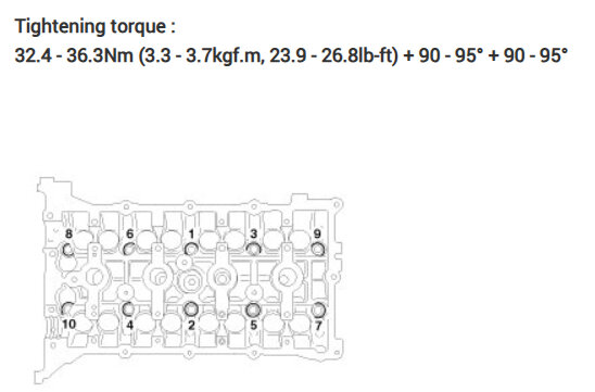

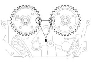

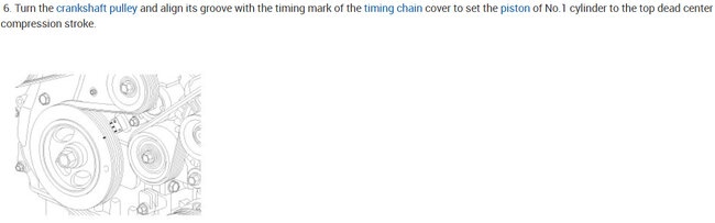

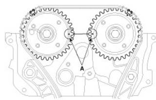

Hi, please help me with the diagram to replace the top cylinder gasket, and how to set the engine on timing.
KNDPBCA23B7104034
Jul 29, 2025 at 4:38 AM
  • 55,423 POSTS
Hello ANDRIN,
Okay, it looks like there are two reference marks for the timing, one is on the timing chain while the other marks are on the gears. Here are the diagrams needed to reinstall the time chain and the cylinder head torque specs and sequence. Check out the images (below). Let us know if you need anything else.
