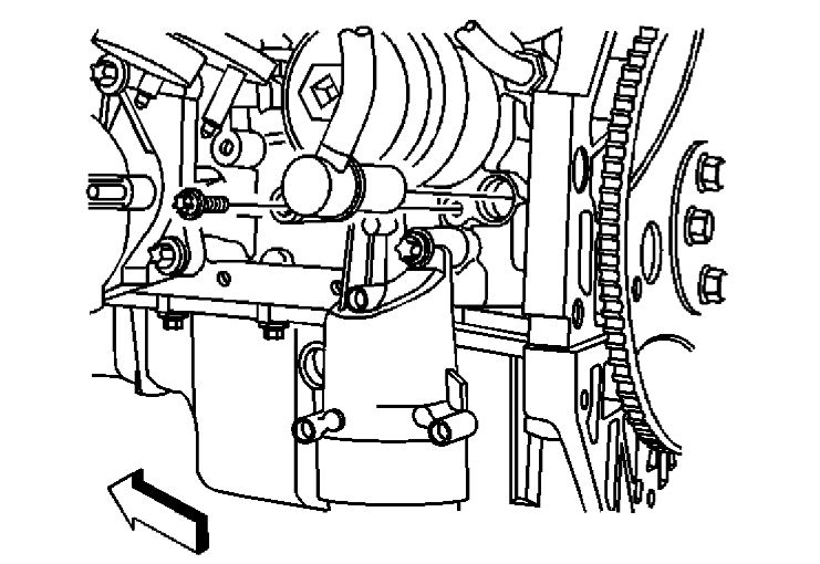

What tool is needed to remove crank position sensor?
Dec 28, 2019 at 6:13 AM
Good evening,
It is located at the back of the motor behind the oil filter. I attached a picture for you. You need a 8mm or 10mm socket with a 3 inch extension and a ratchet for the removal. Follow the harness to the connector. It does go to the top of the motor.
I attached a YouTube video for you as well.
