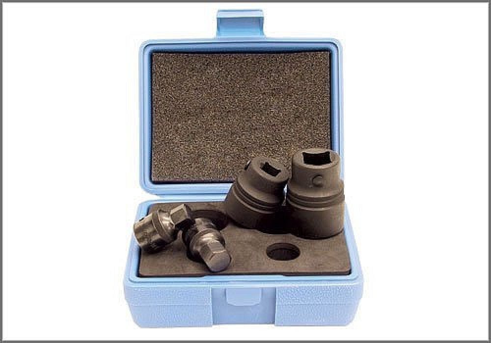

Which bolts are you referring to? There is a kit that VW offers. Here are the tools that come with it. Take a look through it.
https://youtu.be/Cm3ZCw0_MLo video

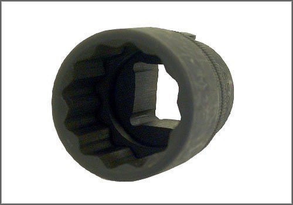

VW/AUDI AXLE NUT SET - AST TOOL # 6500
VW/Audi Axle Nut Set
Picture 1
Picture 2
Picture 3

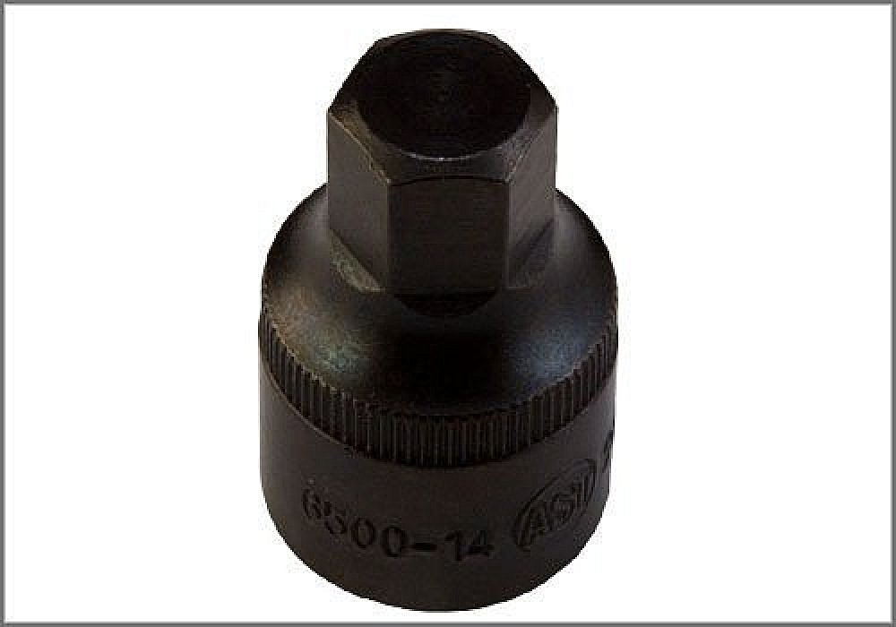

VW/Audi axle nut set. Contains:6500-14, 6500-17, 6500 X-30, and 6500 X-32.
- 14mm allen for VW Passat 1996-2001, Audi A4; front and rear axle bolts (AWD)

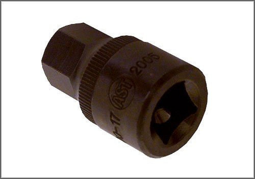

- 17mm allen for 1998-2005 VW Passat, 1999-2004 Audi A6, 2002-2005 Audi A4; front and rear axle bolts (AWD)

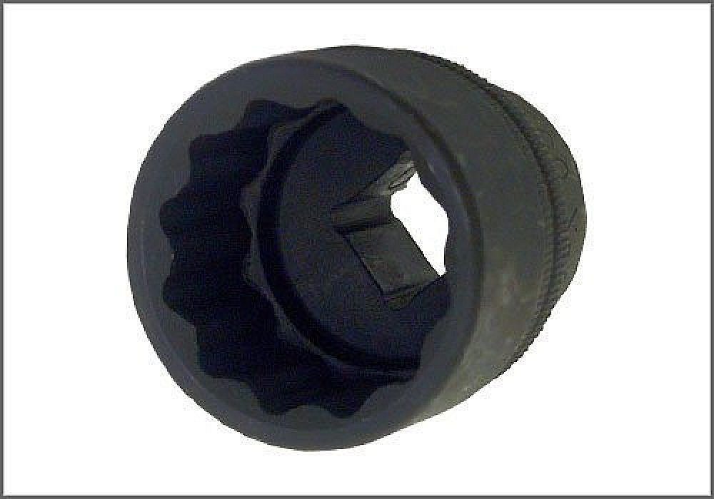

- 30mm 12 point socket for mid 1999-2005 VW Golf, Jetta, Cabrio, and Beetle; front axle nut
- 32mm 12 point socket with a 3/4" drive, VW Touareg; front and rear axle nuts
Contact AST for pricing.
Assenmacher Specialty Tools
1-800-525-2943

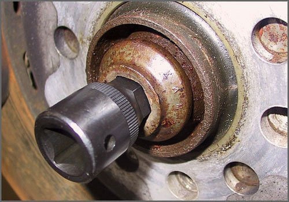

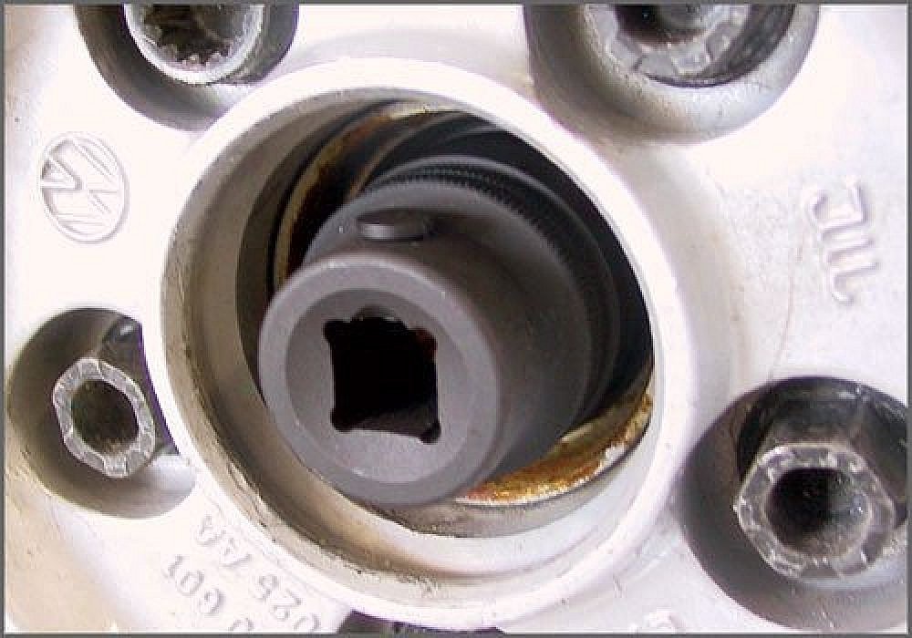

This Kit Contains the Following Tools:
Picture 4
6500-14 - 14mm Allen Socket
Picture 5
6500-17 - 17mm Allen Socket
Picture 6
6500 X-30 - 30mm, 12-Pt. Socket
Picture 7
6500 X-32 - 32mm, 12-Pt. Socket

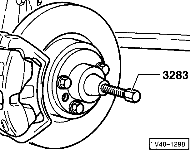

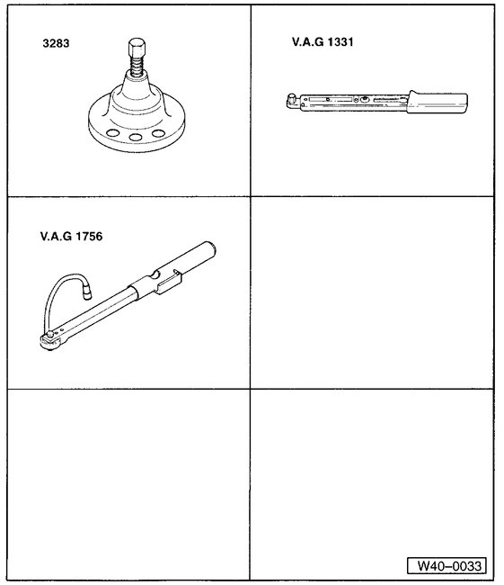

Special tools and equipment
Picture 8
- 3283 hub puller
- VAG1331 torque wrench
- VAG1756 angle measuring wrench

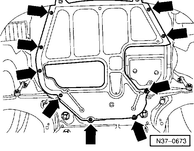

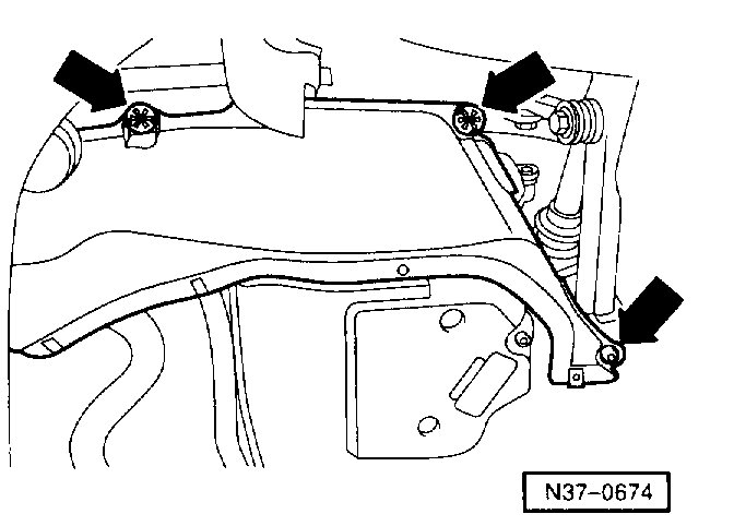

- Remove noise insulation panel (arrows).
Picture 10
- Remove left-side noise insulation (arrows).

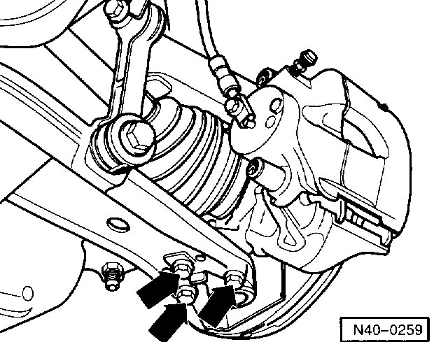

- Mark installation position of ball joint bolts on control arm.
Picture 11
- Remove bolts (arrows).
Picture 12
- Press drive axle out.

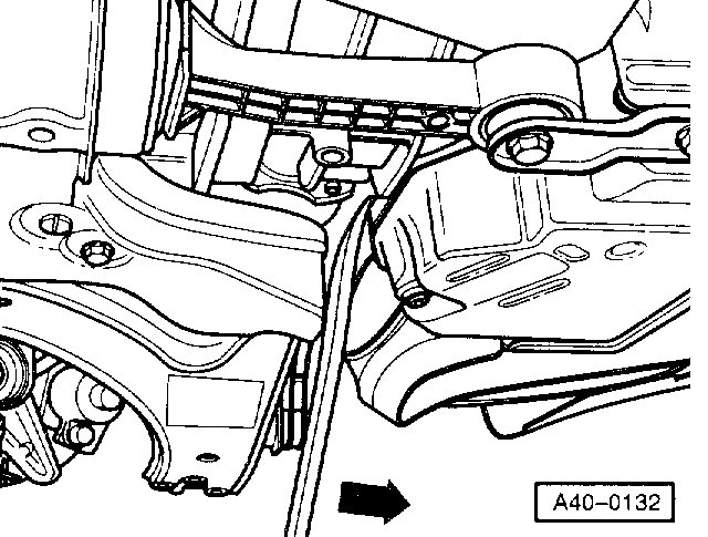

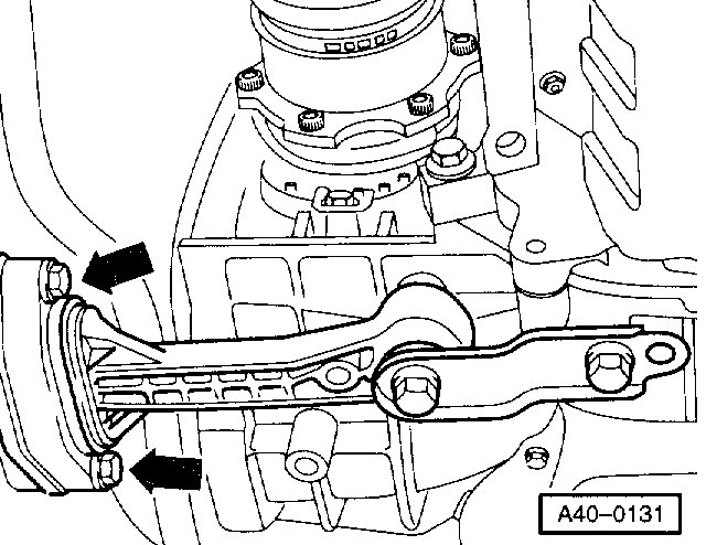

Vehicles with automatic transmission
Picture 13

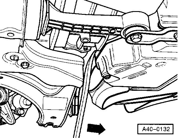

Picture 14
- Push engine/transmission assembly forward (i.e. using lever).
- Remove drive axle.
Note:
- The arrow in the illustration points forward.

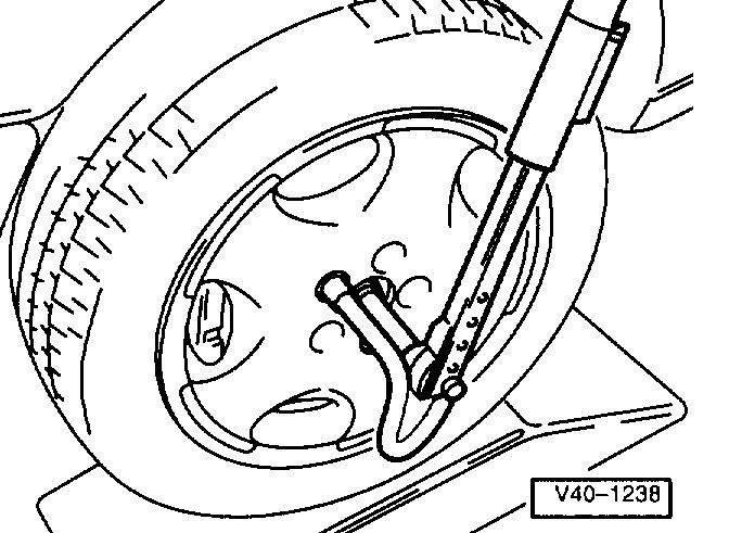

Recommended final tightening of 12-point nut:
- Lower vehicle until wheels touch ground.
WARNING:
- The vehicle must be standing on its wheels when loosening or tightening the 12-point nut. Otherwise there is risk of an accident.
- Tighten 12-point nut to 300 Nm (221 ft. lbs.) and then loosen one turn.
- Tighten 12-point nut to 50 Nm (37 ft. lbs.).
Picture 15
- Using VAG1756 angle measuring wrench, tighten additional 1/12-turn (30°)

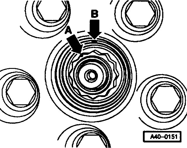

Alternate final tightening of 12-point nut (if angle measuring wrench is not available):
CAUTION:
Picture 16
- Mark point on nut with line (arrow -A-).
- Mark 2nd line (arrow -B-) on edge of wheel hub above next point.
The distance between each point is 30°.
- Tighten 12-point nut until both lines align.

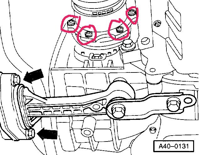

In the top part of picture 13 there are axle screws or whatever they are called. I can't get them out because they are stuck. Any suggestions on how to get it unstuck?
Jan 21, 2019 at 2:45 AM
  • 110,244 POSTS
Most likely, they aren't stuck but just tight. Honestly, I always use an impact gun to remove them. Do you have access to a compressor and impact gun? Is it the triple square bolts?

Yes, it's the triple square bolts. I've already used a impact gun and it just stripped the bolts. I bought a blow torch to see if I can get it loose.
Jan 21, 2019 at 9:58 AM
  • 110,244 POSTS
Those bolts have enough head on them that you should be able to get a good pair of vice grips on them. Try that.

SDONIELB
  • 11 POSTS
I was never able to get it off. The bolt extractor didn't fit and the voice grips didn't work either. I can't find the right size triple squat or start to fit either.
Jan 25, 2019 at 10:24 PM
  • 110,244 POSTS
Welcome back:
Any one that I ever removed was a 10mm triple square. Explain what is happening. Are the bolts already stripped?
Jan 26, 2019 at 9:39 AM
SDONIELB
  • 11 POSTS
They must be. I can't get anything in there
Jan 26, 2019 at 10:54 AM
  • 110,244 POSTS

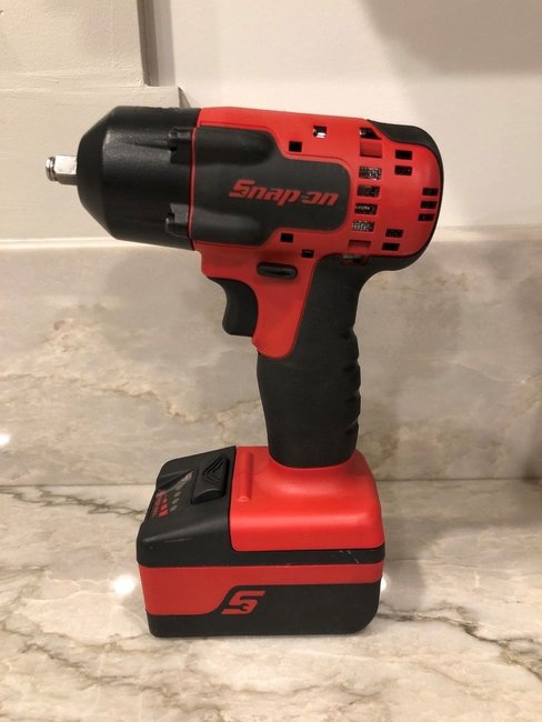

I always use extensions and I have a solid swivel extension that I put the triple square on. With the wheel removed, I go right through the inner fender. You will have to keep turning the axle so you can access one of the bolts at a time. I was taught a long time ago to make the tools do the work, so I usually have about two feet in extensions. LOL I also use a snap on 3/8 impact. Everyone laughed at me when I got it, but it is by far the greatest tool I've ever had. It makes jobs so much easier and faster.
I will tell you that it won't remove the axle bolts. I use an air impact to break them loose, then remove them with the electric impact. I attached a picture of what I am referring to.
Try what I suggested.
Let me know if this helps.
Jan 26, 2019 at 11:33 AM

I have one a 3/8 as well. I've used many sizes on the triple square and can't seem to find one that will catch. I've used many sizes on the star as well and can't find one that will catch. The T30 is too small and the T40 is too big. M8 is too small and the M10 is too big. Can't find the sizes I need. Not even on the internet.
I have many extensions even the 2 foot one lol. I have a beaker bar as well. T30 use to catch, then it stripped 2 bolts. After that I can't do anything with it.
Jan 26, 2019 at 11:53 PM
  • 110,244 POSTS
I know this shouldn't be a torx (star) type bolt, but anything is possible. IF you can wait till tomorrow, I will check my set at work. I know exactly which one I always use because it has much more wear than the other. I swear it is a 10mm. Are you sure the inside of the bolt isn't rusted or have dirt stopping the tool to fit? Also, is there any way you can get a close up picture of them and upload it for me to see?

Just to be clear you are referring to the axle flange bolts I circled correct? Those should be a M10 triple square unless someone changed them or they rusted. They get a lot of crud in them sometimes. It sounds like they may have been loctited in, red will make them almost welded unless you apply heat to them. I would wrap a damp rag around the parts on both sides of the flange, then heat the rear flange, then give the head a good smack with a hammer and either the socket or a swedish pipe wrench or basin wrench style tool that will grip harder as you push on it, most vice grips don't do that and they don't get a good grip on the head either.
