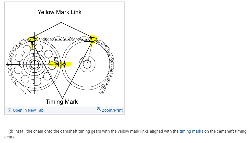

is there a tool to lock/align camshaft timing marks when replacing timing chain for my car?

lock/align camshafts timing marks when replacing timing chain tool.

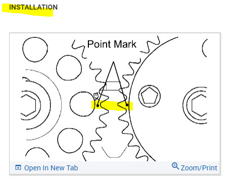

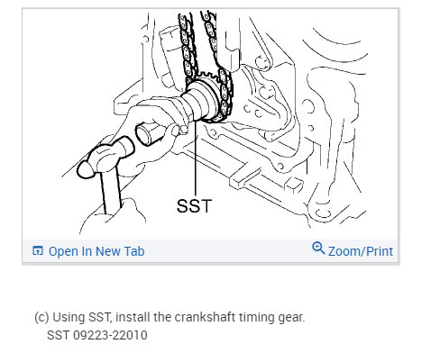

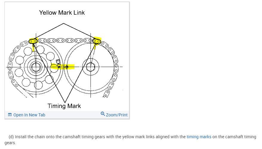

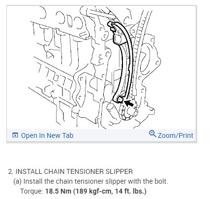

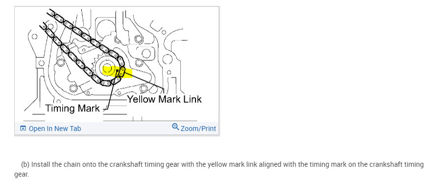

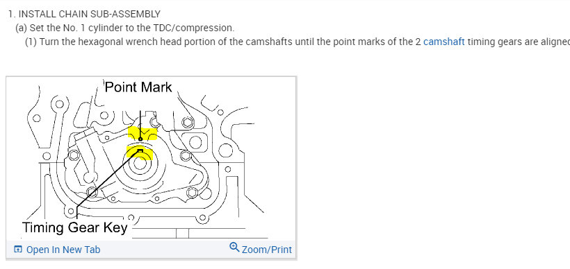

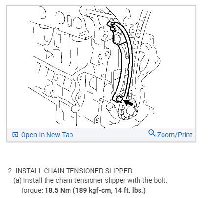

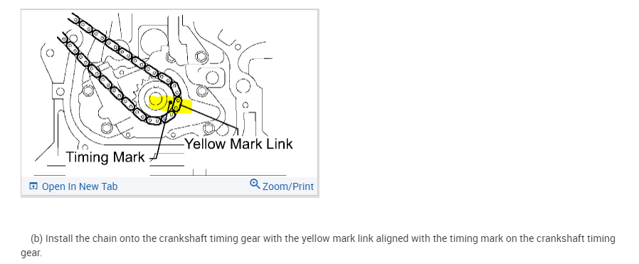

There isn't one for this engine. Timing is done by using marks on the cams and crank gears along with colored chain links.
Take a look at the installation directions I attached below and let me know if they help.
Take care and let me know if you have questions.

I think I was not clear sorry in advance. I am asking for a tool instead to use wrenches that lock the camshafts like that I don't lose the timing marks while I put the chain on.
Jun 13, 2023 at 11:24 PM
  • 110,248 POSTS
No problem whatsoever. As far as a camshaft locking tool is concerned, they don't make one for this vehicle. They make all kinds, but nothing specifically designed to fit this engine.
You may be able to make something that would hold them.

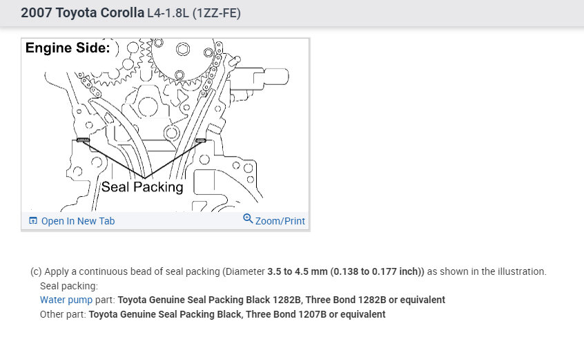

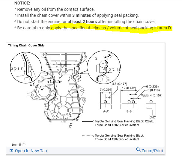

Okay, thank you. Can you tell me the procedure on how to change it and the most important how tick I put the sealer and where.
Jun 14, 2023 at 11:54 PM
  • 110,248 POSTS
The directions are listed above for installation. When you say sealer, what are you referring to? Do you mean the timing chain cover?
Jun 15, 2023 at 4:02 PM
YAZIDAN
  • 141 POSTS

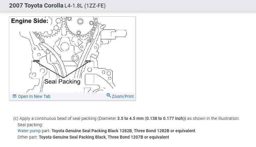

I meant by sealer RTV.
Jun 15, 2023 at 10:12 PM

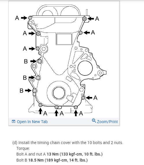

  • 110,248 POSTS
If you look below, I attached the directions showing where to apply the RTV along with the torque specs and tightening sequence.
Let me know if this is what you needed.
Jun 16, 2023 at 12:43 PM
