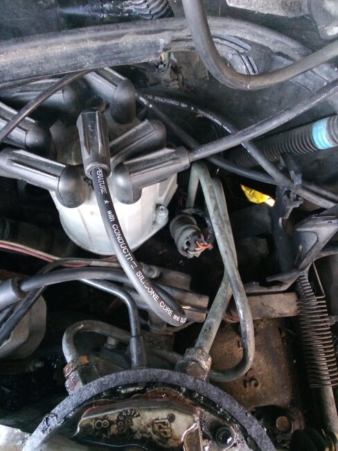

I took the fuel lines off the throttle body and removed it and took it apart and cleaned it. now, it will turn over, but it will not start, acts like it is not getting any fire.

Got spark from the coil the metal fuel lines that hook to the throttle body are right in front of the distributor and I had to move them around a bit wondering if one of them might have moved it or loosened a wire.

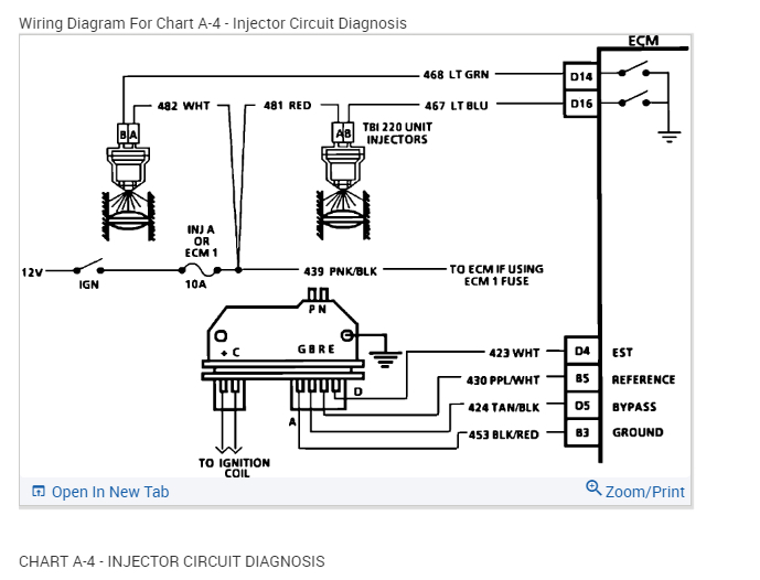

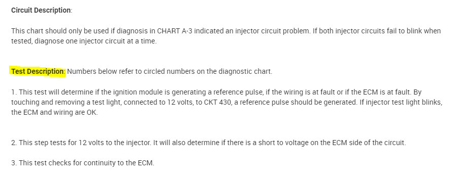

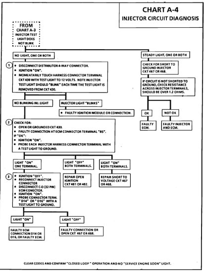

Anything is possible. Each fuel injector is a solenoid-operated device controlled by the ECM.
Do me a favor. I attached diagnostics below related to the injector circuit. Take a look through them and let me know if you are comfortable performing them. This will help determine if there is a possible wiring issue.
