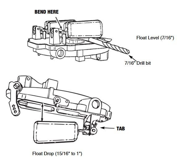

Hi Steve. I just wanted to get back with you. The regulator helped a lot but I still have gas spitting out the top of the carburetor, not as bad as before, but still too much to keep it over filling the carburetor. If you think it might be the float or needle, could you walk me through how to set them correctly? I am just not a mechanic, but I can follow instructions.

On that carburetor you pull the top cover off of the carburetor. You want the gasket to stay with the top. Then flip the top over and measure the space between the float and the gasket. You want 7/16" between the two. Next you turn the part so the float hangs down and measure the same place and you want to see one inch of float drop.
As for the needle, The seat should be screwed in firmly and the needle should seat and block the flow of fuel. I usually test them by applying a light vacuum to the fuel inlet fitting.
It also sounds like you may still have excessive pressure. You want less than 5-6 psi for most carburetors.

Hi Steve. You were right on with the float needing to being reset. I did as you said and it stopped spiting out the top. Also, I put the new regulator on and set it at 5#. It was up to 8#. Now I have my car back and I am loving it.
