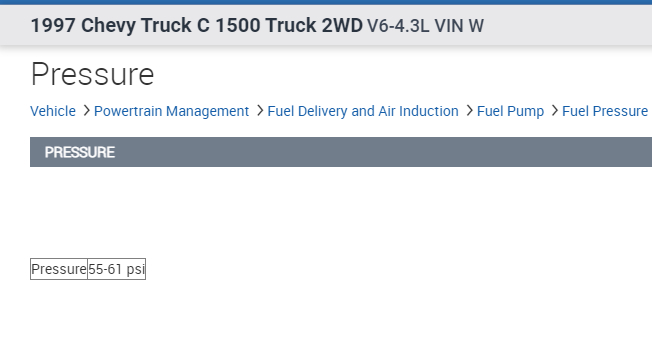

Truck won't start, I have fire and spark but getting too much fuel in the plugs.

The first thing I recommend is to check the fuel pump pressure. You may have a faulty fuel pressure regulator.
Here is a link that explains how it's done:
If you look below, I attached the manufacturer's pressure specifications.
Let me know what you find or if you have questions.
