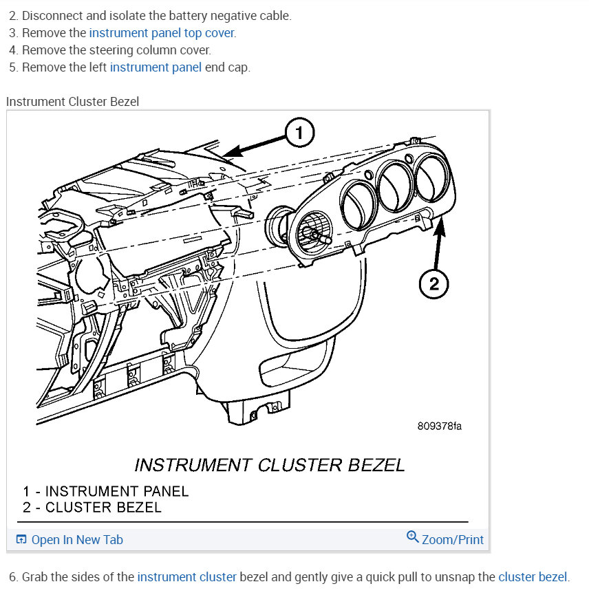

Today While driving temperature light came on and gauge went all the way up then went back to norm while still driving.
In the last few weeks have had the airbag light come on, drove for a long time stop and go and then the oil light started coming on when I hit the brake (yes oil level is fine) and when I don't drive too long it does not do happen. Is there a sensor that just runs all the warning lights and gauges that can be messed up?

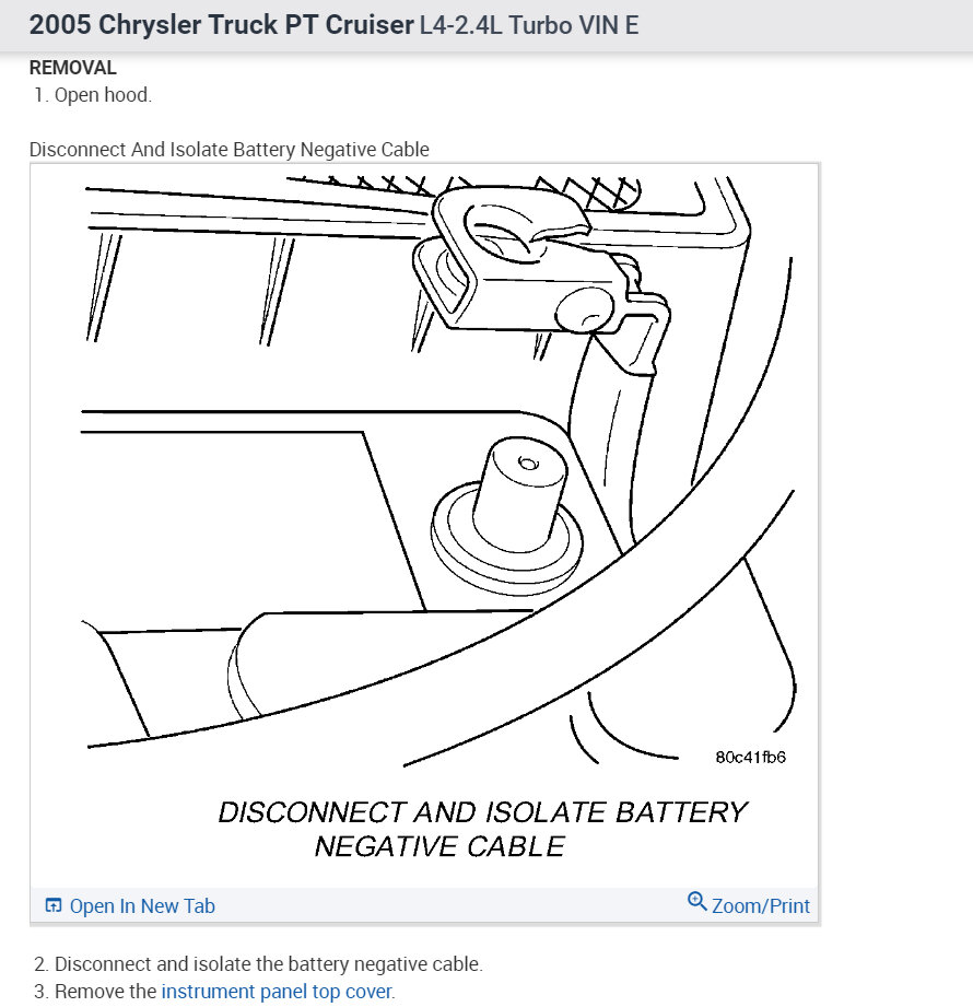

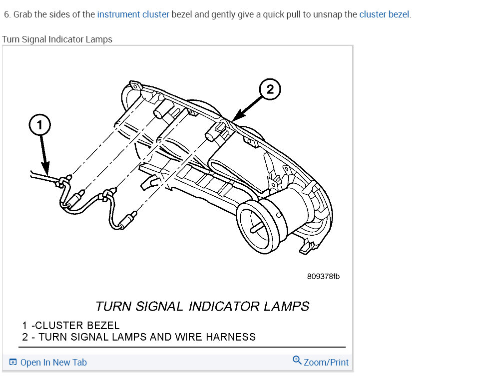

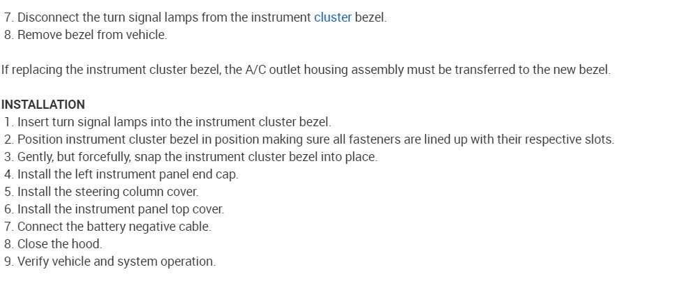

It sounds like the temperature light (cluster) and wiper problems are two different issues. So please start new question for the wiper. We will handle the cluster issue on this post, can I if all these problems happened at once? If so, it sounds like the instrument cluster is going bad or you have a bad connection at the rear of the cluster, here is how to remove it so you can check it out or replace it with a rebuilt unit. Also, you can try a hard system reboot which is done by removing the negative side of the battery, with the cable loose from the negative side of the battery, hold it to the positive terminal for 1 minute this will discharge the memory capacitors in the BCM and PCM allowing the system to reboot. Check out the images (below). Please let us know what happens.

Sorry I don't know why clutch is in there, I corrected my post. I do think the cluster is going out in which case I would manually keep an eye on the engine temperature with an infrared monitor until the cluster is working correctly.

So, the car in shop told bad thermostat and cooling fan not running $1,200 fix so far, then they will check oil pressure. Hopefully it's cheaper.

Oil light when hitting the brakes was just the sensor, we are all back together and $1,300.00 poorer but she's still rolling.
