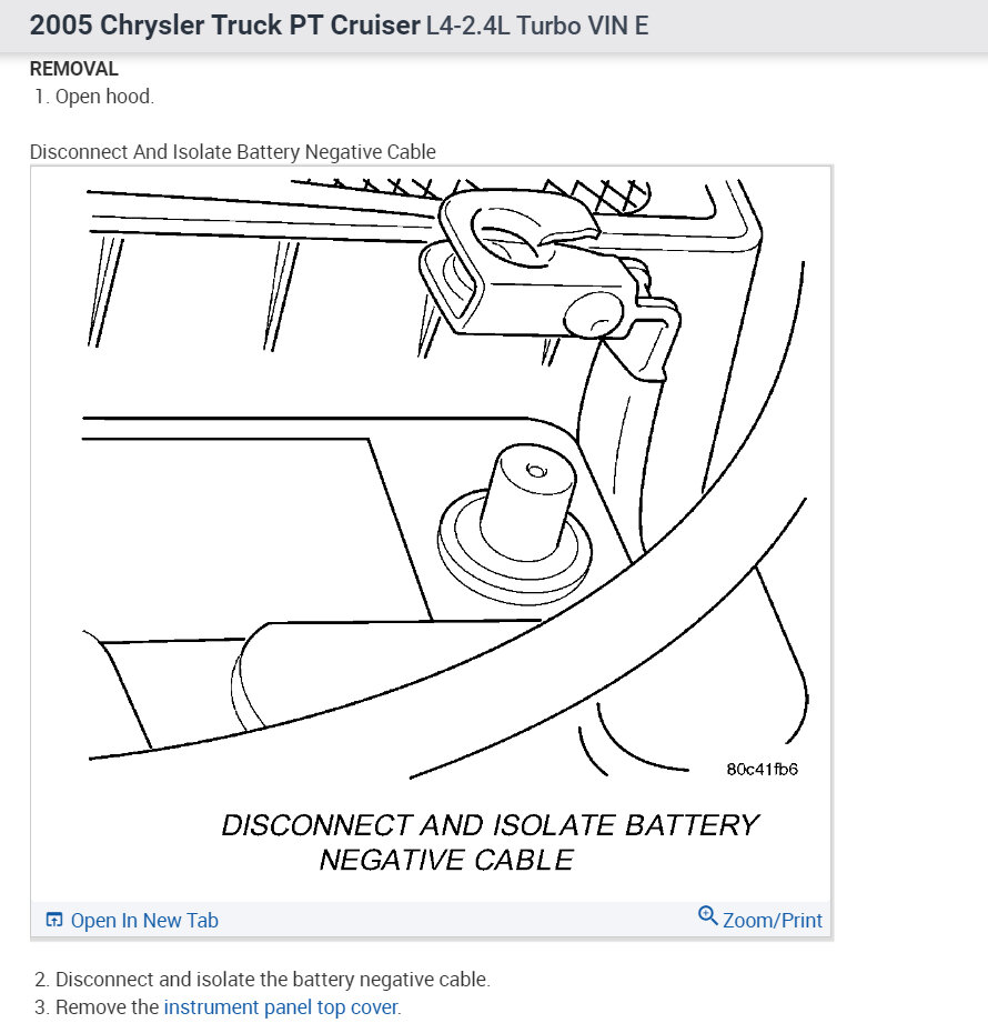

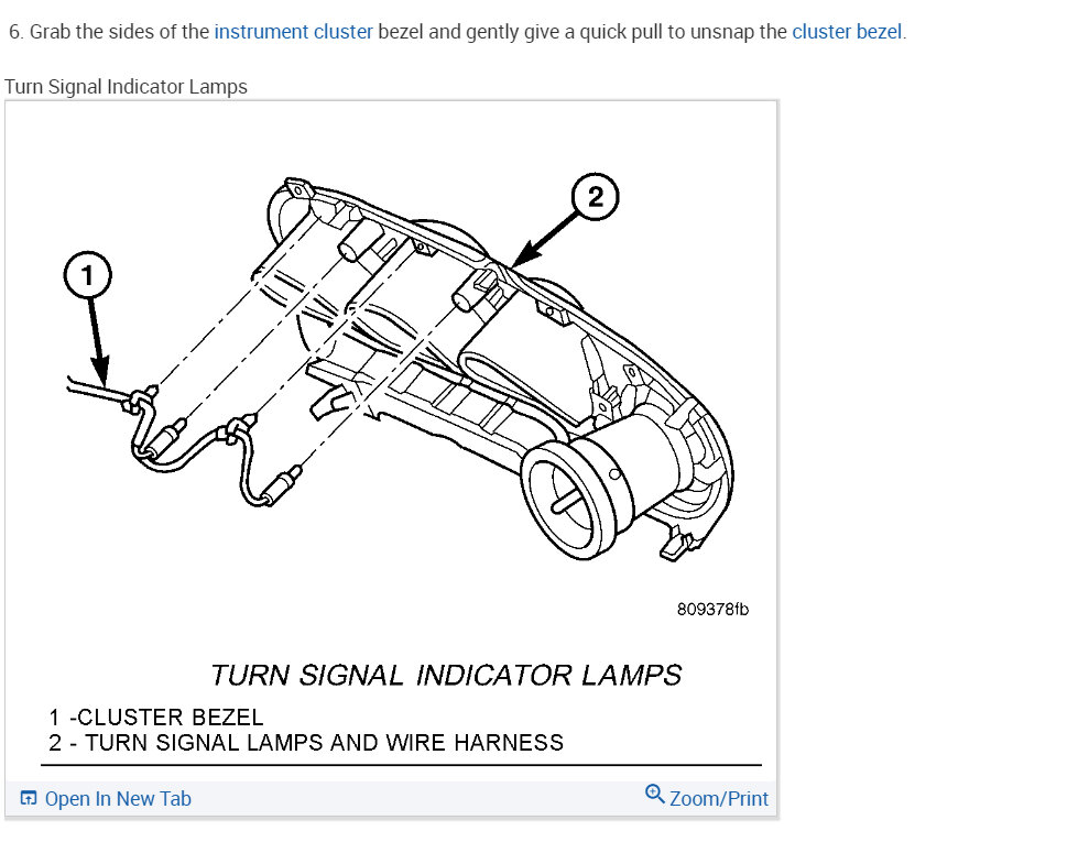

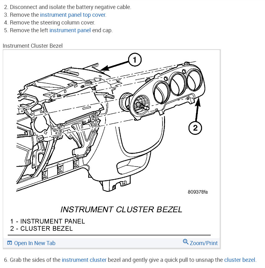

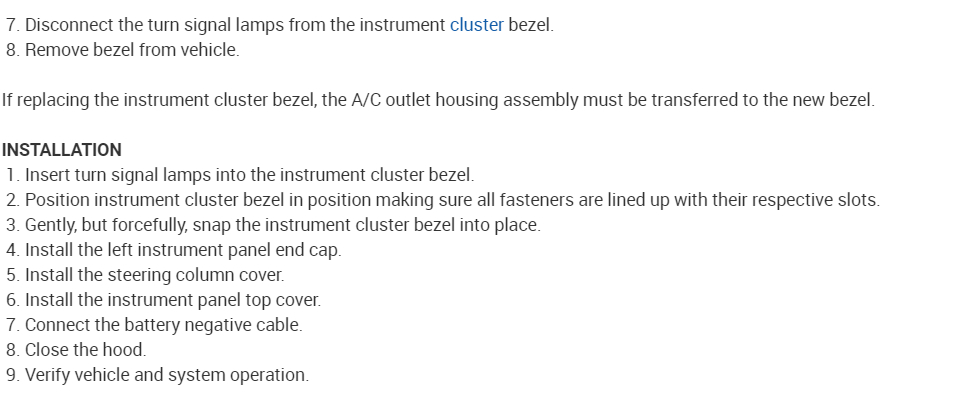

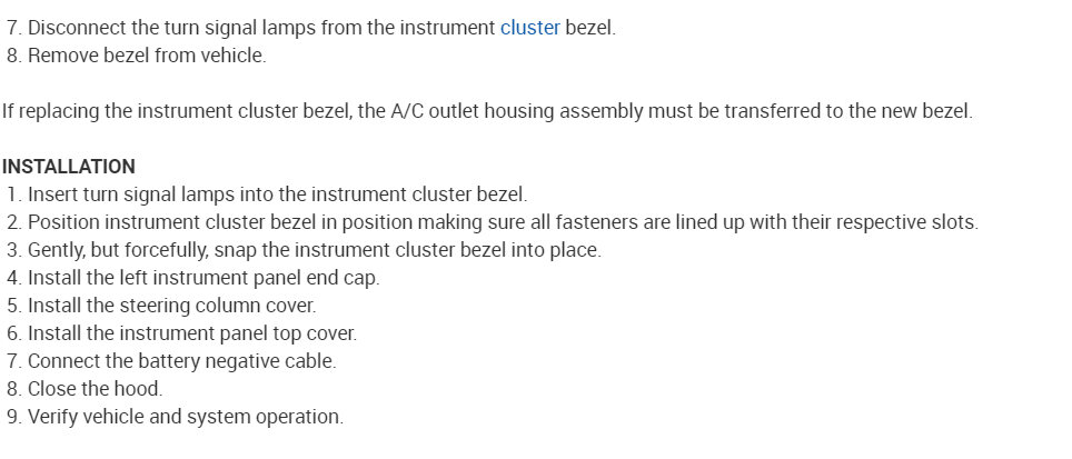

It sounds like the temperature light (cluster) and wiper problems are two different issues. So please start new question for the wiper. We will handle the cluster issue on this post, can I if all these problems happened at once? If so, it sounds like the instrument cluster is going bad or you have a bad connection at the rear of the cluster, here is how to remove it so you can check it out or replace it with a rebuilt unit. Also, you can try a hard system reboot which is done by removing the negative side of the battery, with the cable loose from the negative side of the battery, hold it to the positive terminal for 1 minute this will discharge the memory capacitors in the BCM and PCM allowing the system to reboot. Check out the images (below). Please let us know what happens.
