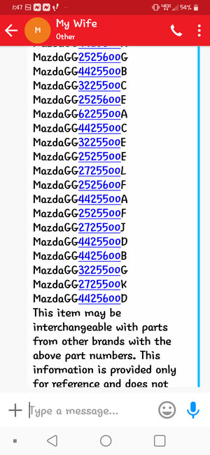

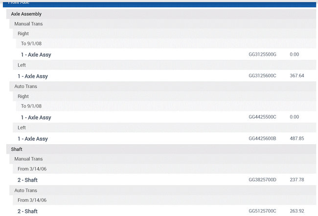

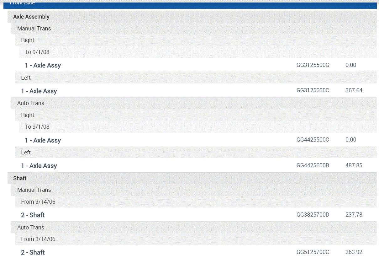

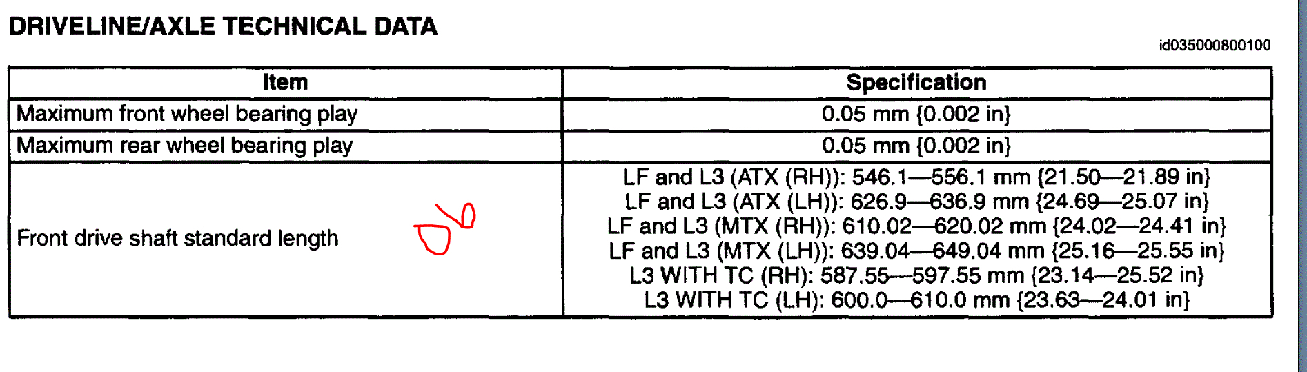

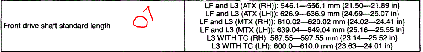

The first two pics below show the specs for axle length. Pic 1 is the 2007 and pic 2 is the 2006. They are exactly the same, and they seem different from what you have. The third pic shows the manufacturer's part numbers. See if you can match any of them with what you received.

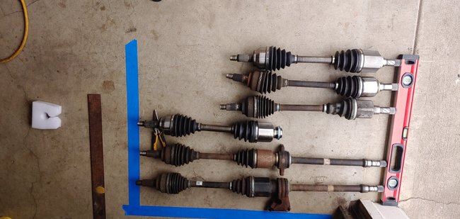

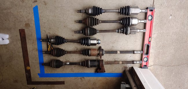

Here's what I have,the 2006 passenger with intermediate shaft. And 2007 right below it.
May 1, 2020 at 5:55 AM
BRYCE CLINE
  • 32 POSTS
Here's the 3 sets and there all different, it's that kinda stuff that makes ya shake your head.

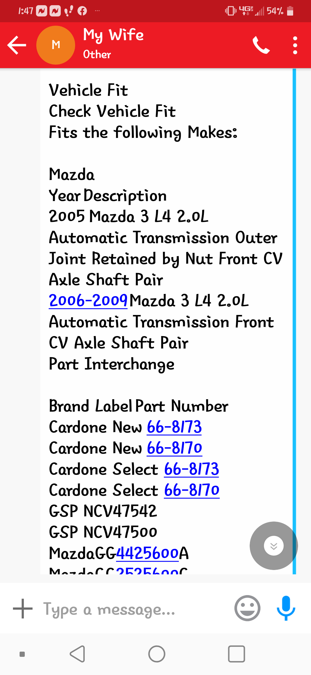

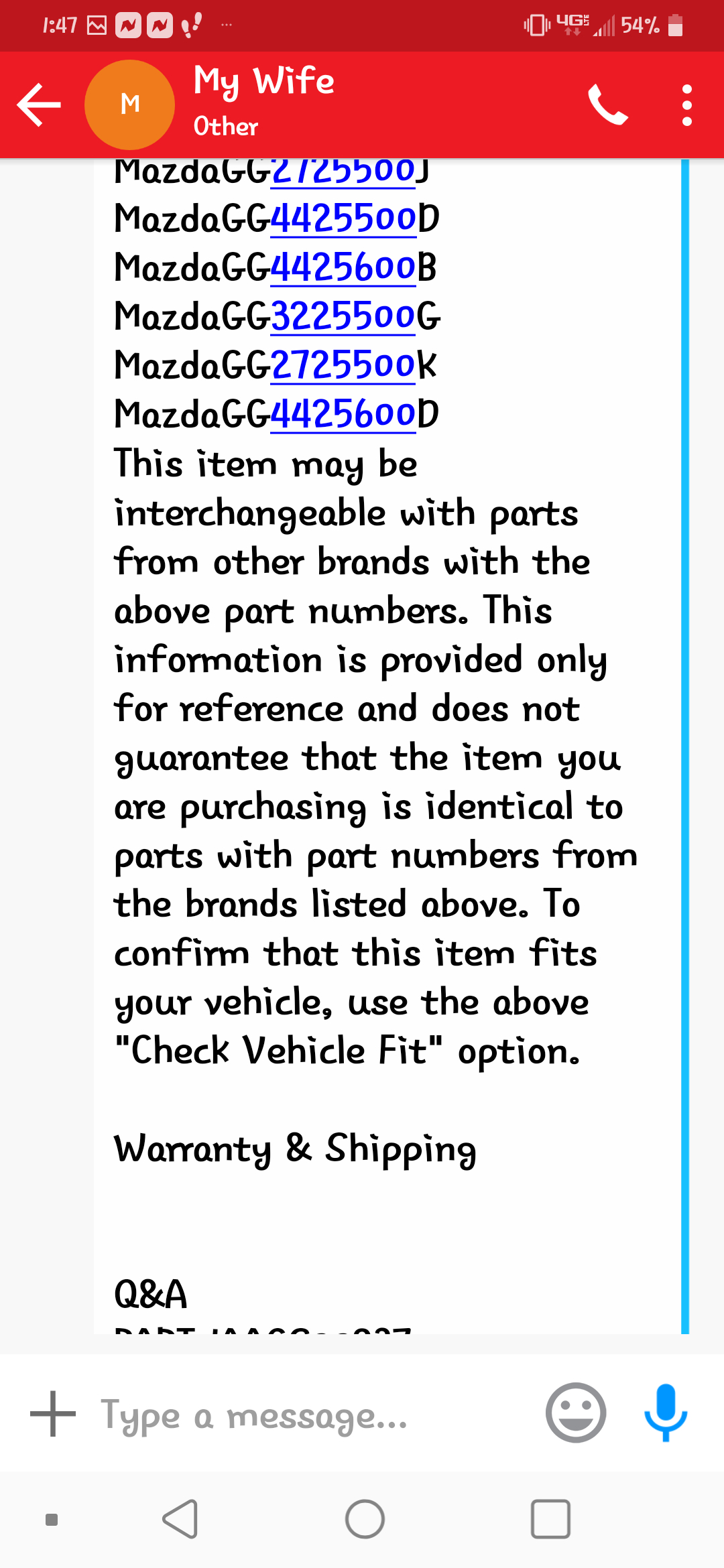

These are the manufacturers part numbers and that my part is guaranteed for lol. We ordered them from 1A Auto , first time i have used them.

Honestly, nothing is ever easy. What I would do is call them, provide them with the OEM part number, and see if they can cross reference it to their part numbers. Note that the numbers I listed indicate left/right auto transmission/manual transmission.
Let me know what they say.
