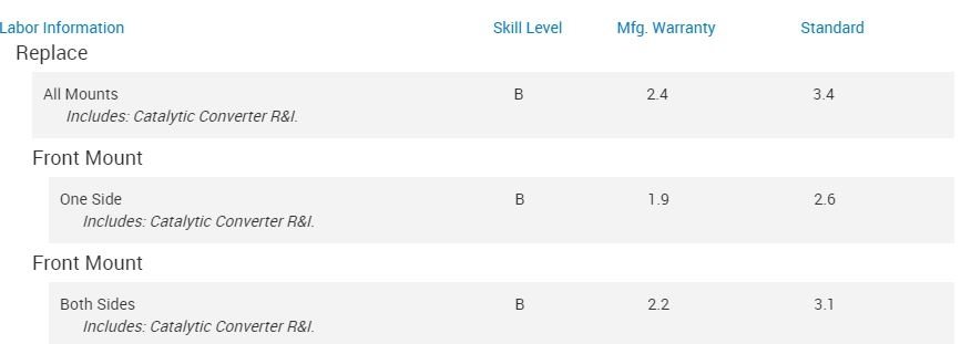

Hi, a few weeks ago I got a check engine light warning. Mercedes took the car and replaced the EGR valve. The car suddenly began to vibrate and be rough. Anyway the car came back doing exactly the same thing. I also noticed that the car runs smooth when in reverse or in neutral. Only when in drive do the vibrations start. Now the dealership is telling me I have to have the engine and transmission mounts replaced and it was just a coincidence. Sorry, but I do not believe it. So I am contacting someone else that might be able to advise me. Thanks very much.

The idea that you feel a vibration in drive only could be a bad motor mount. However, since you do not feel it in neutral or reverse indicates they are not all bad.
When you put the engine in drive, the engine will torque to one side. When you put it in reverse, it will torque to the opposite side. With that in mind, I feel there may be one mount that is bad.

With that in mind, replacing all of them is a way to eliminate the chance of missing the bad one. However, I do not feel they all need replaced.

Thanks Joe, I appreciate the advise. Would it make any sense to have both engine mounts replaced but not the transmission mount? Or should I just have it all done while the engine is out anyway? An engine mount(s) was replace probably eight years ago.

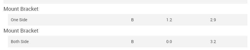

That is a good question. I would have them inspected and if wear is seen, then replace. However, I was taught a long time ago if it is not broken, do not fix it. LOL However, if the price for replacing all does not add too much to labor and you can afford it, it may be a good idea.
By the way, the engine does not need removed. It will need supported, but not removed.
I attached all the labor hours required for the job based on if you replace one, both. Figured you could confirm they are not over charging you on labor. Also, if you want the cost for original equipment parts, let me know. Also, if it is all wheel drive, I will need to know that, too.
