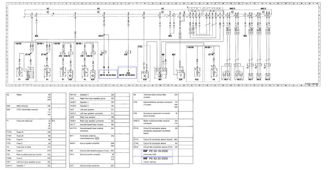

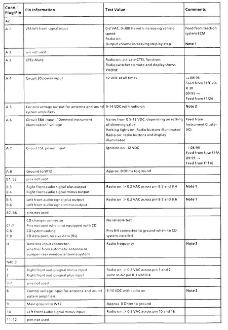

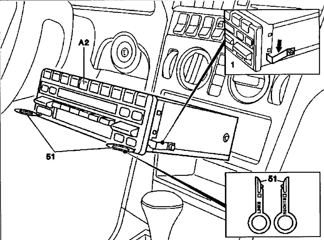

I need to get to wiring for the radio.
Sep 18, 2018 at 7:17 AM
STEVE W.
  • 15,295 POSTS

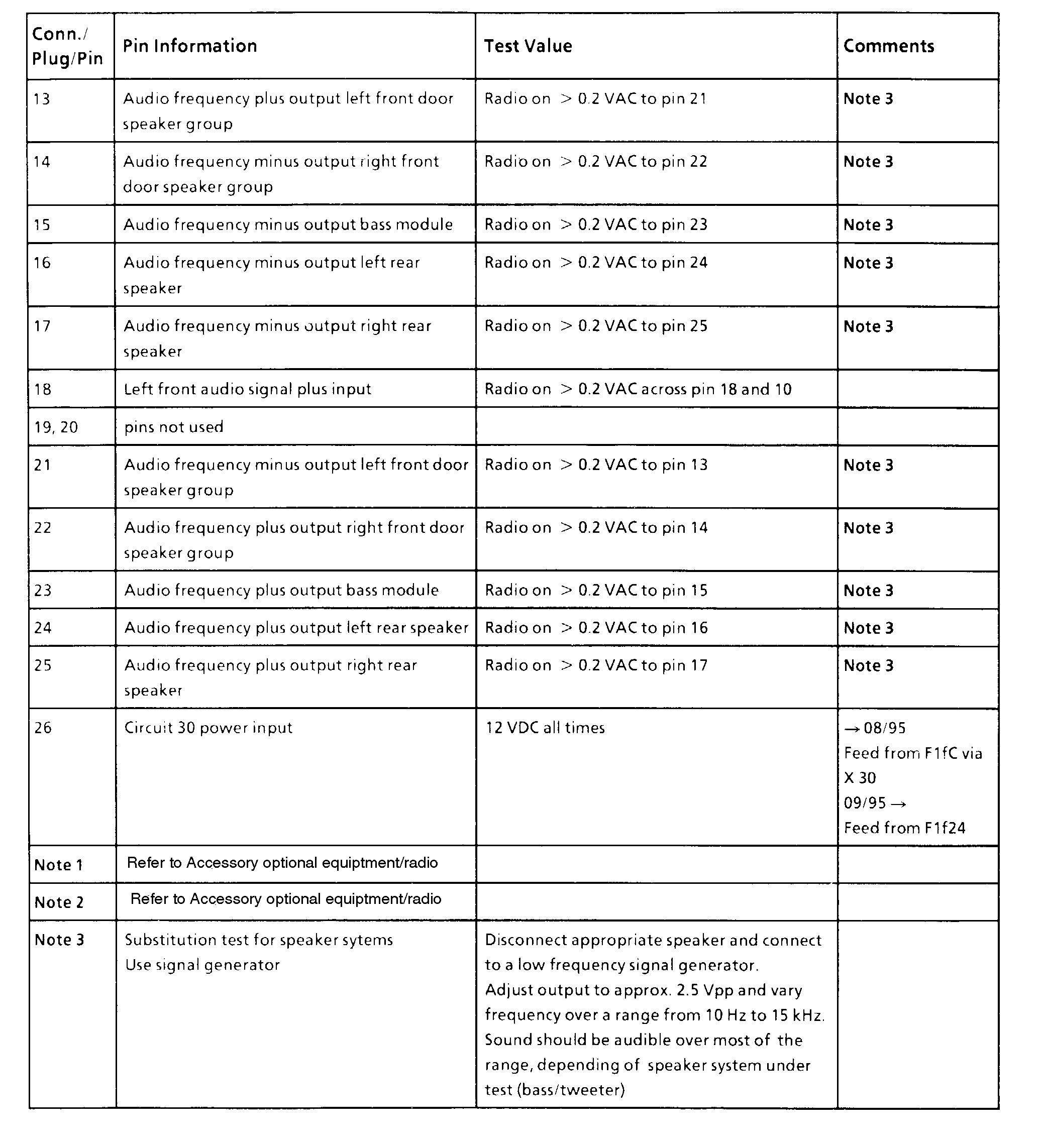

If it has the factory unit the radio itself gets pulled out using the radio keys that are inserted into the slots on the lower edge of the unit. Nothing to remove to do that. The second diagram is the stereo wiring. The last two are what the various connection pins do with the factory system.
