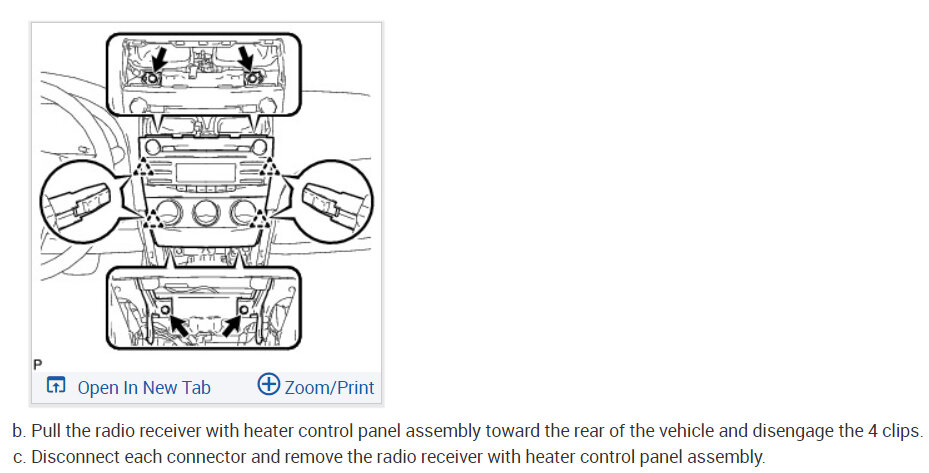

My problem started out as my music would cut in and out if I went over bumps and was listening to my phone with an AUX chord. Now my car wont play any music other than the radio. The AUX port on my car for some reason doesn't register I have anything plugged in, so I can never listen to music on my phone. Now my CD player isn't working either, and it tells me there's a CD in it, when there isn't, and won't accept a CD. Is there anything that I can do? Or do I need to take it to my dealership?
Feb 23, 2015 at 12:28 AM
HMAC300
  • 48,601 POSTS

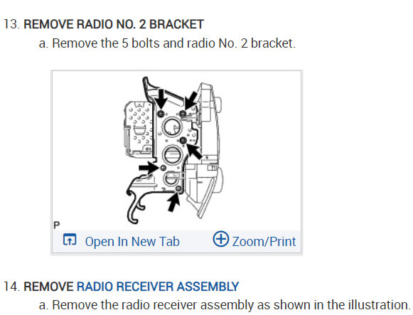

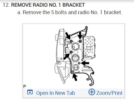

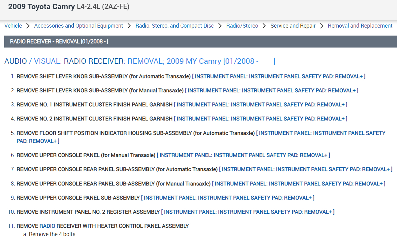

Yep, you have a CD that is stuck in the player so the radio is stuck in-between, you will need to remove the radio to take the cover off to help get the CD out. Check out the images (below). Please upload pictures or videos in your response of the problem so we can see what's going on.
