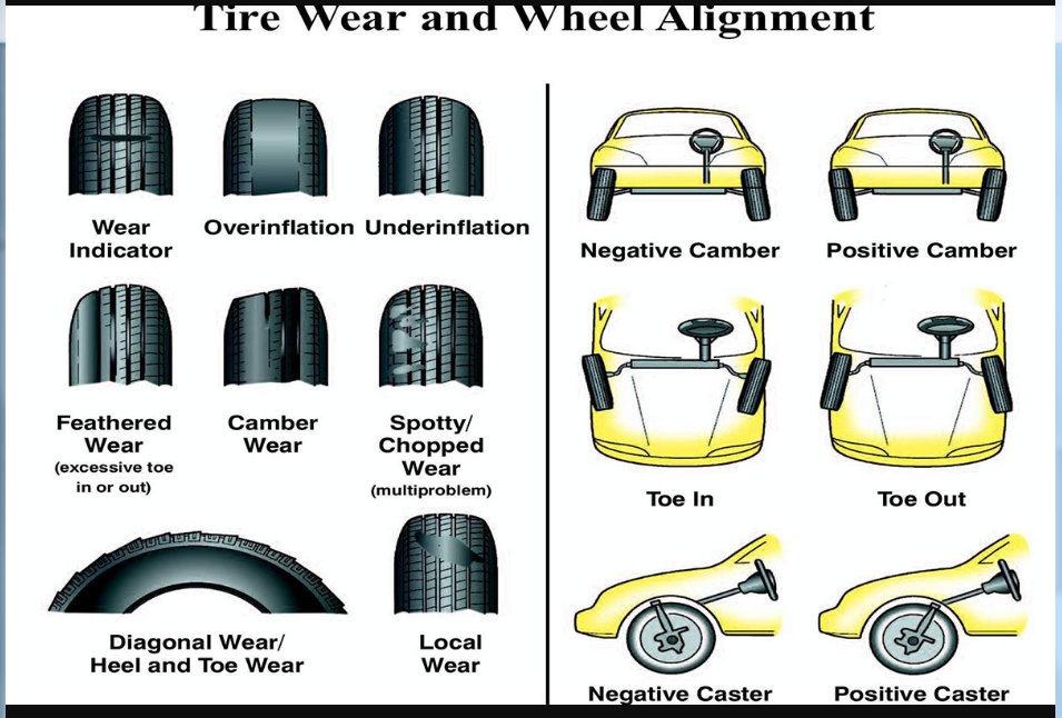

Below is a chart that shows different types of tire wear and causes.
Let us know what questions you have. Thanks
