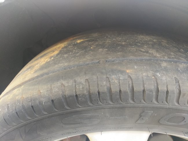

This past Tuesday i hit a pothole. My car began to make a weird whistling or whining kind of noise. I immediately pulled over because it sounded as if i had a flat tire. That not being the case, and my steering wheel crooked more so turned to the right kind of position and pulls to one side. I was wondering if you could assist me with this issue as to corporate? I rolled windows down and it appeared to be on my front right side tire. Like a windy type noise.

A few questions. Does it seem to wobble or bump? Does the noise change when you go around a bend? Does the pitch change with the speed of the car? To me, a flat tire sounds more like a humming/roaring sound than a whine/whistle sound.
If it is wobbling or bumping, you likely need a new tire over there. A steel belt inside the tire (under the tread) has broken and the tire has developed a bump in it.
If the noise changes as you go around bends and changes with speed, and sounds more like a roaring/humming sound, then you probably need a wheel bearing -or- hub assembly. Generally, when I have a bad wheel bearing, I change the whole hub assembly. Because to me fixing a part with 187,000 miles on it to save maybe $40.00 just does not make sense.

Hey thanks for insight! Well the car does not have a flat tire. I checked to see if there were any visible bumps, or lumps i did not see any. The car makes the noise if you go over a bump or something. And it gets louder to me when you increase the speed. But it makes a noise when your going around a corner as well making it hard to distinguish the two. But i do not have any photos at the moment due to it being dark outside. I will do a follow up as i check a few things, such as the videos you posted.

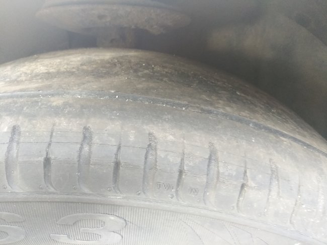

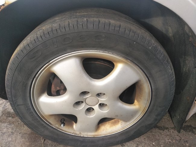

WILLIE26
  • 26 POSTS
Hello, i actually went outside today and had not checked all the tires yesterday! And clear as day i think i may have found the corporate. But not quite understanding as to why the tire would do this! Will post what pictures and video in second.

Yeah the tread is low on that tire, which made it a little weak. When you hit the bump, it appears that was enough force to break one of the aforementioned steel belts, which made your car ride badly. To confirm, put the spare on and take it for a ride.

WILLIE26
  • 26 POSTS
Hello, left a tire shop i actually saw that my lower control arm is loose. Which is causing this loud noise and uneven wear in my tires.
