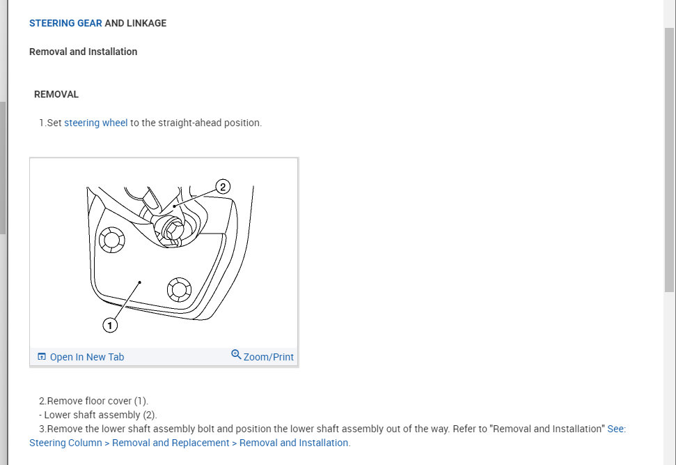

I hit a curb and my tire blew out completely and bent the rim. Changed the tire to a dummy one and it looks like it's going inwards, and my wheel is cocked to the left. When I hit a bump, it wobbles from side to side moderately hard. Not too hard, but enough for me to notice and have to grip the wheel hard. It has a tire light on, and my traction control light is on.
Dec 19, 2021 at 5:48 AM

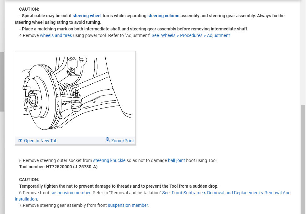

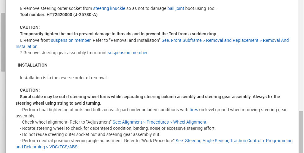

More than likely this is a tie rod issue or other control arm issue, but I would not drive this vehicle until this is repaired.
https://www.2carpros.com/articles/tie-rod-end-replacement
If this is a tie rod, then that can break and cause you to lose the ability to steer the vehicle.
Are you able to get a couple pictures of the steering system and the wheel area under the car and we can try and identify the parts that need to be replaced?
I am attaching the process below if the steering rack is damaged as this is possible as well. However, let's get a picture and we can go from there. Thanks
