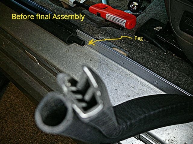

Start at the bottom center with the end that has the PEG, Make it follow the bends tightly. A rubber mallot might have helped here. The center pillar area is a little tight because of clips. The trim removal tools helped here as well on the install.

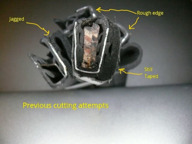

That's when I discovered, I had a problem. How do you cut this stuff cleanly? Well, I had a lot of the old piece to practice on, So, it was basically a discovery process with a carbide blade on a circular saw, an oscillating tool, a reciprocating saw ( a friend/neighbor tried his) and a fancy jig saw. It has blade wiggle. Usually, I would use it to cut aluminum sheet, but it was not appropriate for this.
It was time to evaluate the data and come up with a plan. It was better to cut into the open “U”. It was much better to “secure” the rubber section so it didn't flop. I could sand the end with 80 grit sandpaper with a finishing sander, I could “fire-polish” the rubber. I've done fire polishing of pyrex and quartz and acrylic and polycarbonate at work. Never did rubber.

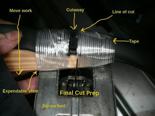

The best cut I'm going to get on the rubber is with a single-edge razer blade. Eventually, I figured out that I needed to fill the “U-channel” and some wood shims that might be used to install a window in a house stared me in the face. They are a shallow wooden wedge. You want about 4-5” of material on the other side of the cut for gripping and clearance.

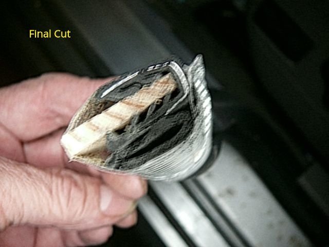

So, you mark. Insert the shim to fill the “U-channel”, Cut cleanly with a razer blade on that mark. Now remove about a 1/2” section of rubber away from the nice cut. Now you want to flatten out both sides, so I wrapped packing tape (the one with the strings in in) to fold down the rubber on both sides of the 1/2” wide cut with the shim in place too. One tape edge defines the good edge. The other edge just gives you something more solid and flat.
The sacrificial shim size should probably be about 3/16” x 5” x 3/4” W. The 3/16” is the estimate of what would fit in the channel comfortably. The 5” is the width of the jigsaw plus some finger-safe room. 3-5” is probably OK. ¾” is the minimum width. I used almost 2”.
The jigsaw needs to see something that appears to be solid.
I was actually doing this when it was dark. A post light was on and a flashlight was in my mouth and I was very successful.
The aluminum thickness of the channel is ~0.040”. That's what you need to cut with the jigsaw blade and you need a throw of about ¾ of an inch.
You need a blade designed to cut thin aluminum with wiggle set to zero on the saw. You need lube on the weatherstripping or you need to make a nice smooth surface on the saw.
To make a nice and slippery non-marring saw surface, cover it with large, thin double stick tape, but don;t remove the backing. The backing is your slippery surface.
With the saw between my legs and upside down, I could hold the weatherstripping and draw it across the blade while having a Mini-Maglite flashlight in my mouth. You want the blade to initially hit the open side of the “U-channel”. Your cutting into the wood shim too.

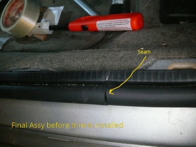

Remember, you need about a 4 inch overlap, before you do your final cut. You don't want too much excess when making the final cut.
You can touch things up with 80 grit sandpaper on a finishing sander. Remove the tape and fire-polish the edges. I used one of those butane BBQ lighter sticks, Remember to practice on a piece of scrap something first.
Insert the PEG into the cut portion of the weatherstrip and put in place and then put the bottom molding back on and your good to go.
