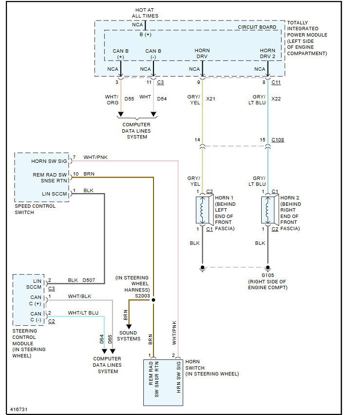

TIPM Horn wiring diagram needed?
2013 DODGE AVENGER
130,000 MILES • 3.6L • V6 • 2WD • AUTOMATIC
SINNAKERRI
Hi, there! I'm having an issue with my TIPM where the horn is randomly sounding. I've already narrowed it down to being the TIPM. I have pulled the TIPM and looked at all connections inside and outside, all seem to be fine. I'd love it if I could get a wiring diagram to know which wires affect the horn to narrow down exactly where I should be looking for damaged wires/connections.

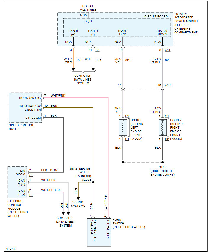

It sounds like the TIPM is bad, here are the wiring diagrams for the horn and TIPM as requested. Check out the images (below). Please let us know what happens.
