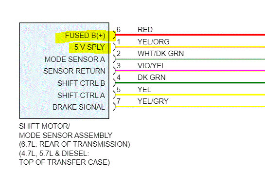

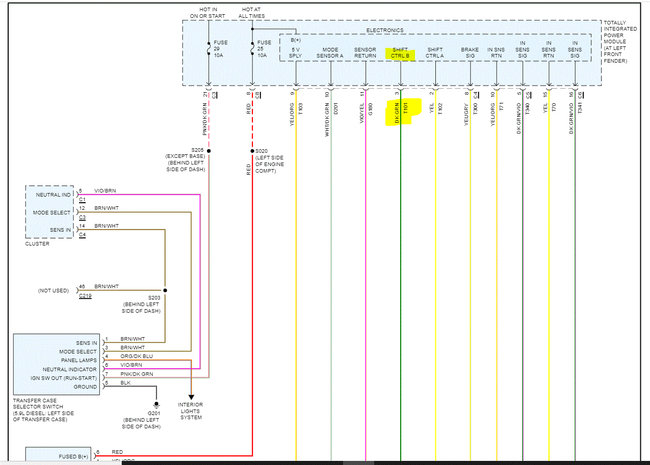

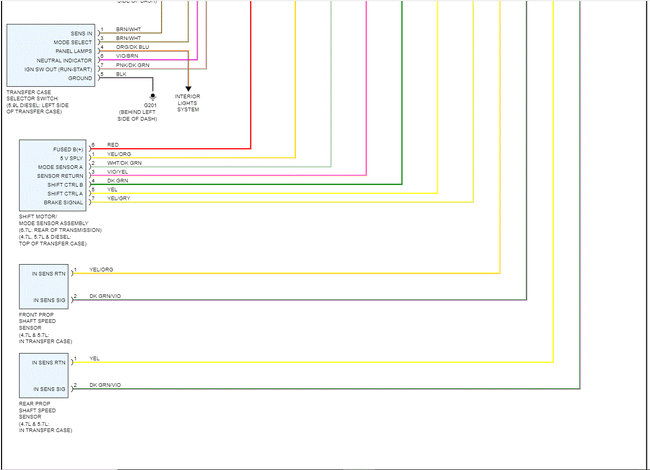

I attached the schematic below. Connector C T101 is shift control B. Note that the same fuse powers the t101 and t103.

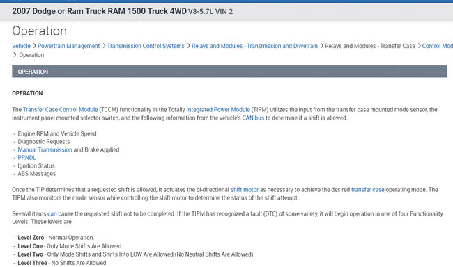

Go to the actuator motor and locate the yellow wire with an orange tracer. Does it receive a 5v reference from the TIPM? Does the red wire at the motor receive 12v? See pic 3.

Hi, I have 12V at the red wire and I have 5V reference voltage at the TIPM. I have no voltage at green and yellow during 4WD command or 2WD command. I am using a power probe test light at the terminals at TIPM.

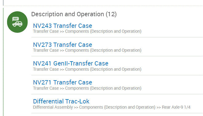

Some have power at all times and then are signaled to provide a ground path.
Do me a favor. Take a look at the list below and let me know which one you have.

It's a 273 has 7 wires to the actuator.

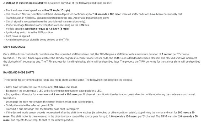

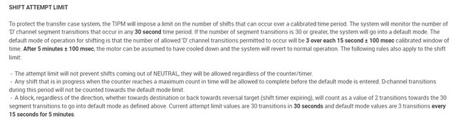

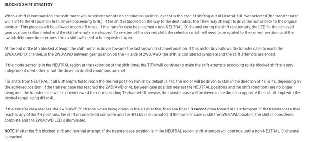

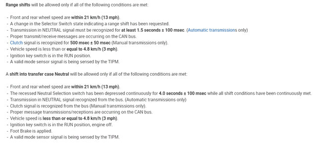

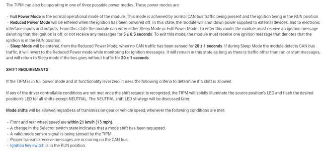

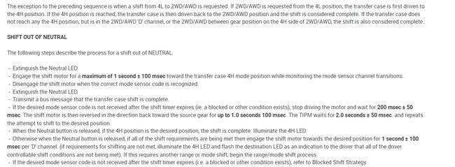

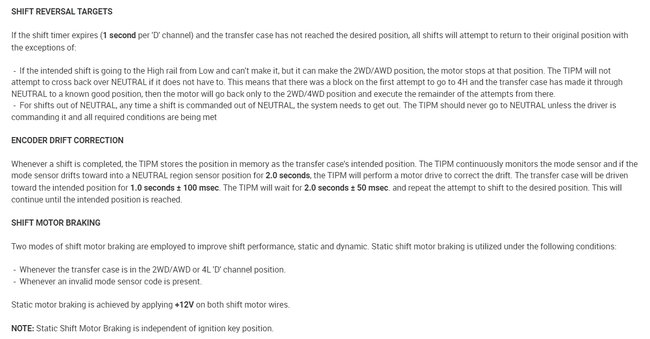

If you aren't getting power to the yellow and green at the shift mode sensor, I suspect the TIPM is bad. However, do me a favor. Take a look through the operation description specific to this transfer case. Let me know your thoughts.

Hi Joe F, thank you so much for this information! I'm just getting back to this truck and trying to figure out where and how to test for sensor signal from the actuator. I never have any dash lighting up showing 4WD only the Service 4wd . If I can verify that a proper signal from the actuator is getting to the TIPM. D201 and or G180, I can rule out a fault with the actuator. I have a feeling the TIPM is shot but I have not collected enough evidence to pull the trigger, expensive.
