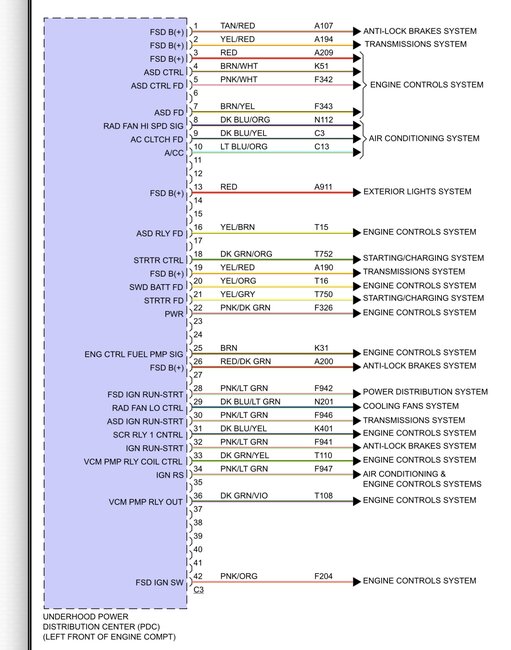

I need the pinout for the long black connector C3. Engine code G. Someone installed a tracker, the owner of the vehicle cut it out, started to rewire the connector themselves and took all the small piece out of the cavities all at once rather than one at a time. In other words, it was brought to me with just the black plug and a bunch of loose wires so I need to know which color wire goes in which cavity. I’ve gotten a lot of conflicting information from the internet, all of which has left me with extra wires that aren’t in a cavity and a vehicle that won’t start…

I finally found what I was looking for on ProDemand! Figured I would share in case someone else needs the information in the future…..

I use AllData too. Here's the rest of the information for C3. This removes the guesswork for which terminal is which number.

621GARAGE
Awesome! Thank you so much!
It’s a great program but can be difficult to navigate at times.
