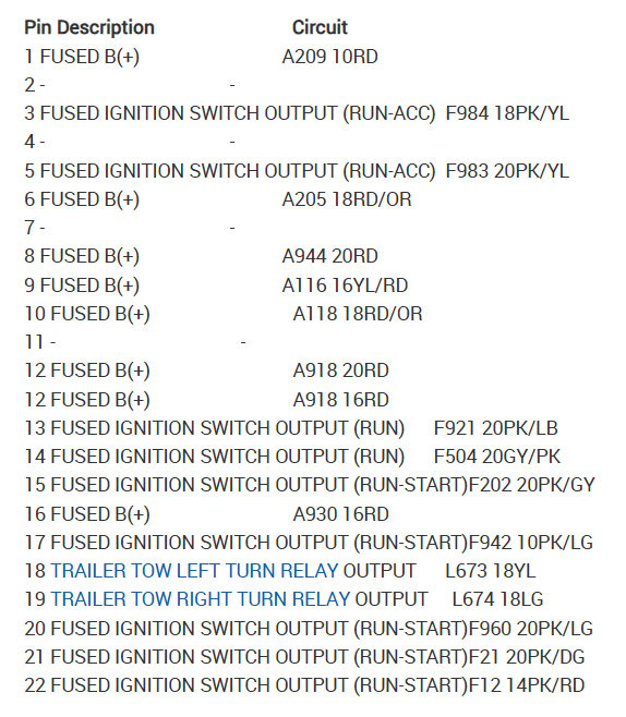

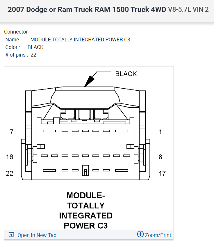

Tipm pinout?
2007 DODGE RAM
315,000 MILES • 5.7L • V8 • 4WD • AUTOMATIC
ROBERT QUEEN
Seems to be a bad connection on the top black c3 connector. You can wiggle the wires and truck will start, runs for a few seconds to a few minutes then shuts off with a no crank no start until you get the wires right again.

To me it sounds like the TIPM is going out which is common. Here are the C# pinouts as requested. Check out the images (below). Please let us know what happens.
