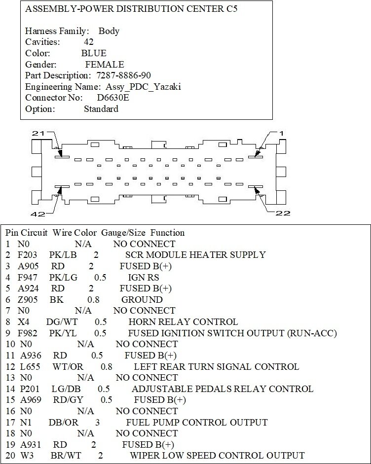

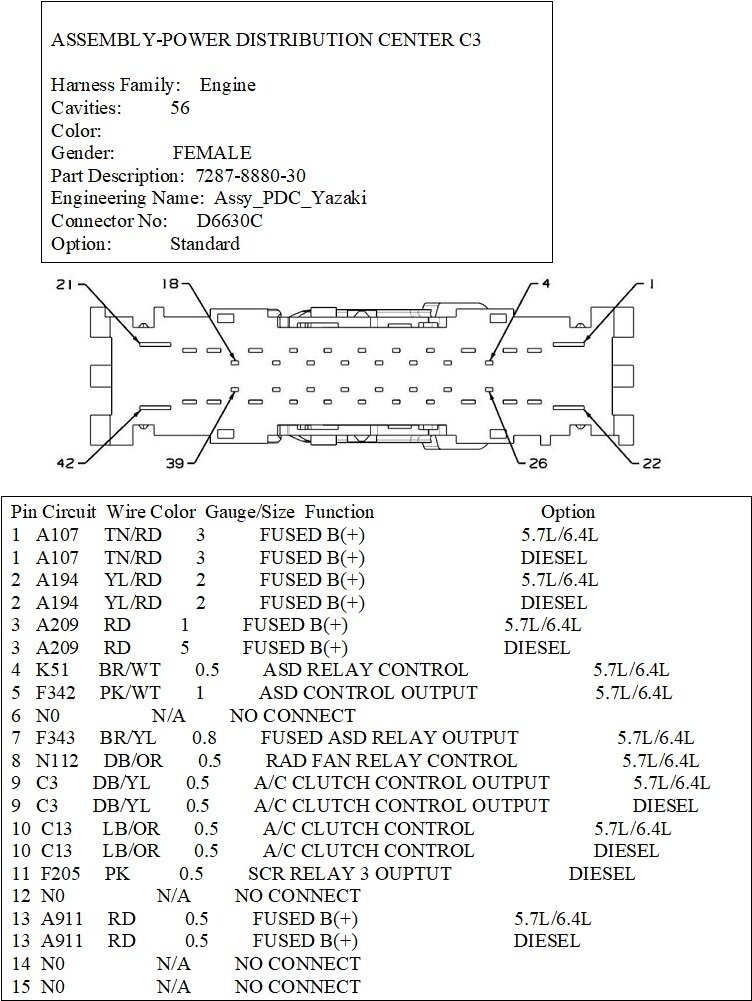

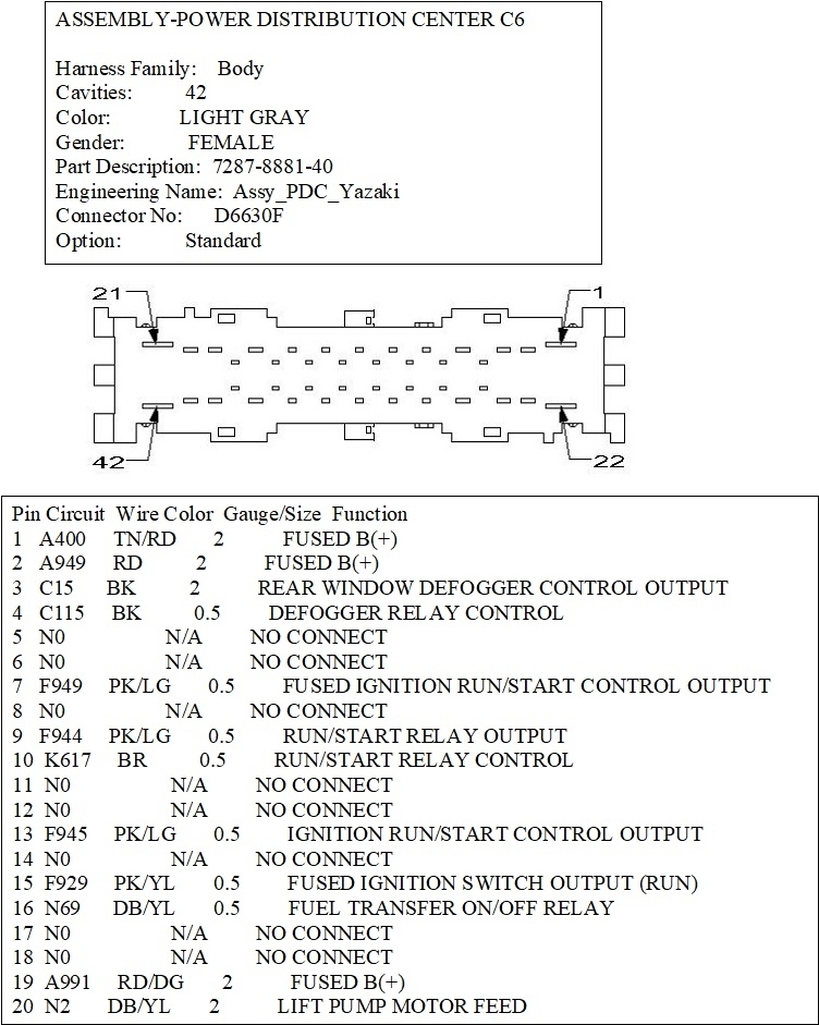

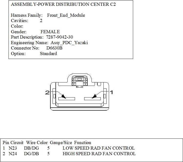

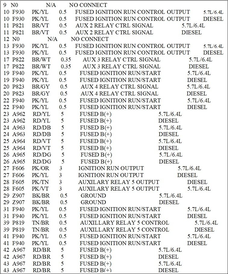

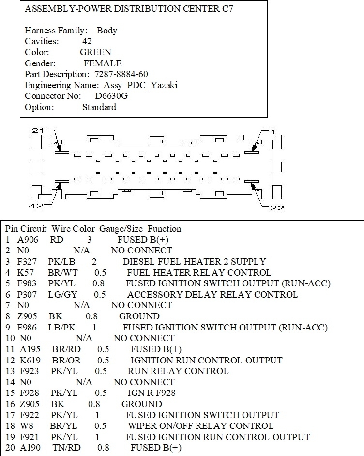

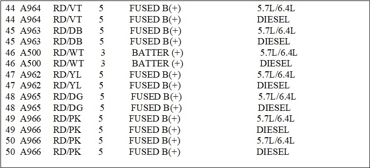

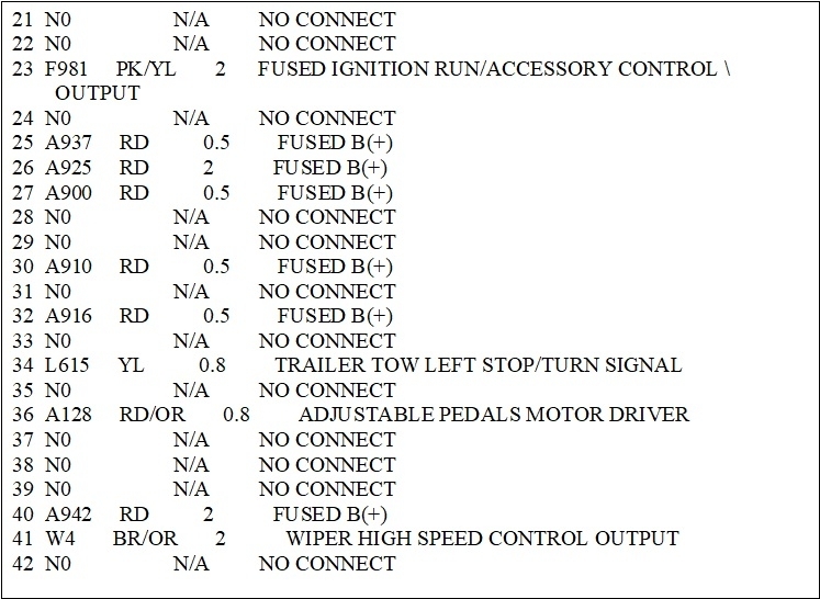

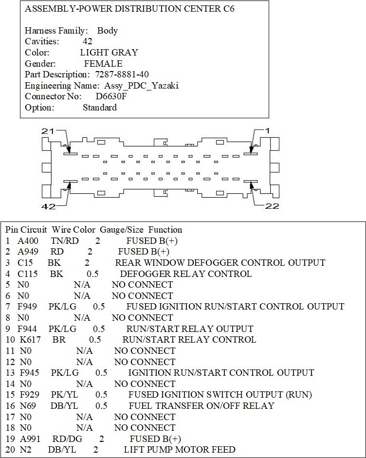

Looking for a pinout diagram for c3,c5,c6, c7

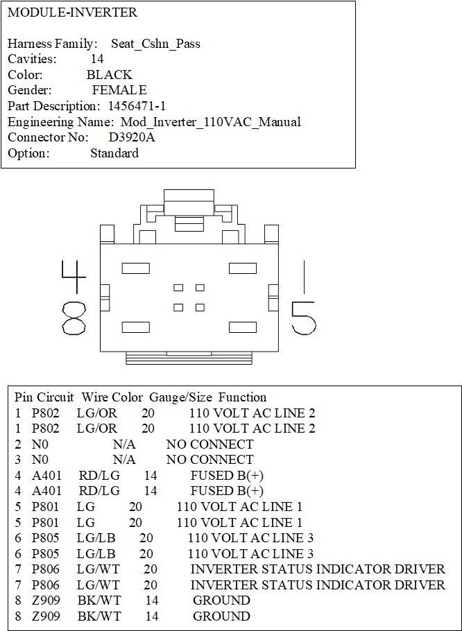

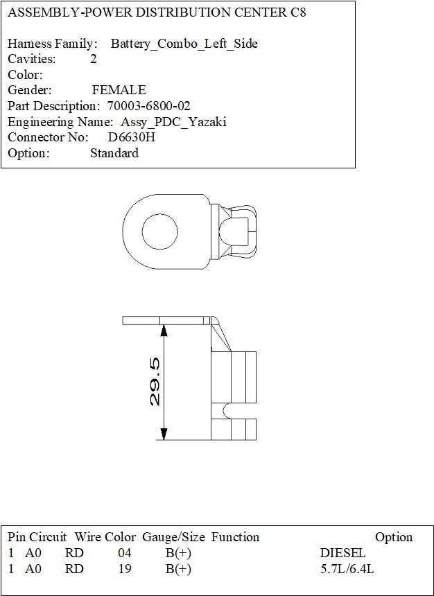

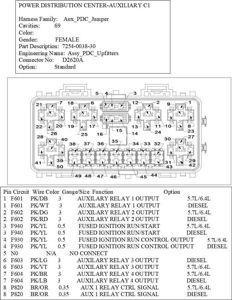

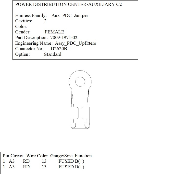

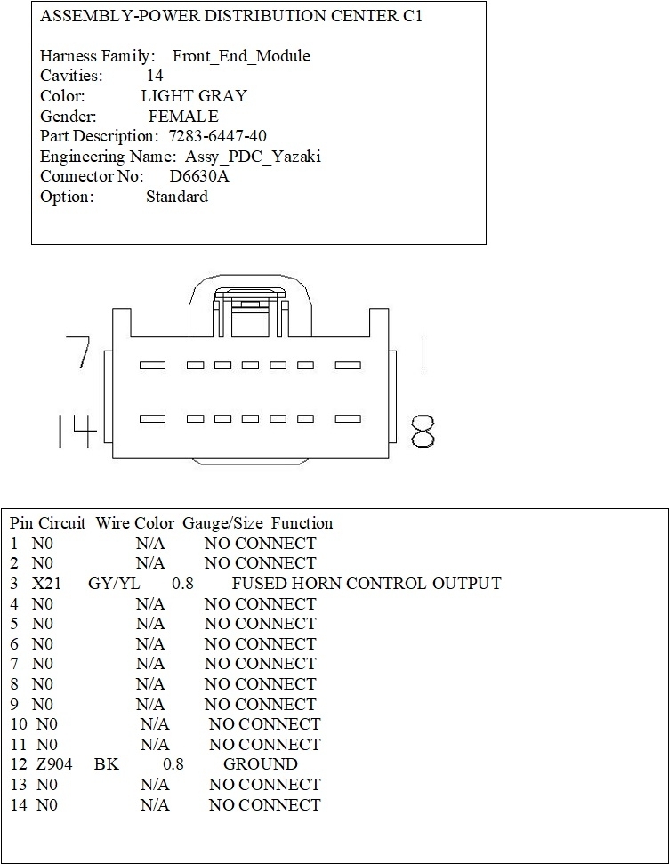

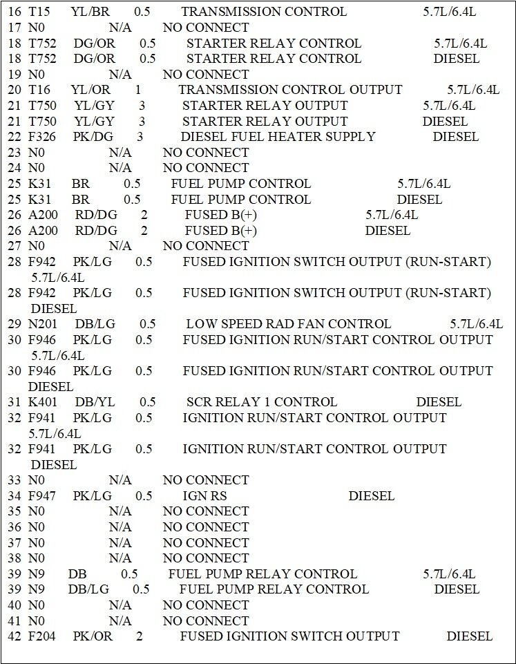

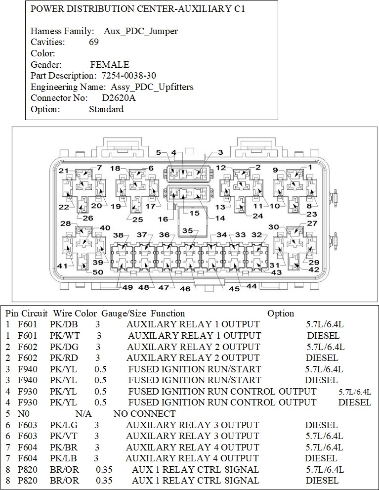

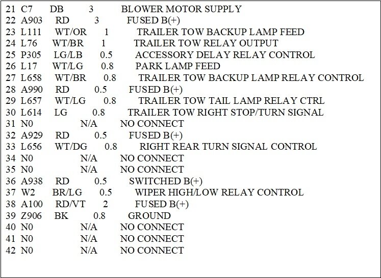

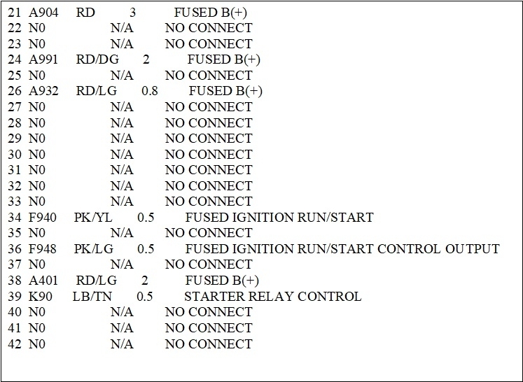

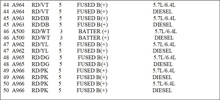

Here's all the connectors related to the TIPM. A few are two images for one connector because the list of wires was so long. You'll find the connector numbers on the top line of the descriptions.
