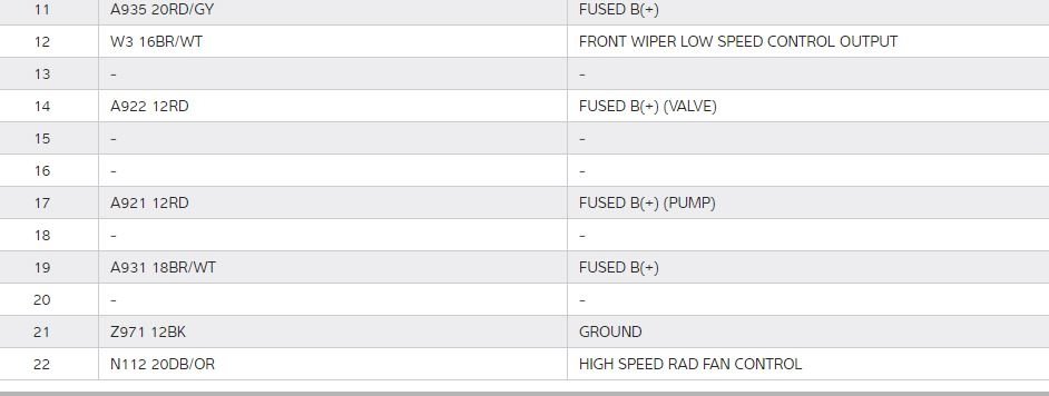

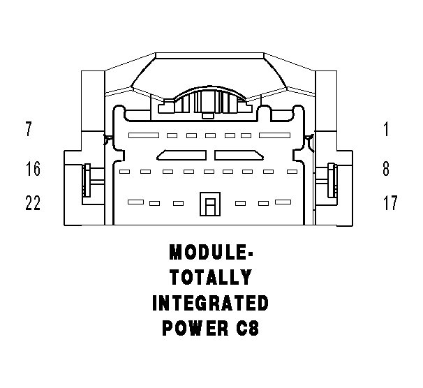

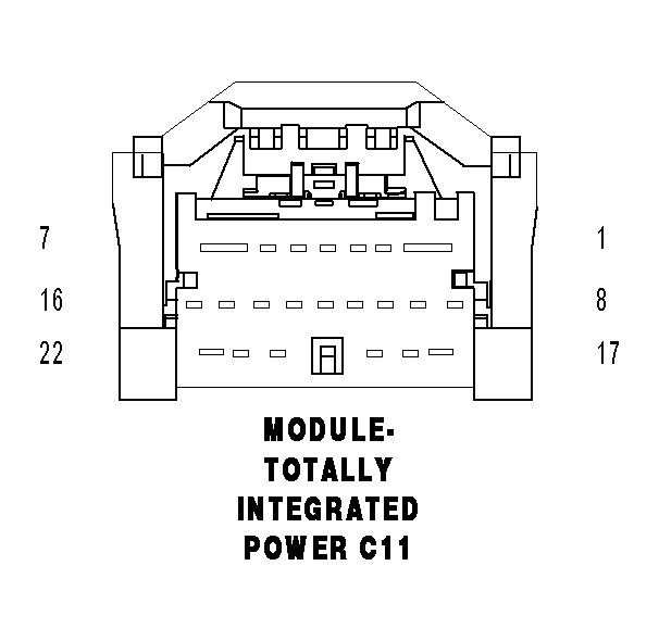

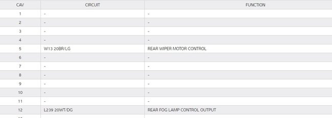

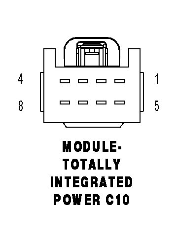

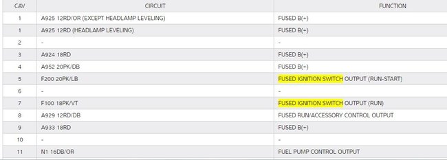

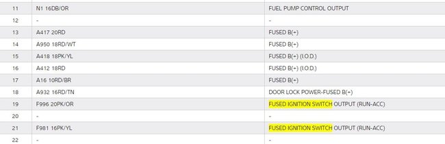

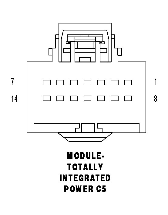

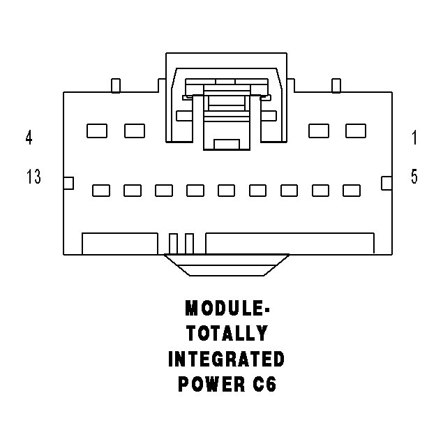

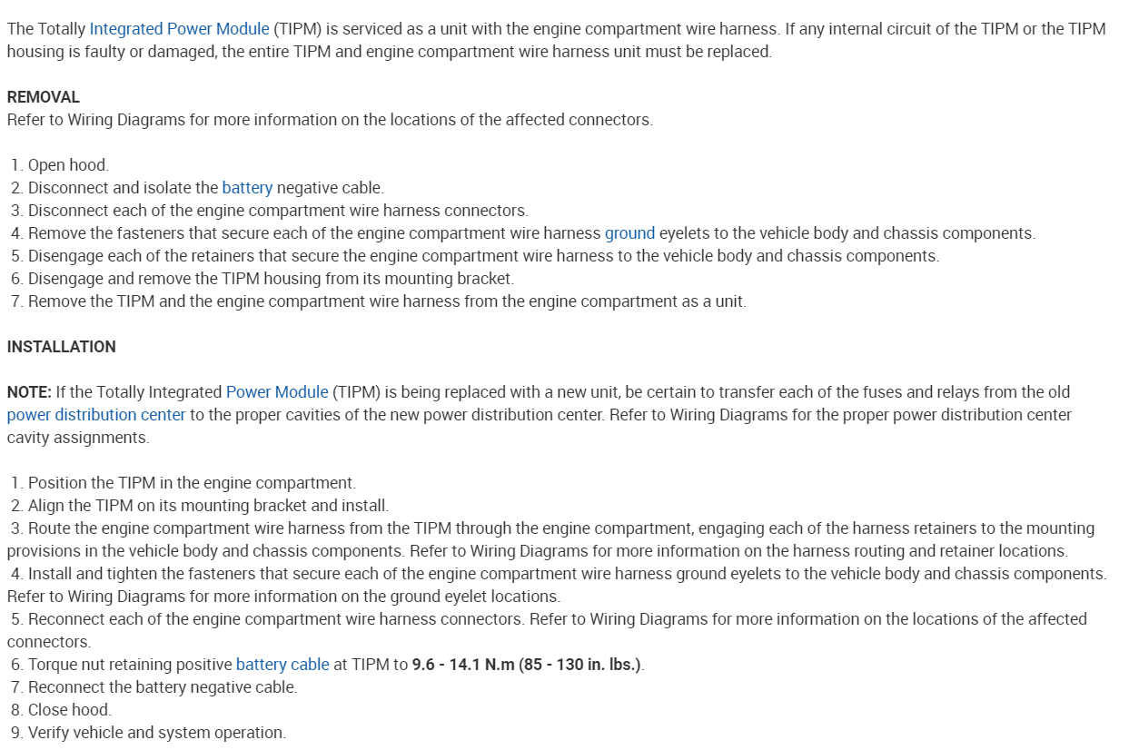

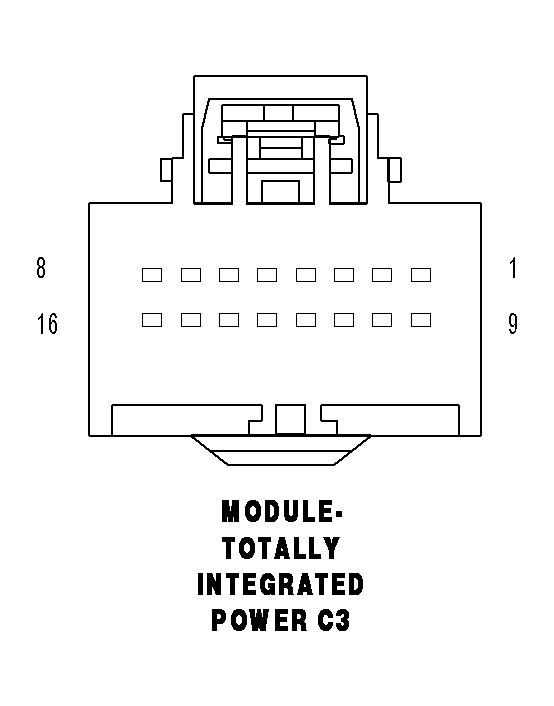

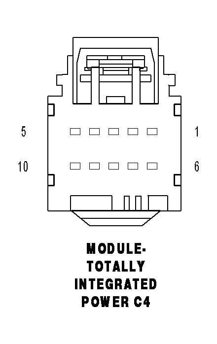

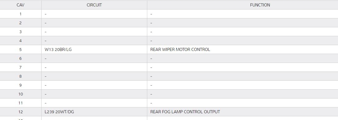

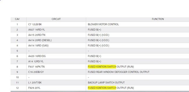

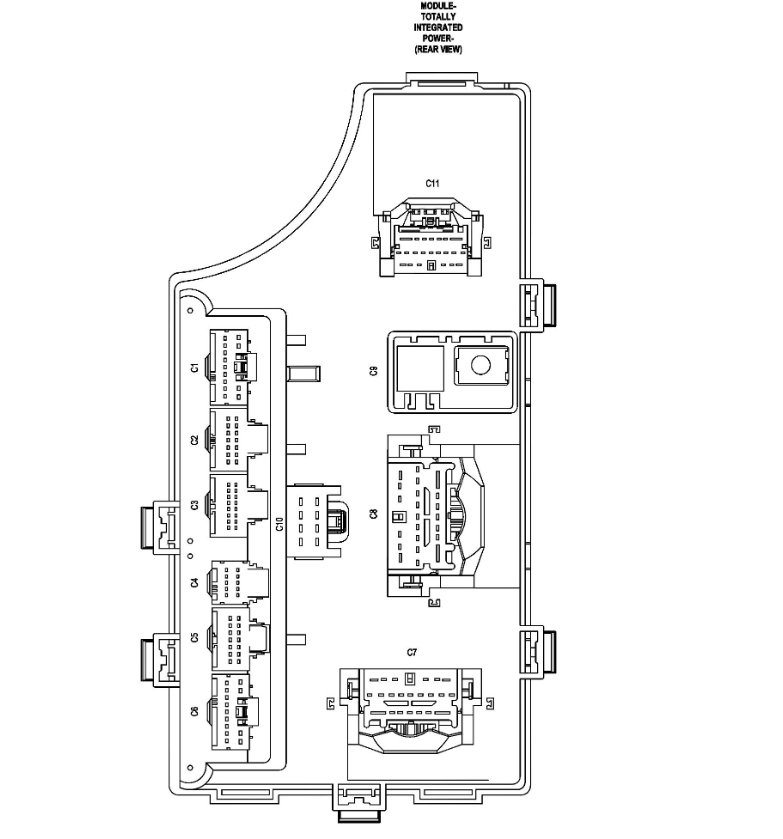

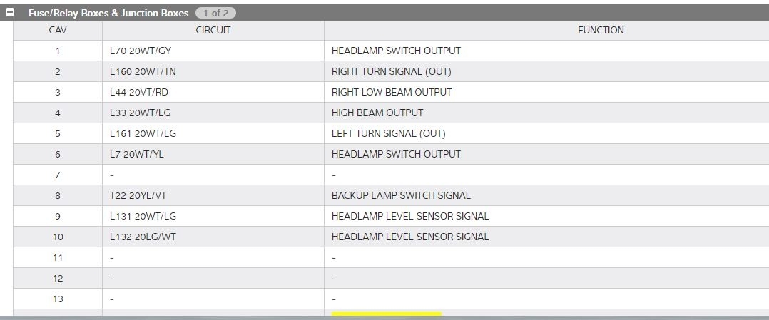

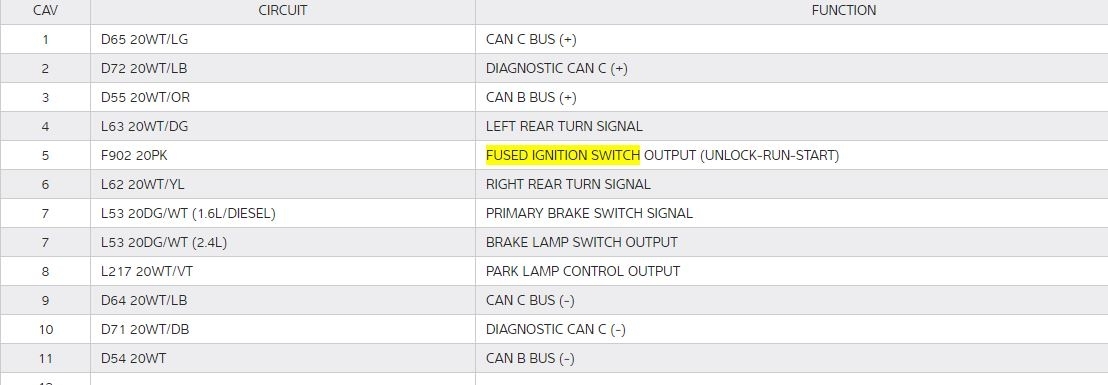

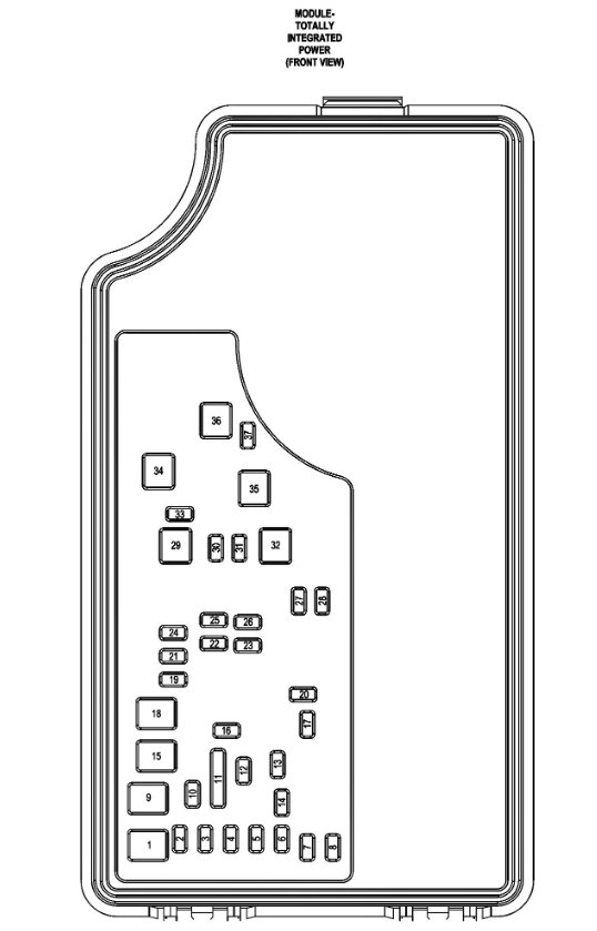

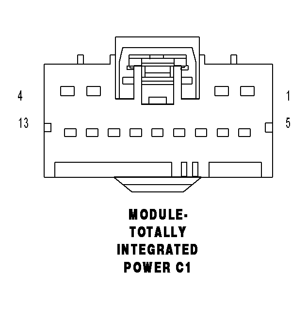

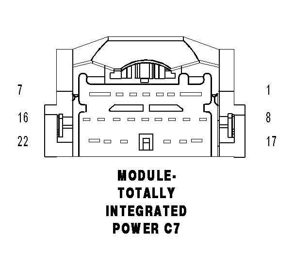

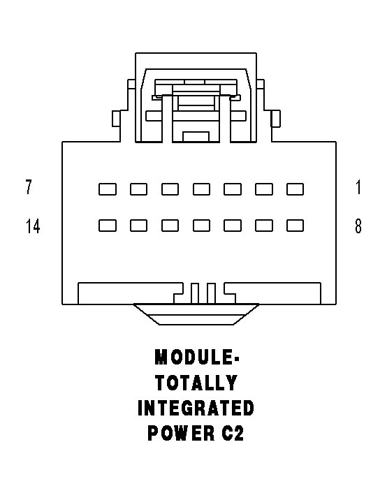

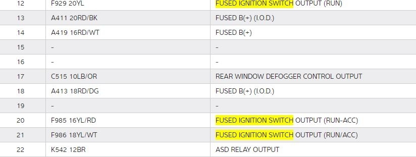

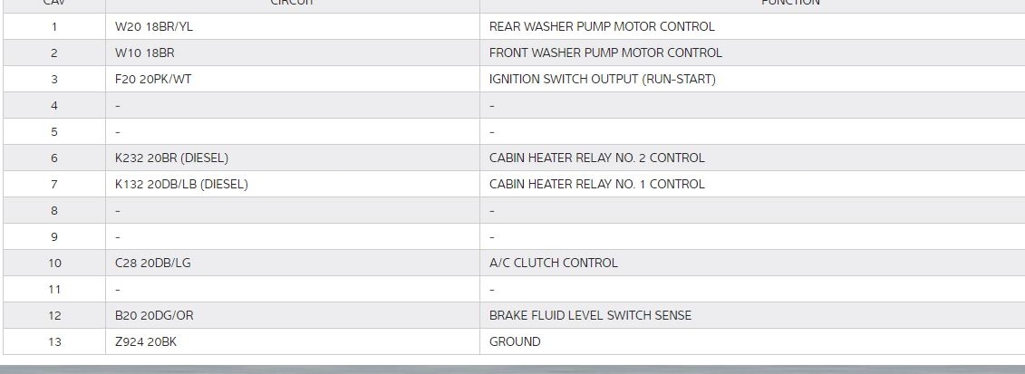

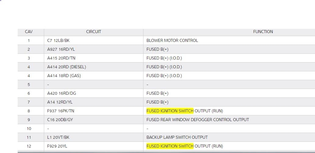

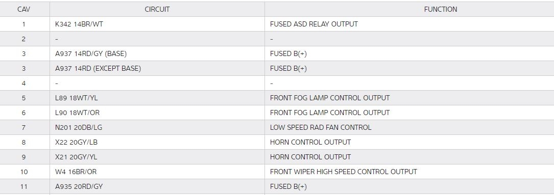

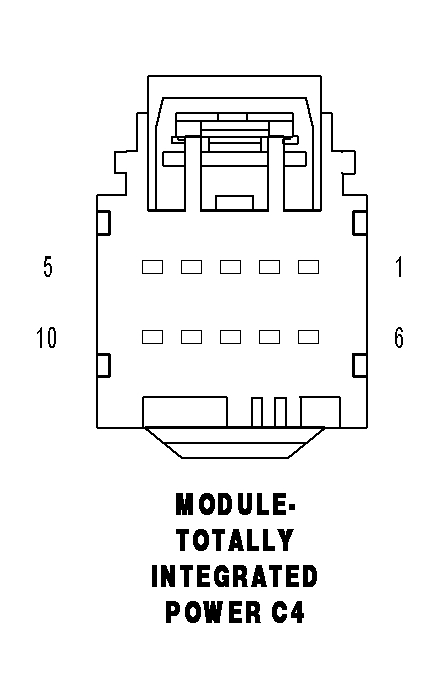

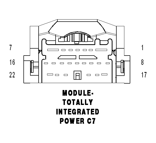

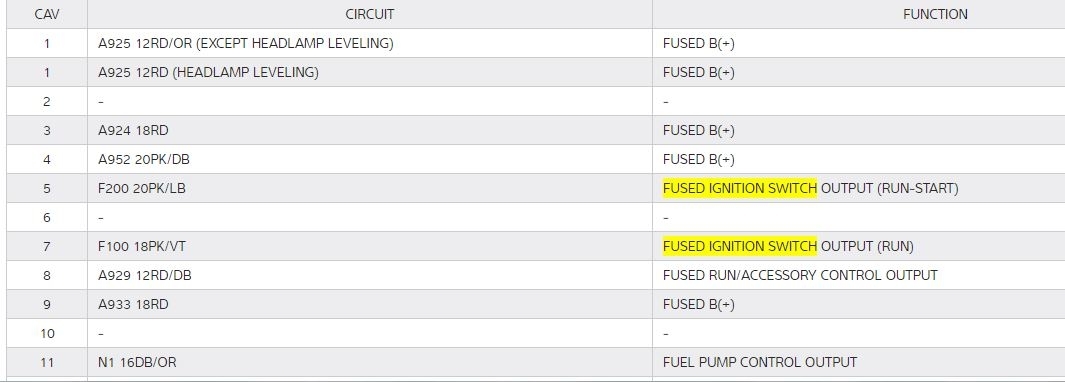

Can I get the pinout for the TIPM I need to replace it.?
Jul 10, 2018 at 12:51 PM
  • 110,246 POSTS

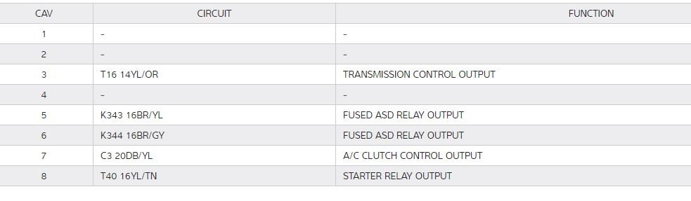

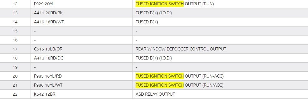

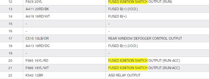

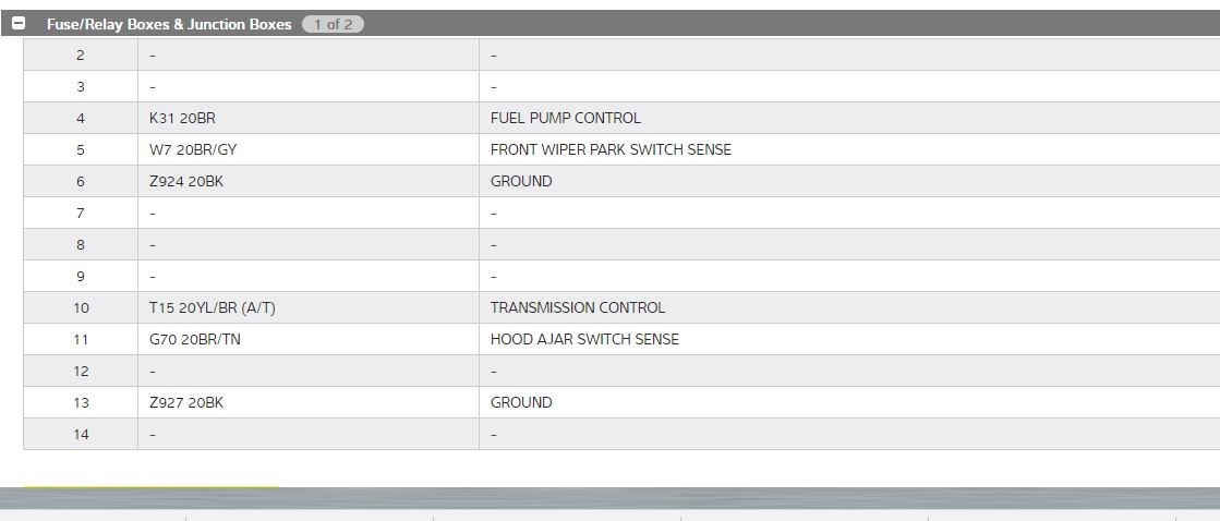

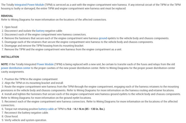

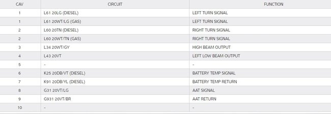

I have attached every pin for the unit. Not sure exactly which you needed. I have attached a picture of the plug, and then what each pin is for. In most cases, there is a picture followed by a list of what each does. There are a few which will have two pictures of what each thing does because the list was too long to fit onto one picture.
I hope this helps. There are a lot of pictures. Gotta love them TIPM's they are easy to replace just plug and play! Check out the diagrams (Below). Please let us know if you need anything else to get the problem fixed.
Jul 10, 2018 at 1:44 PM
  • 110,246 POSTS

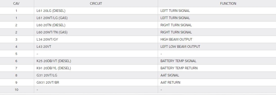

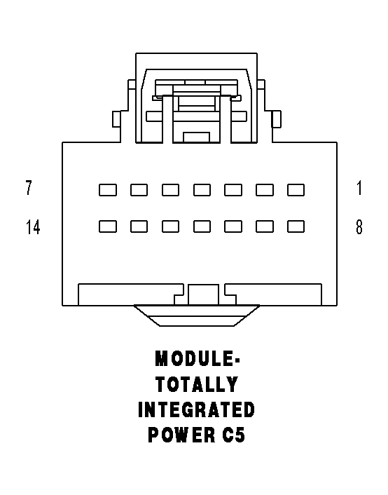

I am not sure what just happened, but I was not done uploading. Here are the remaining pictures.
